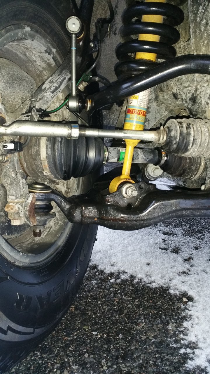

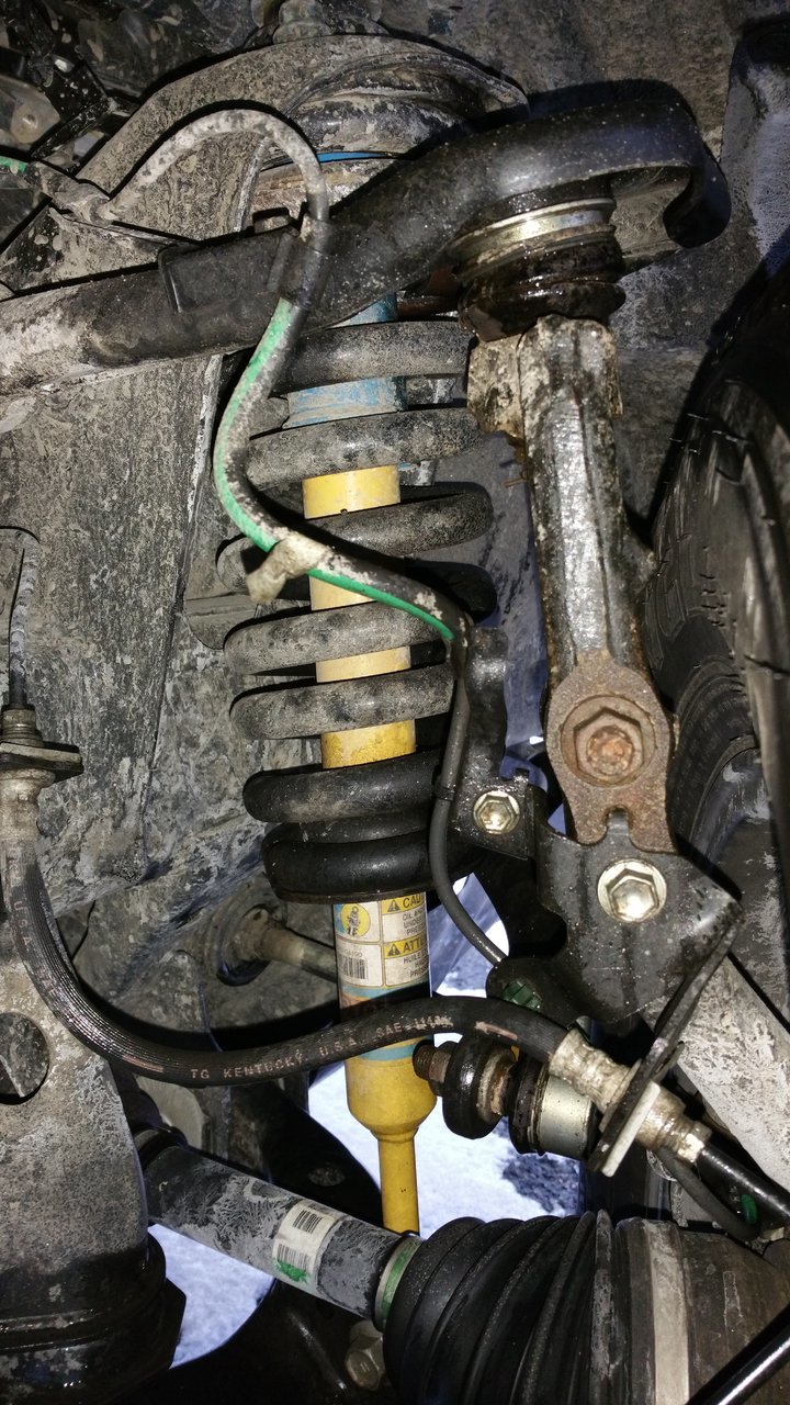

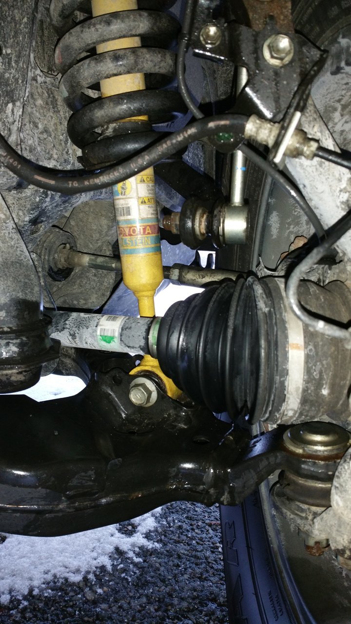

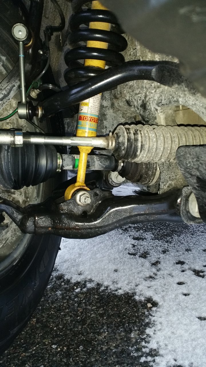

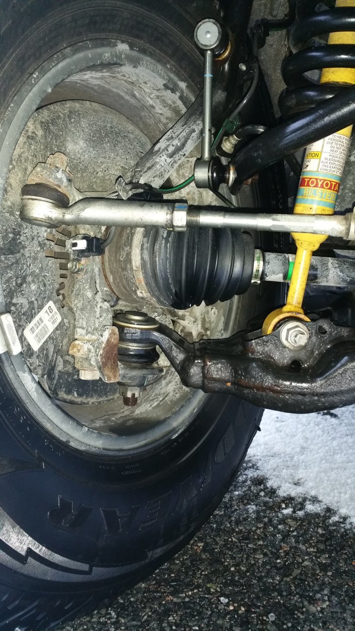

    20171214_080656.jpg 20171214_080717.jpg 20171214_080725.jpg 20171214_080829.jpg 20171214_080839.jpg

    Am I seeing things or do I see oil slung round?
    ChadsPride likes this.

    I was wondering similar. It looks like you have some sort of fresh fluid on some of your LCAs. Is that just road contaminants or is something leaking?

    It just looks wet to me...

    Well you could always take your hand and feel around the wet areas. Oil is pretty discrenable from water and road spray. The inner CV boot area does look like they are wet on the tulip side, could be worth taking a look at just to verify.
