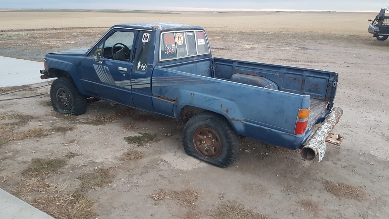

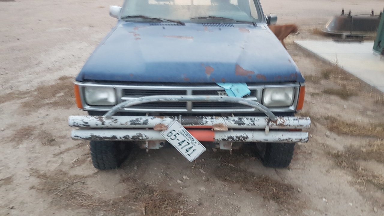

    I sold one of my yotas the other day. Anyone want the bumpers from it. Bring me a bottle of whiskey and it's yours.

    Doode, this is like the very beginnings of mod evolution. It's gotta be the earliest known Yota mod. Kinda cool actually.

    Is its not terrible but i like my stock bumper on my other one better.

    What year and how many miles? I remember when these were new back in the day.

    1987. 145k.... Original paint! Sorry for the random misdirect OP.
