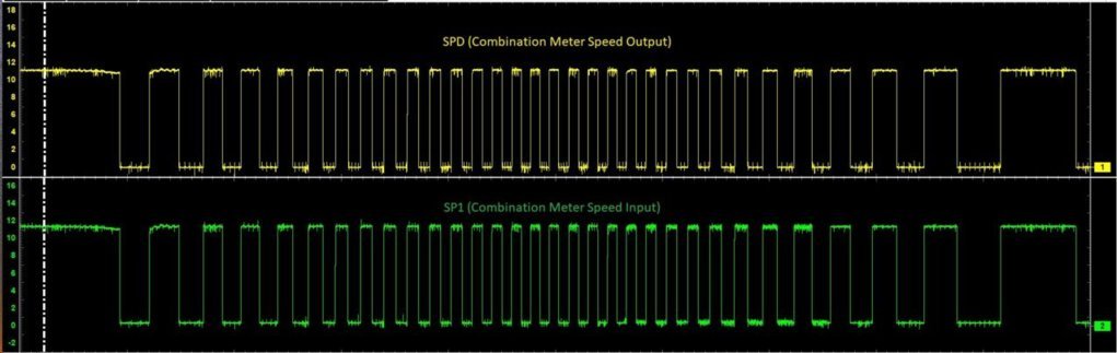

    The Meter receives the Vehicle Speed Signal from the Skid Control ECU (ABS module), uses it for speedometer and odometer functions and retransmits the same signal to the rest of the modules on the SPD circuit.
    As you can see by the scope capture below the signals in and out are identical.
    The only way to change the calibration to correct the speed for tires or gear changes is to modify the speed signal input to the Meter which would also change the signal output, several companies make such modules.
    For more information on how the vehicle speed system operates see the post below (scroll down to P0500).
    https://www.tacomaworld.com/threads/2nd-gen-information-diagnostics.784008/#post-28042157
