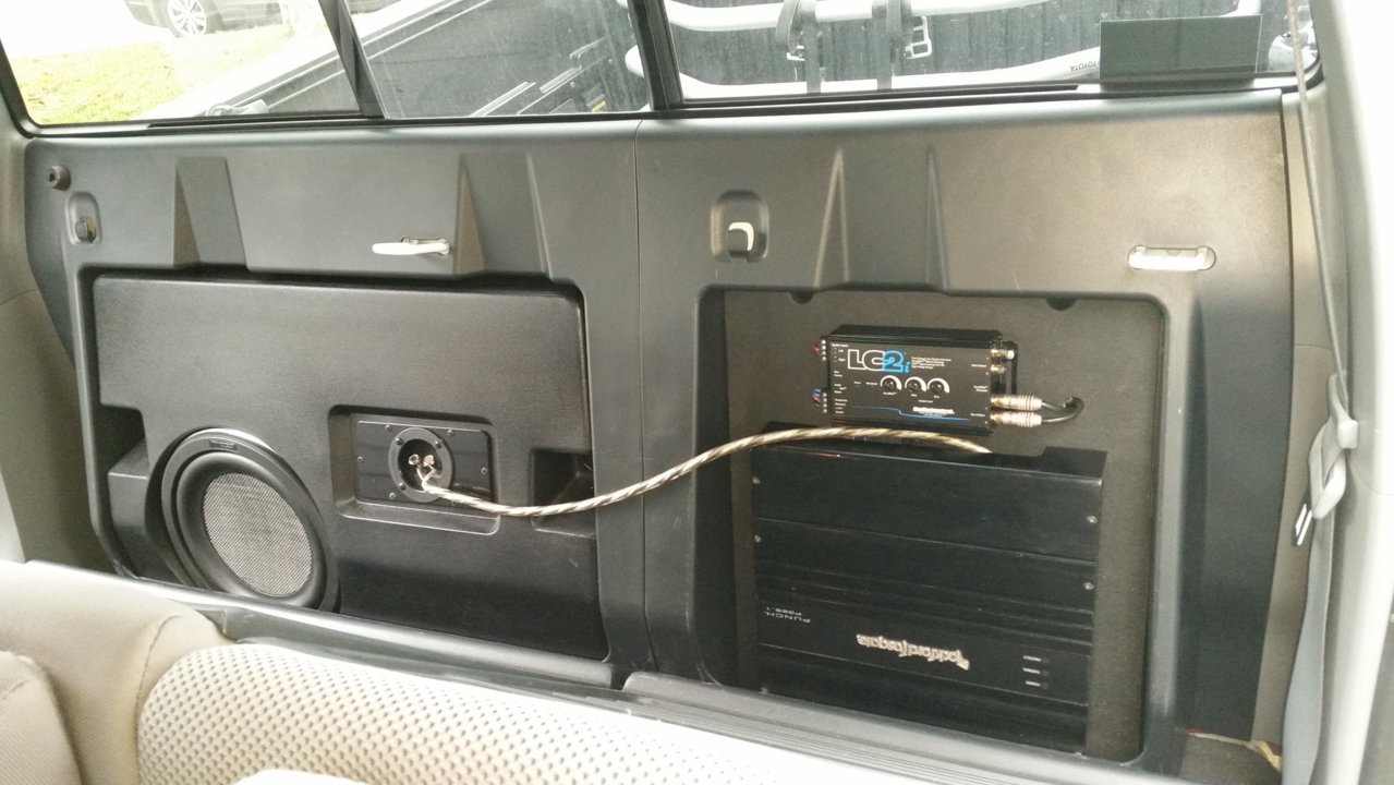

    If you want something that fits behind the passenger rear seat that makes no modifications to the truck try and find a Schosche TATAC05. They are no longer manufactured, but you might get lucky and find one for sale somewhere. They are plastic, but once filled with poly they sound pretty good. You can swap out the sub for something better like I did. There are also things like the Kicker Hideaway or the Stealthbox like spiral mentioned that people have installed under the seats or in the pocket where I have my amp.
    The system in my 2014 DCSB currently consists of the stock HU, a set of Memphis Audio 15-SRX60C components up front, stock rear door speakers, Kicker Key 180.4, an older Rockford Fosgate P325.1 amp, an LC2i, and a Kenwood Excelon KFC-XW1000F 10 inch shallow mount sub. For Christmas I received a Kenwood DDX9907XR HU and I am picking up some Kicker 46CSC654 speakers for the rear doors today.

    can we see a pic of your amp install?
