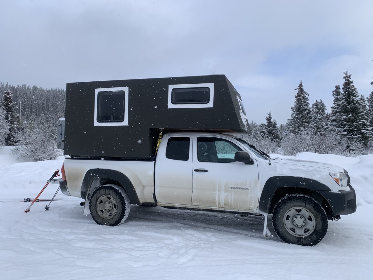

  19. Jun 30, 2023 at 2:58 PM
    #19
    Bossert
    Bossert [OP] Member
    Dec 14, 2020
    #349649
    15
    Hehe going off topic here, but here are the few pictures I could find :
    100% homemade, 800 pounds, wood + fabric + lots of wood glue (waterproof) + paint (uv and waterproof). We use it in the winter in Alaska / Yukon, up to -25 F no problem. Lithium battery is self heating if cold before charging, it is fantastic. (30 minutes to go from -20 F to 45 F, then it charges the battery)
    nd4spdbh and wi_taco like this.
