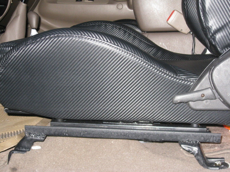

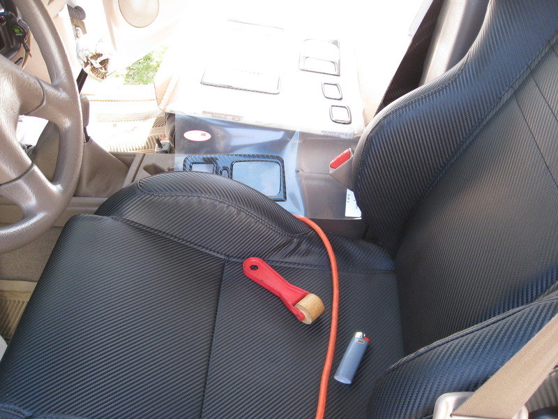

    change your suspension. try and use a hydro-filled dual dampening shock. Like a Monroe-sensa track. You can also put on a rear sway bar and link kit. Then only things to do is increase tire sidewall and swap the seats. there is a fine line on the tire pressure.....29lbs is to soft and squishy-but rides good and 40 is to rough-but better mileage and handling.
    I like a race seat with "jap" memory foam......Surprisingly comfortable. And i added heatind pads to the top back portion and the lower seat.
    These seats are made to my body and back dimensions. Special ordered took 6 month so they didn't cost much more than the regular ones they sell. Cipher racing.
