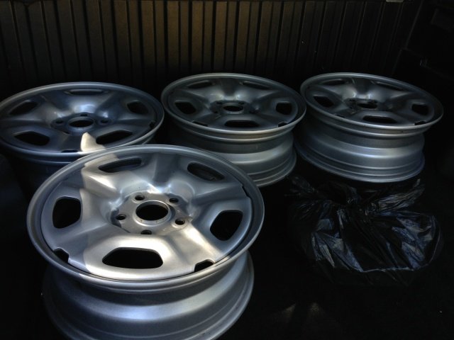

    Newbie here. So I currently have Wild Peak A/T Off-Road Tires - 285/75R16 122Q on my truck. Looking at the valve stem I see that it's metal w. the hex bolt = TPMS?
    I bought these rims cuz they were cheap:
    They don't have TPMS tho. Problem? Or just black tape mod it?

    Umm.... you have a Prerunner? Prerunner has 6-lug suspension, those rims are stock steelies from the '05+ 5-lug and won't fit the Prerunner.
    You can buy TPMS stems for the new rims and have the computer programmed, or you can transfer your current stems onto the new rims.
    The stock steel TPMS sensors will fit alloy rims by rotating them 180... the stock alloy TPMS should go right in.
    How much did you pay for those rims? I'll be upgrading mine next year and I'm curious what I can get for them.

    Ahh okay. So sell these wheels that I bought then?
    What's the best way to get these 285's off and 245's on them while spending as little as possible?
    I got them for around 75
