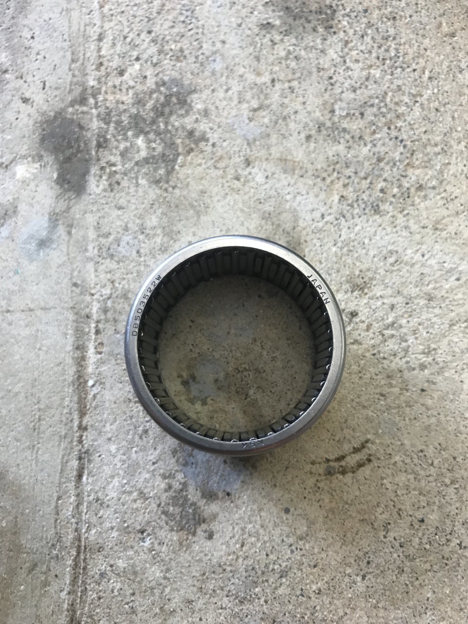

    Successfully taken out. Had to grind my remover tool a bit to get it to seat behind he needle bearing.
    Stock needle bearing seems to be in perfect condition.

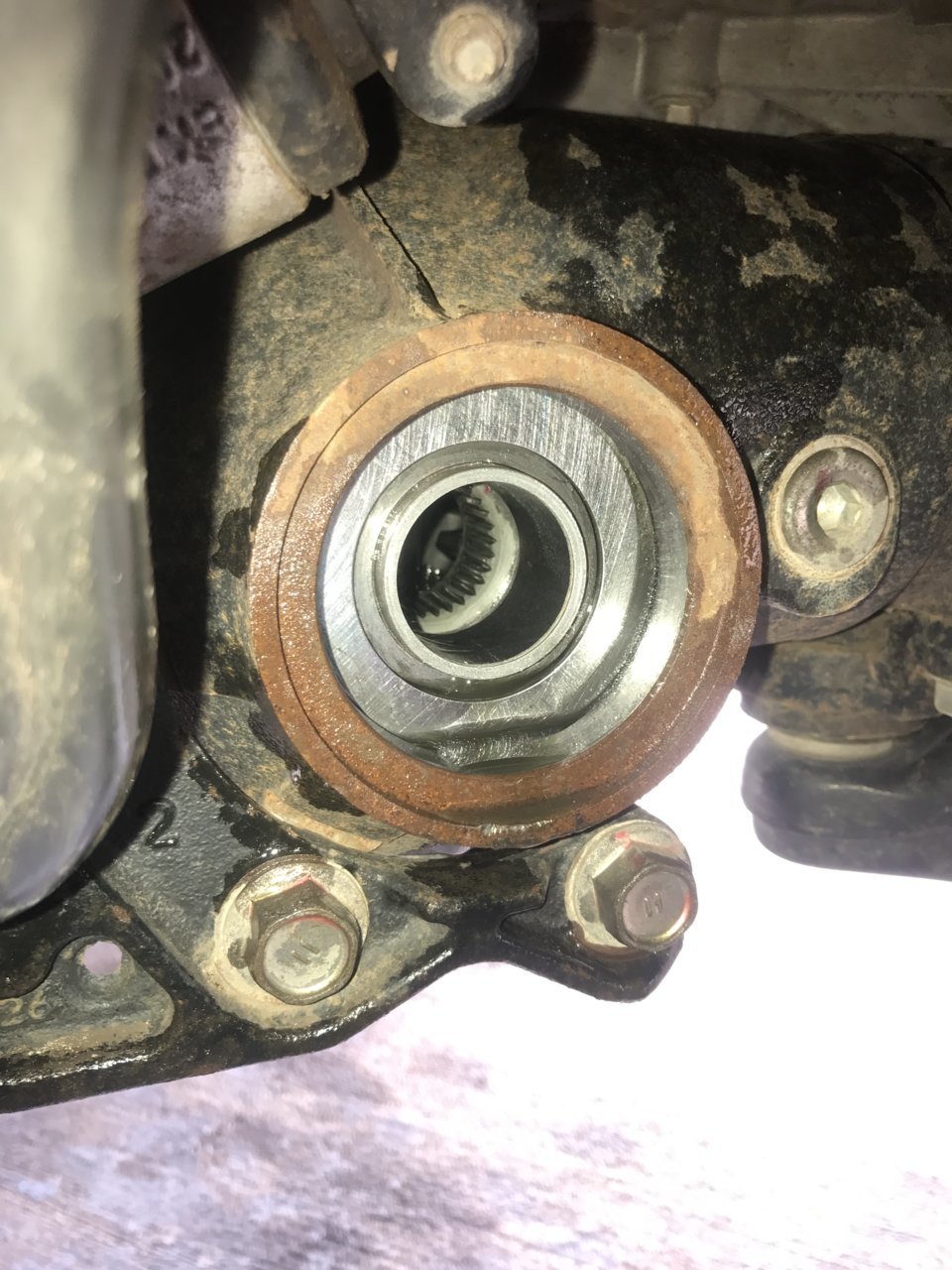

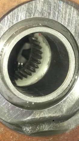

    How far in do I pound the ECGS bushing? Flush with the sleeve that it's going into?
  17. Oct 12, 2019 at 2:23 PM
    #17
    Grossomotto
    Grossomotto Complete 3rd Member
    Mar 13, 2018
    #247175
    8,446
    39.9526° N, 75.1652° W
    2017 4WDV6LB6MT
    Almost flush, 1/16” out that’s what I’ve been told
  18. Oct 12, 2019 at 2:25 PM
    #18
    Dr. Emmett Brown
    Dr. Emmett Brown [OP] Well-Known Member
    Dec 9, 2018
    #275320
    1,795
    Oh okay so more flush with the outter ring that the seal sits on and not the one I am putting the bushing directly into?
  19. Oct 12, 2019 at 2:33 PM
    #19
    Grossomotto
    Mar 13, 2018
    #247175
    8,446
    2017 4WDV6LB6MT
    See the 1/8” shiney ring just outside the hole, almost flush with that
  20. Oct 12, 2019 at 2:35 PM
    #20
    Dr. Emmett Brown
    Dec 9, 2018
    #275320
    1,795
    Perfect.
