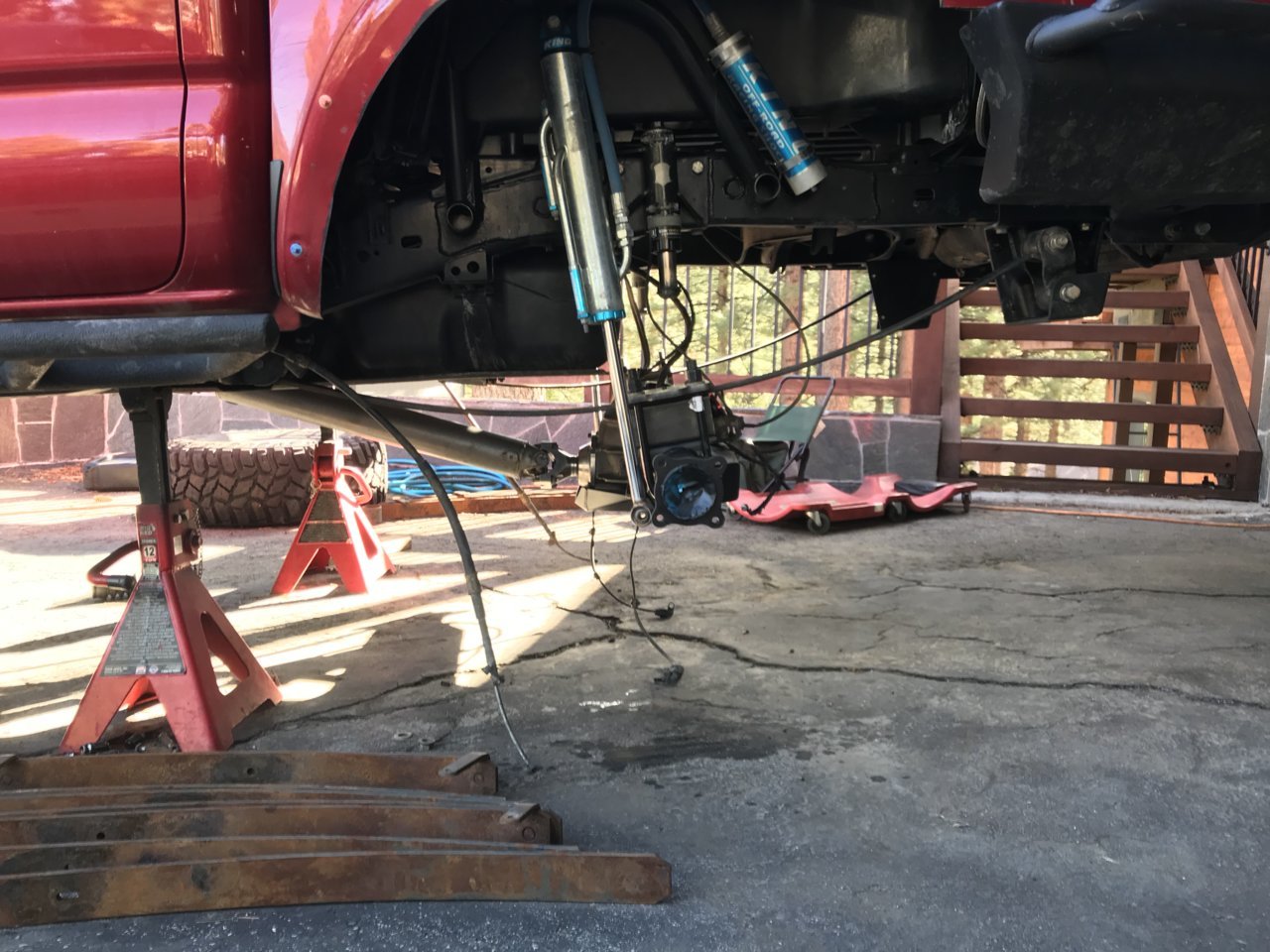

    Oh you mean this big bitch right here?

    It’s far from “bolt in” but its an adventure. I’m stupid so I upgraded to 3.5” axle tubes, rear truss, and doing disk BBK swap too.

    Just so you know now. The slip yoke in the stock driveshaft isn’t long enough to accommodate a crossover u-joint. You will have to extend the second half of your driveshaft or change out the 1350 yoke to a flange yoke.

    Yeah, like i said. Just get the second half of the DS lengthened. Any driveshaft shop can do it.
    And you can use a 1330/1350 crossover u-joint on the last 1330 joint on your stock driveshaft and remove the last flange.
