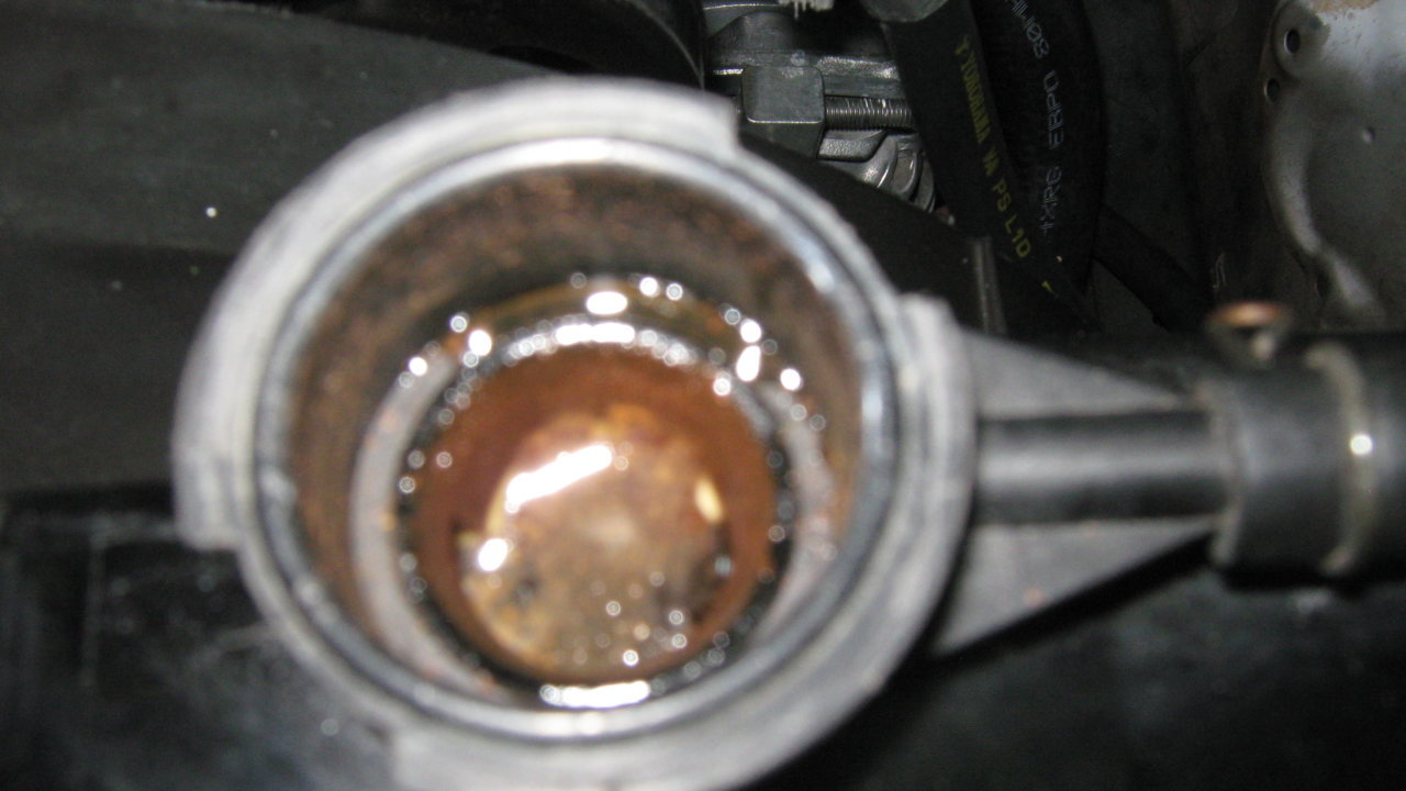

    so I gambled and lost- new cyl head etc but didn't have block machined and used an mls gasket. Fired it up (finally) this morning -much smoke, & I do mean a LOT of smoke. Sounded-ok. There was something I didn't like the sound of but unable to either identify the sound or put my finger on why, exactly, I didn't like it. Books recommend letting car run 20 minutes then shut down check for leaks etc. I killed it at about 10- just a feeling. Which, added to the fact that the temp gauge never moved, the upper radiator hose was plenty warm enough but the thermostat never opened, bothered me enough to against 'the book''s instructions.
    Went to A-Z, bought new thermo (ouch!) Came home to drain some water and-ugh. I'm so -angry? no, devastated? no, broke? Tired? Ready to open the gas tank and toss in a lit fuse then dance like a fool around the fire? okay, all the above, and then some.
    Damnit.
    damnit
    damnit
    damnit
    So. The primary reason I didn't have the block decked was that I had no means of getting it to the shop. That is still the casse, even more so, actually. And I'm broke. Tapped. Going to work tomorrow (for a pittance, but better than nothing) and got some stuff I'm going to try to sell. I can come up with the money for another head gasket (I understand they're quite a bit more forgiving of imperfections -?) but that's about it till I can 'go back to work'..
    so some questions -as to how to proceed from here, product recommendations, tips, constructive criticisms (though chances are I've already told myself ad nauseum how I've screwed up). Taking the block to a shop for machining is not an option right now. Even if I could get it there I couldn't pay for it- after the truck is reliably back on the road for a time I can work in my chosen trade and make some real money.....but the truck is essential, "can't get there from here."
    Do I : drain the soup out of the cooling system and chemically flush it ( I have some Prestone stuff on the shelf, already paid for). Should I run a compression test? It HAD compression, shot oil all over the place yesterday....and I did not let it run very long. I've not been in this position before so hoping for a little push in the right direction.....
    Am shopping for a composite gasket- does anyone have any thoughts on brands or experience using products by different manufacturers?
    Is it mandatory to replace the manifold gaskets? I know it's theoretically possible to leave them connected but that's just not feasible here. And I know I should replace the headbolts, especially w/ their being TTY... and...and....
    Incidentally, some cautious impulse caused me to delay adding antifeeze til I was sure it (the truck) would be roadworthy. That's good, right? It had only distilled water in cooling system (now it has liver-colored lava lamp lookalike).
    Sorry for the looong post- is anyone still with me?

    well hello all and thanks for the quick and comprehensive replies. I'll try to answer in order....Thanks for the good thoughts Jay. It happens, you know? I do get a pretty fair share of good luck......can't complain too much.
    @toyrunner: are you serious about the water possibly getting in the cooling jackets when the head was removed? and I (um) just ass-u-med re: bad hg. There seems a _lot_ of oil in my radiator. There does not appear to be water in my oil. ....you do have an excellent point about trying again ....really, at this point I don't have much to lose.
    thanks for the link MrCrowntown. I'd love to use ARP studs- I just can't afford them. Got the head out of LA-"Machine Shop Pros" . I learned, after I'd pre-paid and was waiting for the overdue head to arrive, that this place actually has a horrible reputation, yelp, the Better Business Bureau, etc. For both screwing people over and for providing shoddy, defective junk product. So my head went directly to a trusted machine shop, Parrish Automotive (where I should have purchased it to start with!) here in Sacramento to be vetted. It passed muster....
    Re: coolant temp sensors etc: I have grave doubts about several of the pigtails on the engine wiring harness. None appear to have wires actually broken but some have cracked insulation .....probably why the temp gauge never moved. That truck has never taken long to warm up- gauge usually starts to move w/in 3 minutes.
    guys, I started this reply some three hours ago-
    edit:
    whoops-
    didn't realize how poor the quality of those photos was. hopefully they'll give you the idea.......
    oh yes did I
    mention that the oil looks good?

    is it oil? or that copper leak seal stuff? Just asking...usually oil looks a different color...from what Ive seen.

    @cruxofthebisquit: looking back I cannot say definitively that I can swear to its being right-side-up. I had to call in outside help for that part of the process -I only have 1 1/2 operational hands and couldn't manipulate both setting the head down on the block and feeding the timing chain through. Your question is all too valid....this is one of those times I wish I'd allowed my typical ocd tendencies free rein. Is there any way I would be able to see evidence of incorrect orientation without removing the head? I'm all 'ears' or, in this case, eyes......
    @tony2018: I checked it with a Starrett straightedge- but note that it was not sold as a machinists straightedge.:smack:
    @DrZ: questioning my ability is perfectly legitimate- you don't know me nor have any way of judging my capability. (thanks for being so diplomatic, that never hurts!) That block was spotless- matter of fact it was far far cleaner than I expected it to be when I took the head off. -There wasn't any actual gasket material on it, only accumulated rusty dirty buildup. Just grunge. When done cleaning it I went over every centimeter w/fingertips, then aimed a strong directional light across it at an angle at night with my face up close to it (in order to silhouette any imperfections- done right , problems stand out clearly). Final step pre-installation was wiping both surfaces down w/99% rubbing alcohol. Head made no contact with any other surface or substance from then until being set down on block. Yes, of those steps I am absolutely confident. Re: head bolt holes and threads/lubrication and tightening sequence and torque: yup, confident all those steps flawlessly completed. W/ a quality torque wrench (Craftsman dial -type). On that subject, two caveats: one: the torque wrench hadn't been calibrated in several years so I cross-checked it with another torque wrench (cheaper but far newer). two: I don't have a torque angle meter so I used paint procedure.
    @MrCrowntown: damn, you had to go and point that out, didn't you....? (j/k!) Thank you, you are too right! Thank you for the more objective perspective :smack: And do you mean the (often mis-called) " freeze plugs"? I bought a new set of those in copper, installed three, left incomplete because the ones I removed were in excellent condition, which surprised me in light of how poorly maintained the cooling system was when I bought the truck: no coolant, just rusty sludge that clogged the radiator to the point of overheating the first time I drove it out of town. Radiator and most cooling hoses replaced at that time along with a manual scrub -and -flush with assorted long brushes as far as I could manipulate them in every accessible orifice of the engine. So I still have most of the set (minus the three I replaced)- and one I destroyed that fought me to a draw both coming out and going in.
    @twblanset: please see my response to DrZ above. AND yes my truck is an automatic. Never thought about that possibility. Do you know of any way I could troubleshoot this possibility for confirmation or removing it from the 'possible cause' list? Thank you.
    @wilcam47: ok, you got me- what "copper leak stuff"? Sorry for the poor quality of the photo, I will take another (better!) :mudding:one and post it.
