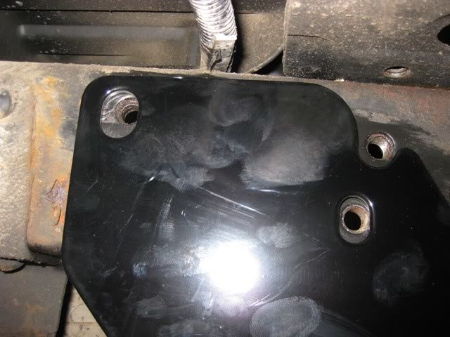

    :mad: I bought a new Curt Hitch easy bolt on 45min job, No, I battled it for two hrs. Two holes don't line up and the end flanges are tight in front and loose at the rear. I should have bought a Reese.

    I recently purchased a curt hitch as well. The holes on mine were placed correctly, but the two arms were bowed in slightly (~2cm) so I had to but some (a lot actually, thought i was gonna blow a gasket) GRR on it to spread 'em a bit.

    I'd be kinda scared to hook up a trailer to a hitch that obviously wasn't made very well... If the mounting points weren't correct, who knows what other corners were cut when that thing was made.

    x2, and I wouldn't tow with that thing. If the hitch doesn't fit tight, the mounting bolts are supporting more weight then they normally should. Needless to say, the mounting bolts are not as strong as the steel assembly, creating a weak link and a point of failure. Hopefully you can return that thing and get either a new one or another brand.

    Same deal here. One of the mounting holes on either had to be opened up. It was the larges hole, yet it was still off.
    There was also a gap between the hitch mount and frame. The hitch didn't sit flush on both frame rails.

    I took a big hammer stood on the hitch and whacked the end plates twice toward the rear where the gaps were,then I hit the front of the plates outward where it was too tight. Fits great, after I took my dremel and fixed the mounting holes. It also took double spacers where the bumper bolts on.It's actually very well made, Its a shame, they didn't use a proper jig when it was welded up.:D
