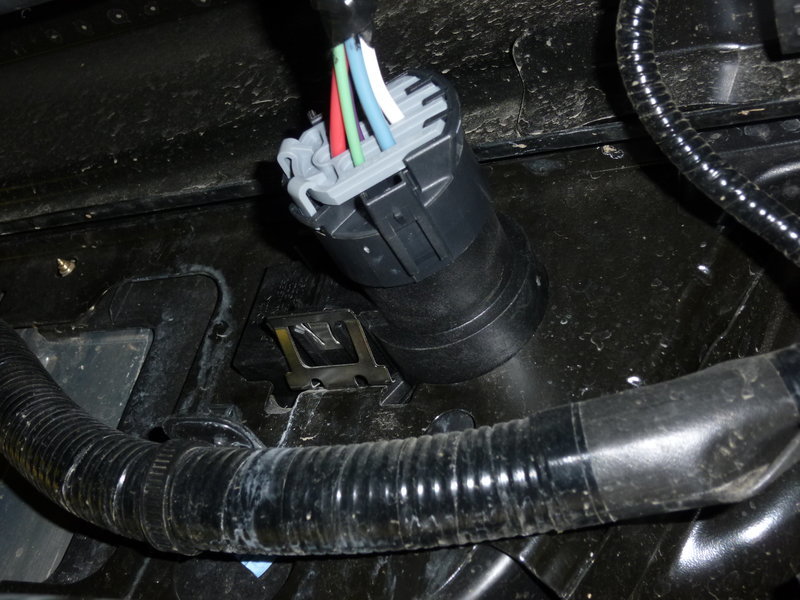

    050.jpg 052.jpg 049.jpg e-trailer is selling the plug-n-play wiring harness for the 2016 Tacoma. The part number is C56282. You disconnect the connectors on the truck tail lights and plug in the harness. This unit requires you to run a wire to the front of the truck for the 12V that powers the trailer lights.
    If you want to install the factory style 7/4 pin receptical by the liscence plate, the part number is HM40975-11998. This is the kit that comes with the connector and wires that plug into the new recepticle. Cut the 4 pin flat off and connect to the same color wires on the new recepticle wires. You will have 3 wires left over. Use these if you want to wire in a controller for trailer breaks. I don't like chasis grounds so I ran two wires to the front of the truck. One for ground and one for the 12v that provides power for the trailer lights. If you choose to do this you will need an extra 22 feet of 12 ga. wire. I made all the connections behind the tail light (there is plenty of roon in there). I also installed the controller box in this area. I had to extend the green wire that goes over to the right tail light. It could have been my installation, but it looked pretty short. I used conduit everywhere.

    I need your help. I got all of the exact same equipment you did, wired both positive and the ground to the battery up front but the lights on the driver side of the trailer don't work? I've checked everything I can think of.
  12. Sep 23, 2016 at 11:04 AM
    xbriggzyx
    xbriggzyx New Member
    Mar 30, 2016
    #182830
    4
    I have the same problem. I haven't tried to fix it yet. Drivers side trailer lights flash faintly when the brakes are on. Not sure why.

    For those who have successfully got this setup to work please update us who have been having the issue of the driverside(left), power, brake, and signal, not working. This would save future member a lot of stress. I hooked up my setup and had the same issue as some of you guys. I just got off the phone with etrailer and they told me I have the wrong 7 and 4pole connector(HM40975-11998). They suggest for me to order the plug for a 2nd gen. I'll try to rewire to see if I have missed something or done something wrong. If I figure something out I'll let you guys know.
  15. Mar 16, 2017 at 2:34 PM
    WhiteYota17
    WhiteYota17 Member
    Mar 14, 2017
    #213250
    7
    George
    Gresham
    2017 White Tacoma TRD OFF-ROAD
    Stock
    Easy fix. When you cut the flat 4 connector from the hitch harness, you'll have Brown(power), White(ground), Green(right side), and Yellow(left side). From the 7 and 4 pole connector you'll have Brown, white, Green, Yellow, Red, Blue, and Black. Connect the three matching color wires except for yellow. You'll have to connect the red wire from the connector to the yellow from the harness. This should work. Look at the wire diagram if you have any issue. Regardless the color, as long as it's the same function it should work.
