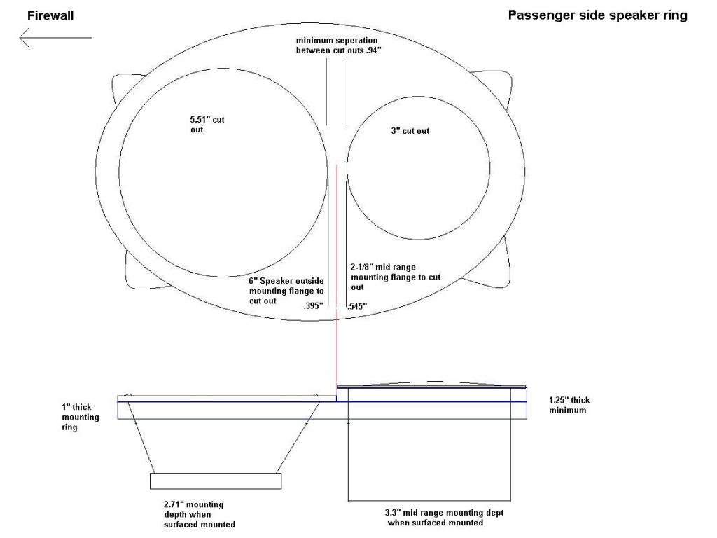

    I need a custom set of front speaker mounting rings for the 2010 double cab.
    I am setting up a 3 way system for the front stage.
    See attached picture.
    Key thing to note is the thickness of the mounting ring under the mid range driver. Due to its total depth the ring needs to be thicker.
    The plan is to take the ring as drawn up and shave the thicker part to just fit the mid range in with out bottoming out or hitting the inner door finishing panel
    I will give you a call tomorrow or Monday to discuss.
    Front 3 way
    6" driver http://www.parts-express.com/pe/showdetl.cfm?Partnumber=297-125
    2-1/8"miderange http://www.parts-express.com/pe/showdetl.cfm?Partnumber=287-025
    1-1/8" tweeter http://www.parts-express.com/pe/showdetl.cfm?Partnumber=277-080
