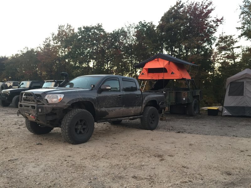

    I like this idea. Mounted under a toolbox in the bed. Fuel filler in the side of the toolbox. Dual fuel pumps T'd into the factory filler neck. Three switch panel in the cab. One controlling an electric valve and one for each pump. Fuel gauge for the Aux tank in the cab.
    I'm going to Moab in the fall from NJ. I think I'm going to do this. My truck is 5200 lbs with my recovery gear on board. Add my M1101 trailer with RTT and camping gear... fuel mileage? :rofl:
    I do not want to be stopping every two hours for fuel.
