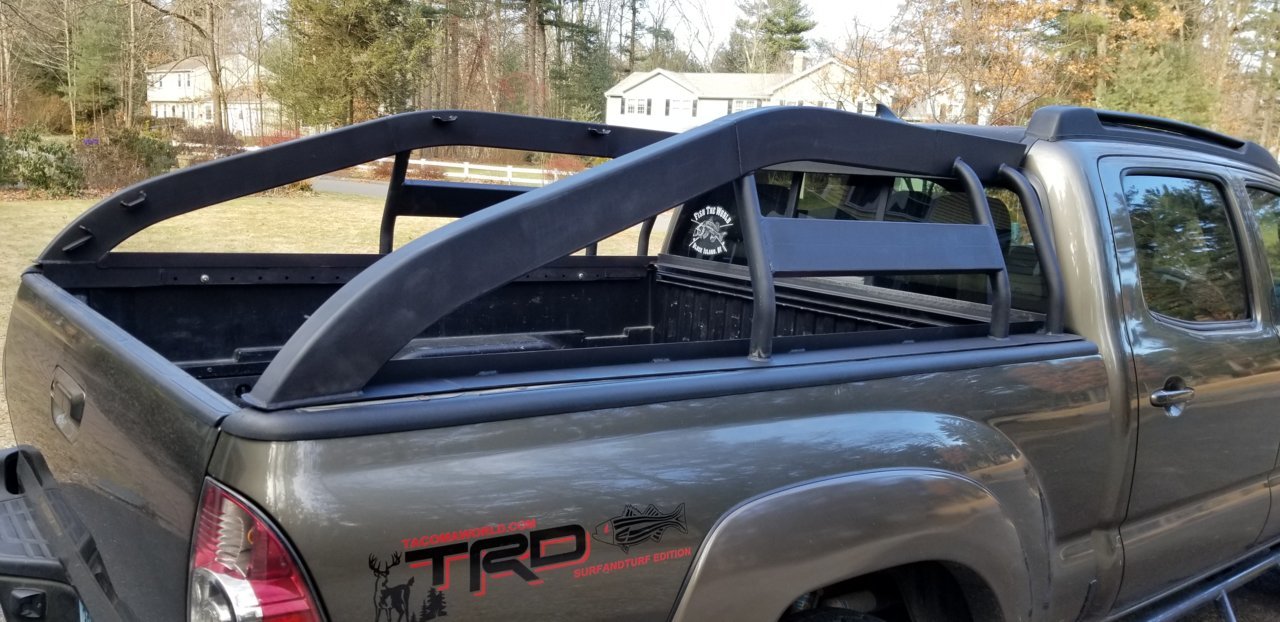

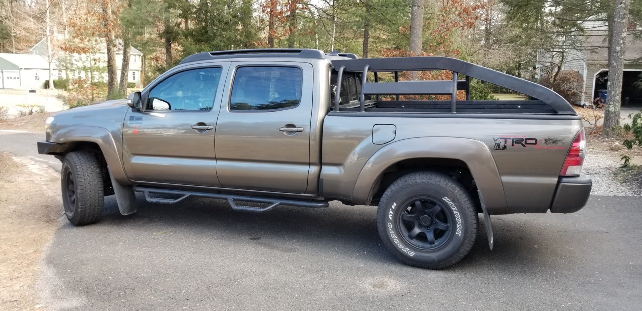

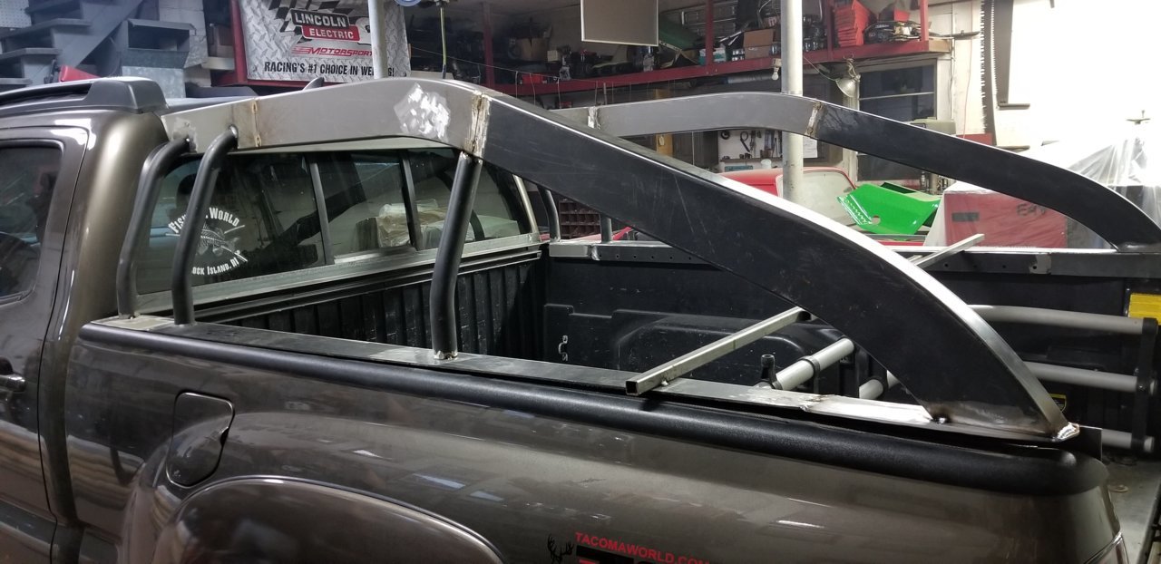

    Aerodynamic shape for better mpg
    Cargo capacity close to a cap
    Tonnaue cover runs down the center to load tall stuff
    Sides are soft topper like snap in place
    Traction skids and rotopax to be loaded on the sides like every other bad cage.

    Looks good. What material are u using. And thickness.

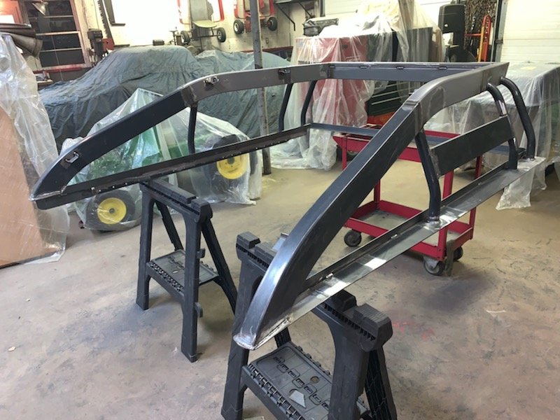

    Using an allpro bedcage as the base. Free treadmills off craigslist are making up the rest. Everything is 1/8" steel

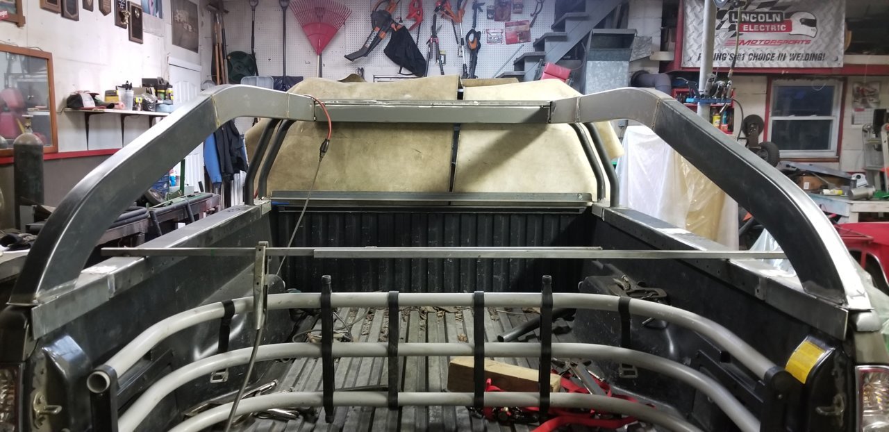

  5. Dec 30, 2018 at 3:38 PM
    surfandturf
    surfandturf [OP] Well-Known Member
    May 7, 2014
    #129333
    1,701
    CT
    2014 TRD DCLB
    Build update...

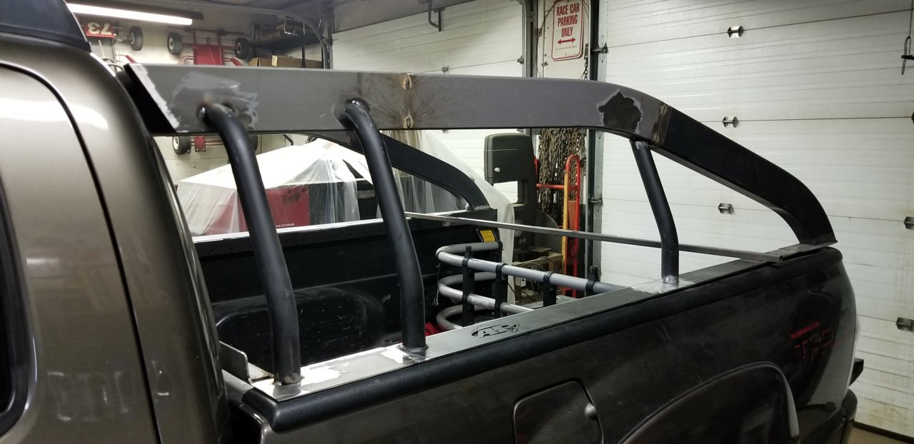

  6. Dec 30, 2018 at 4:05 PM
    surfandturf
    May 7, 2014
    #129333
    1,701
    CT
    2014 TRD DCLB

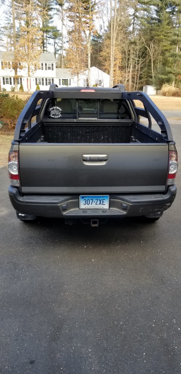

    Rear view, still have some work to do on the passenger side

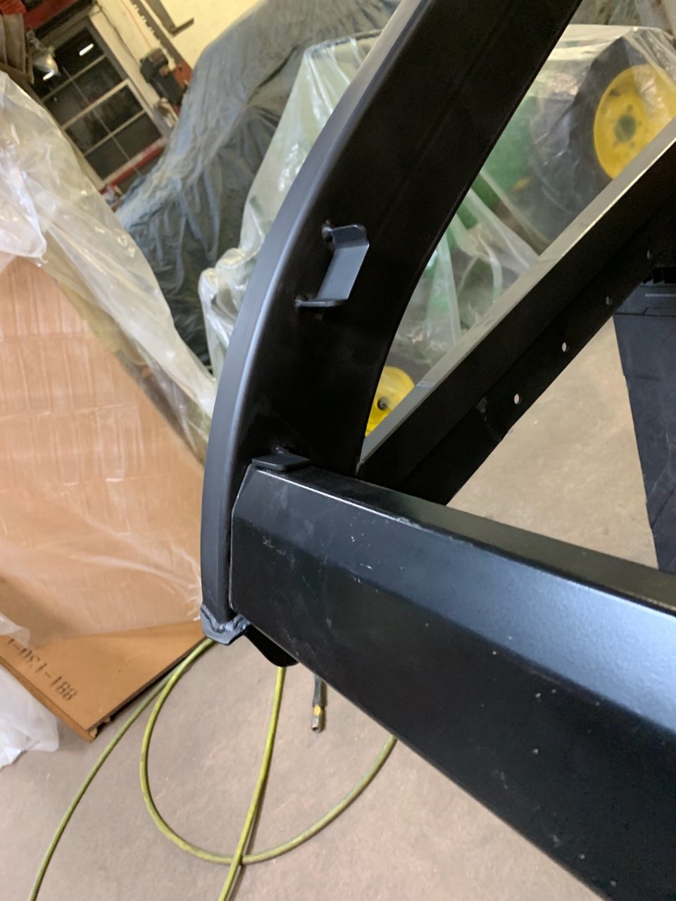

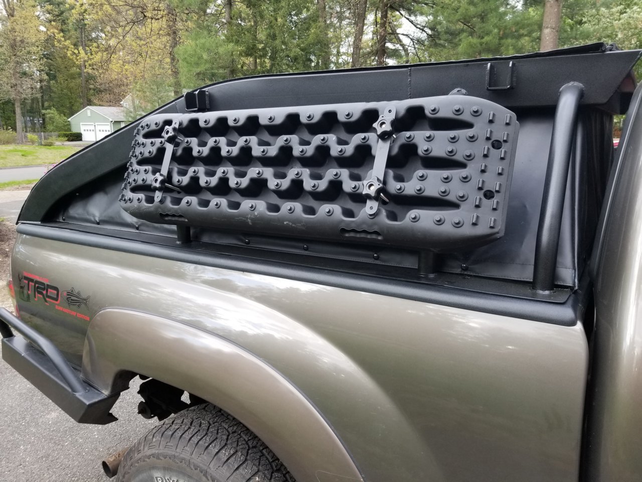

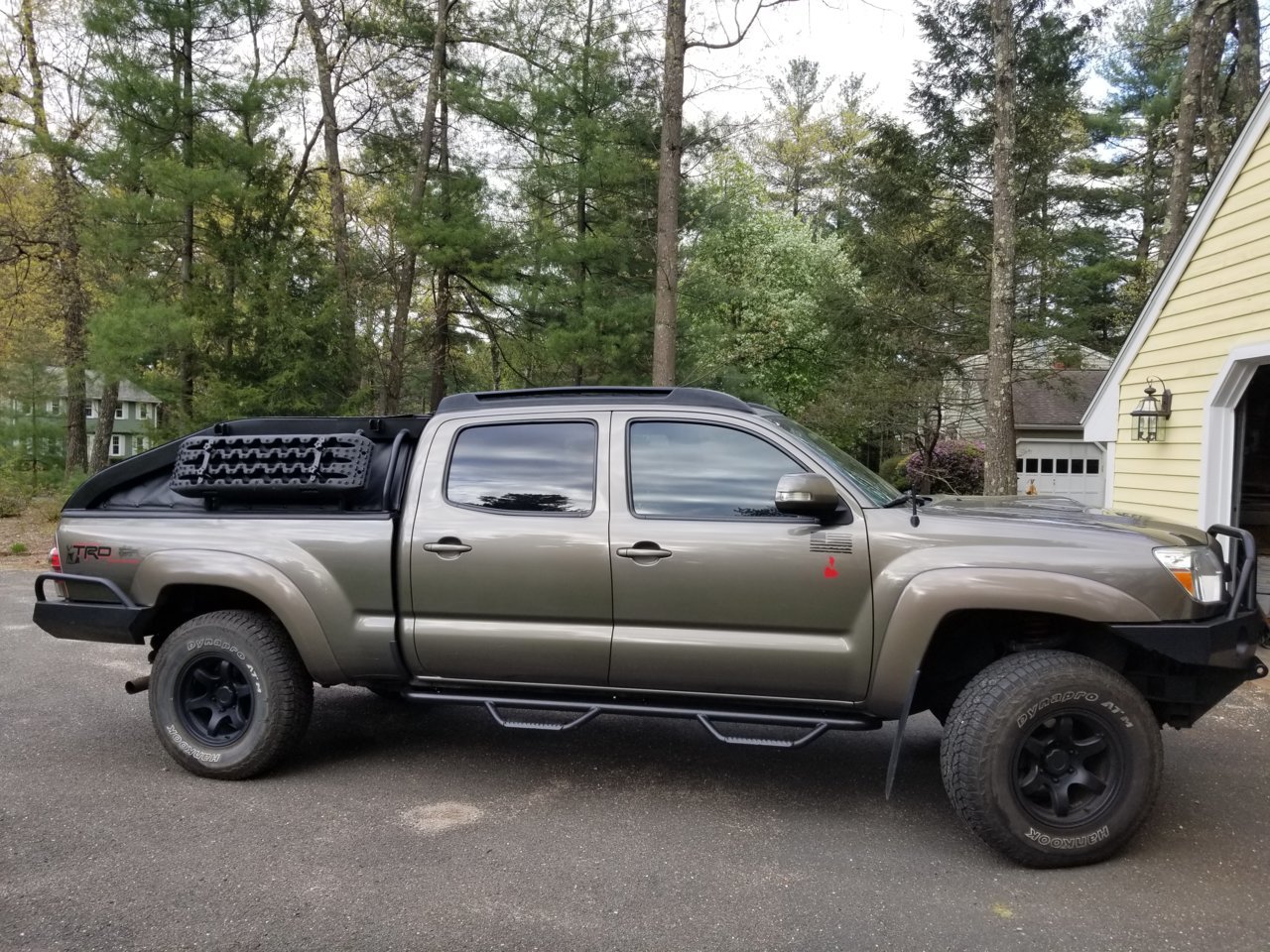

    Some more progress to mount to rotopax

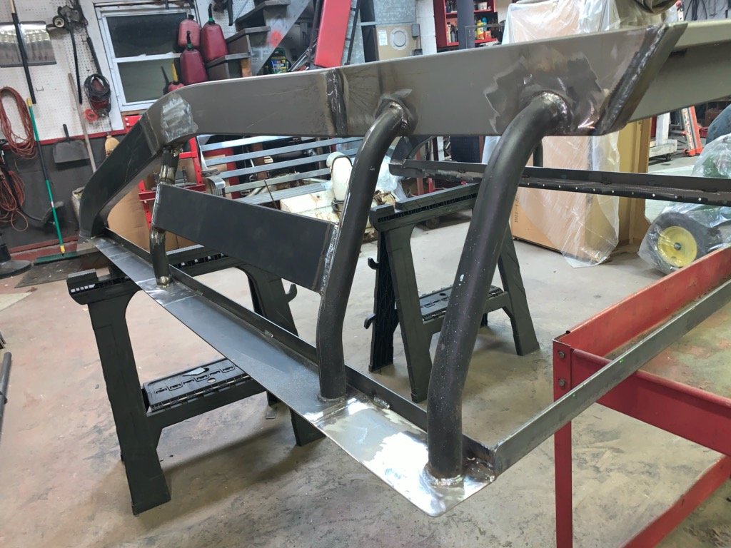

  8. Jan 8, 2019 at 10:05 AM
    surfandturf
    May 7, 2014
    #129333
    1,701
    CT
    2014 TRD DCLB

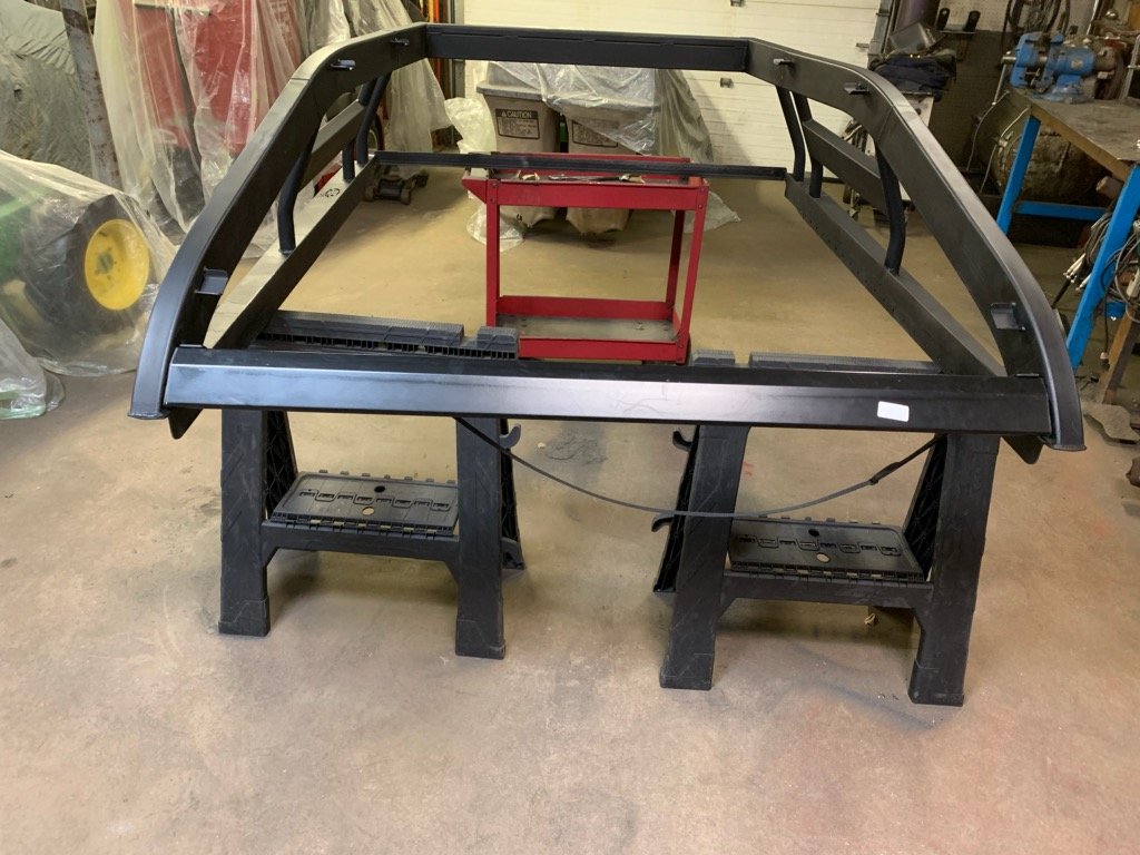

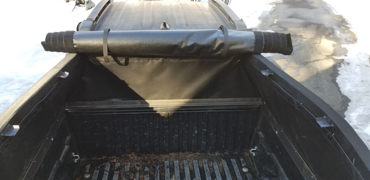

    Welding is done onto soft sides and tonneau cover installation

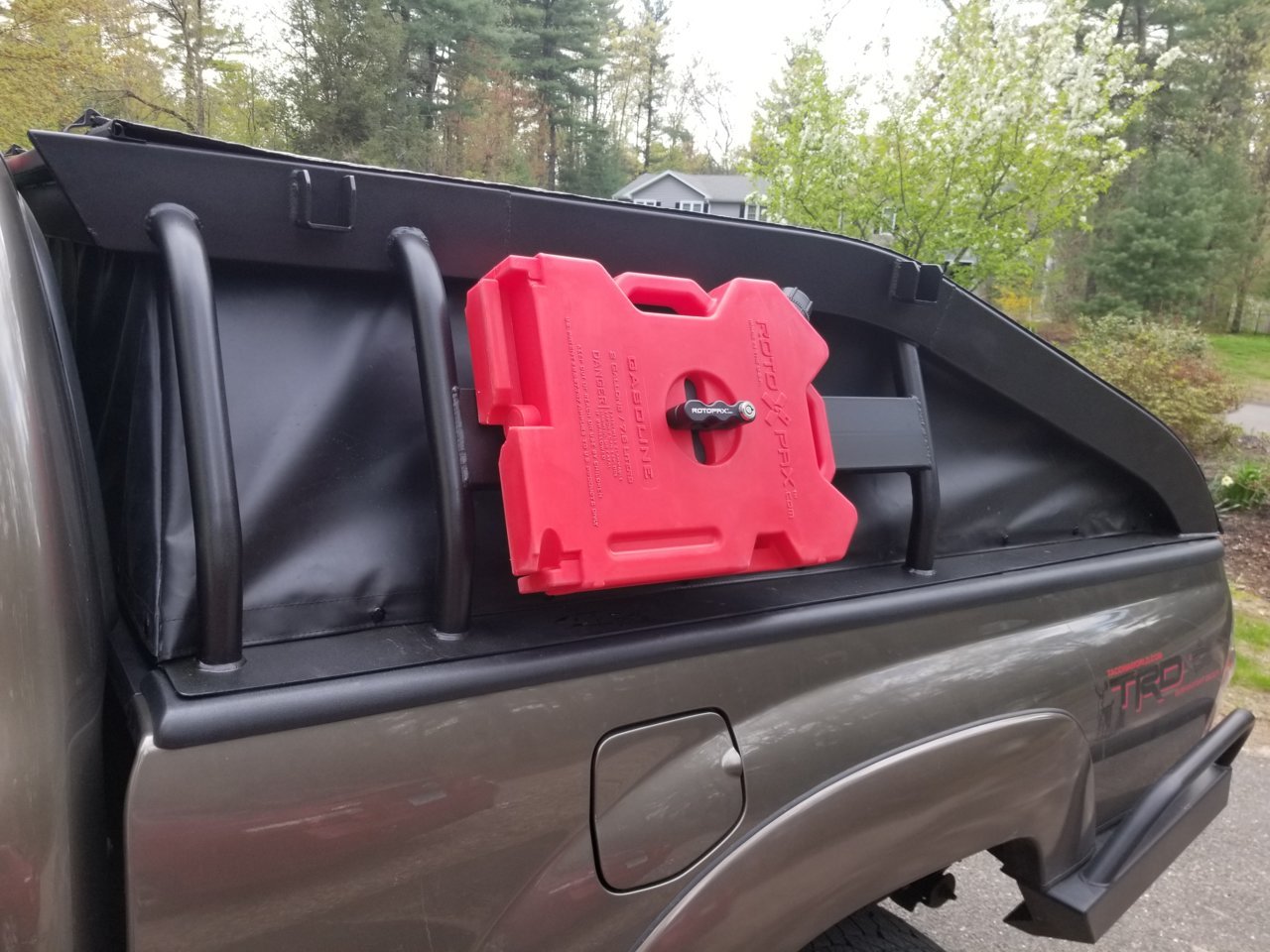

    Quick rattle can black until I sort out the hole drilling for accessories, get the tonneau on it and fill in the sides.

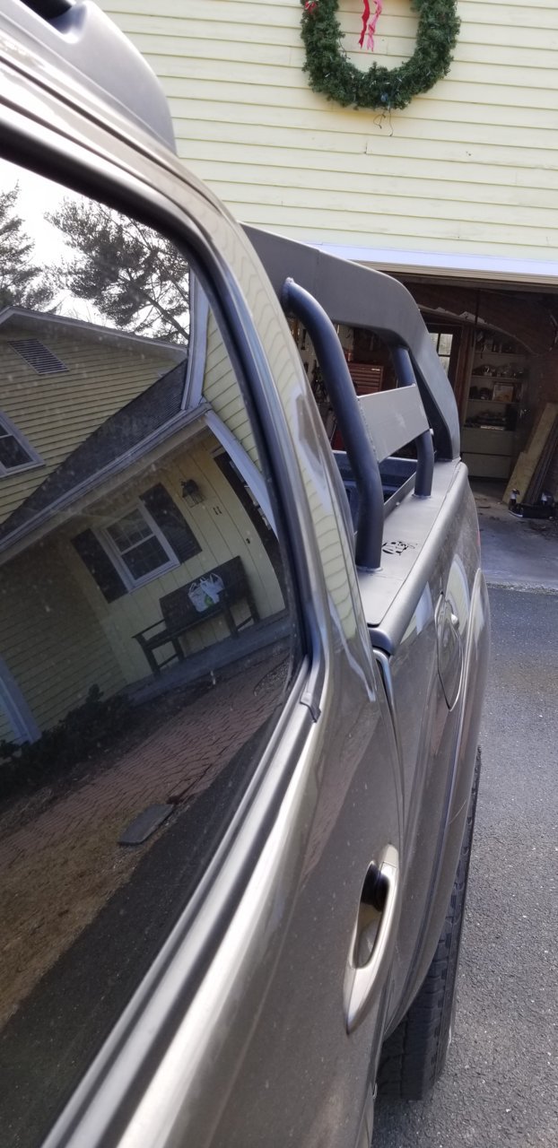

    Very interesting. I like the uniqueness and reuse of material. I'm a little concerned with how close the rack is to the cab at the top. I fear a little off road flex may cause the two to meet.
    Looking forward to seeing the finished product!
    :thumbsup:
    surfandturf[OP] likes this.
  17. Jan 12, 2019 at 1:45 PM
    #17
    surfandturf
    May 7, 2014
    #129333
    1,701
    CT
    2014 TRD DCLB
    I've got 2" between the rack and cab...should be good to go

    I got some welding help from a local freelancer. I have some ideas to streamline the next version. I'll be working on finishing this one up for the next few weeks
