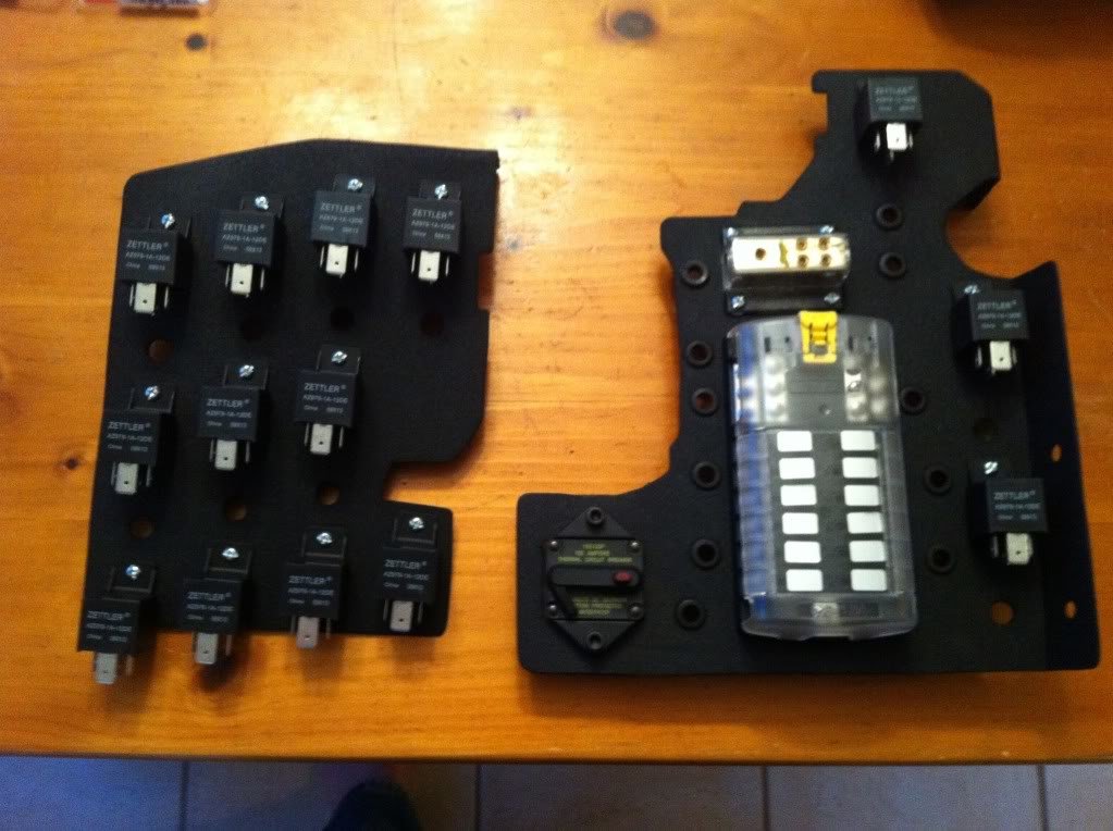

    I never heard back from him. So I bent these up instead...

    Ok, I haven't heard from him either so today I bought everything to do my own. This will be fun cutting freehand. :help:

    Cardboard is your friend! Mock it up then trace it out on the metal.

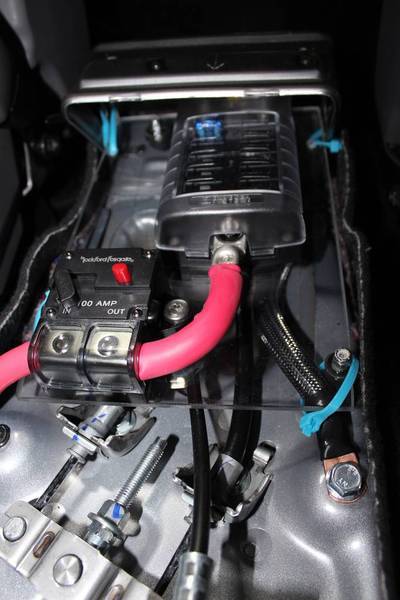

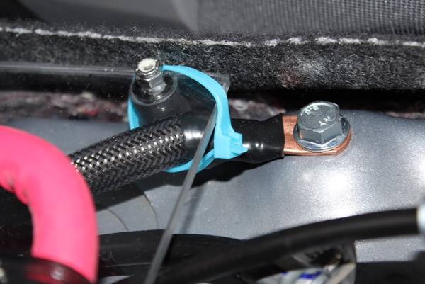

    Here is mine. I did one inside and outside the truck. :eek:
    Painted with engine enamel good to 2500 degrees. Lots of work but well worth it.
    WHOISTYLER likes this.
  20. Dec 17, 2013 at 3:14 PM
    #300
    Pepe98
    Pepe98 Love moding vehicles as hobby
    Oct 23, 2013
    #115107
    384
    Paul
    Dayton, Ohio
    SR5 that's begging for mods
    1st Update: 500 miles Rugged Ridges Matts, Dimming rear view mirror with comp/temp, AeroForce Tech Interceptor Gauge, Aeries Professional Bull and Nerf bars, LED Lighting complete in-Cab, LED DRLs, AMP Bed Xtendr, Extang Trifecta Signature Series Tonneau, Rigid Ind LED Lighting 30" E and 20" SR series, Rigid LED Grill insert, Katskinz Leather Interior, Custom 100amp Electrical Sub Panel x2 (Engine bay and Interior), custom vinyl bed side, interior accent lighting galore (Oznium), OTTRAW, switches, under hood lighting, Red Line Elite hood struts, Power Pop-n-Lock, Under Bed Rail Lighting (switched), Custom Tinting... More to come

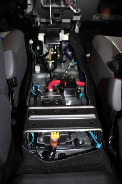

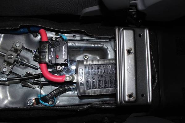

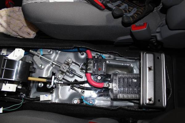

    Ok. Under my console.
    Used Plexi. Building a plexi bender this weekend just for my next two on my daughters Jeep and her boyfriends XJ. Built legs out of spacers bad rubber hood bumpers to lift it away from e-break cables, etc. ran the ground back to existing empty M8 1.25 mm bolt location to ground it all.
    Expanded an unused entry grommet to hold a 1 " wiring harness grommet to take the 0AWG power supply into the interior.
