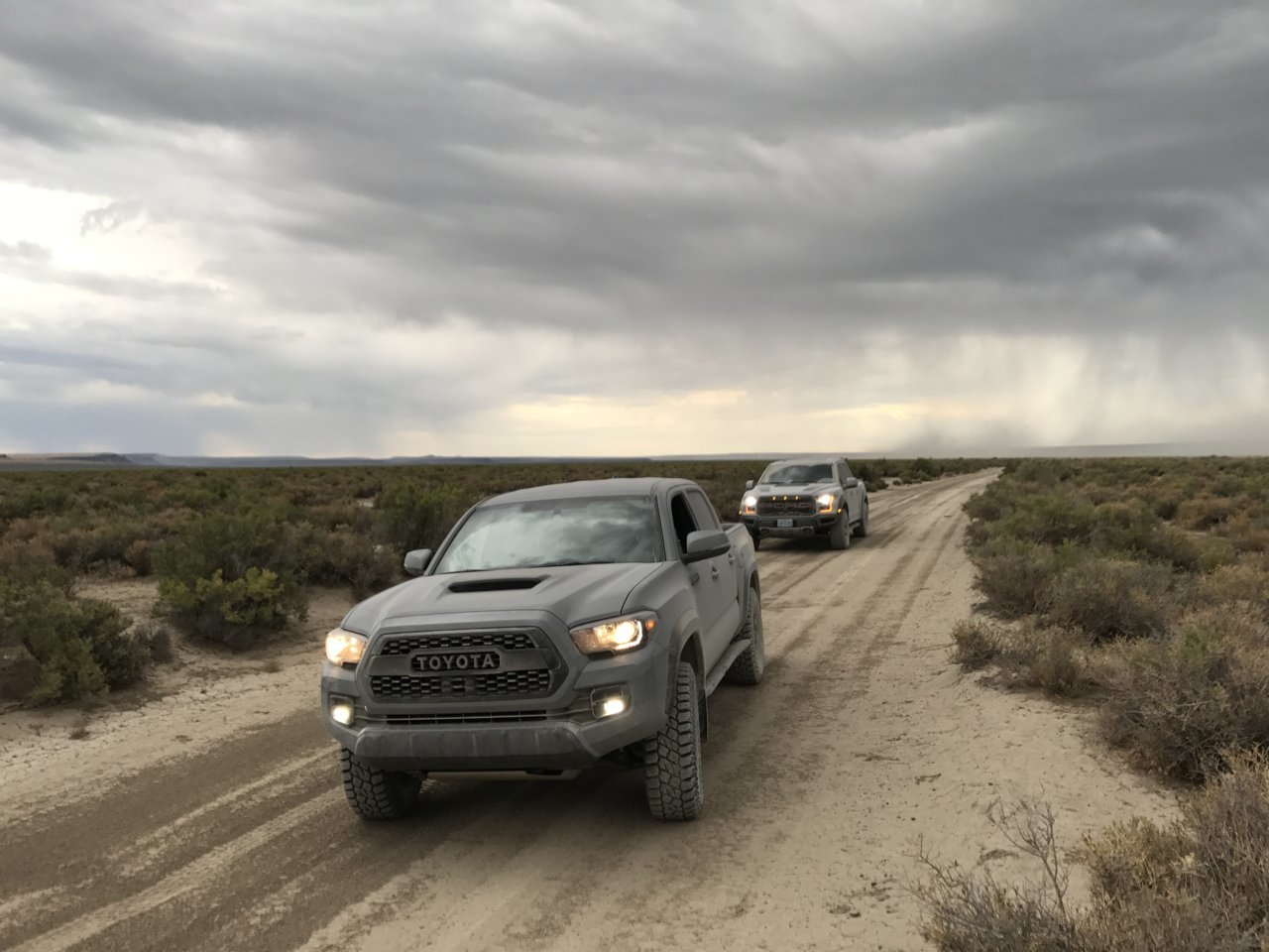

    Hey, thanks for that info, that’s helpful.
    I noticed that once you go to long travel you have to start replacing control arms and other suspension components which started to push me toward something more custom. I may very well use long travel coil overs but to get the amount of travel I was looking to get, it seemed like they needed to be relocated to get anything beyond 6 inches.
    I go on overlanding trips a couple of times per year with a group of buddies that have Raptors. So a lot of what we’re doing tends to be fast paced desert travel (eastern Oregon, Joshua Tree etc.). The more I do it, the more hooked I get. I’d prefer to mod my existing truck rather than buy a new truck.
