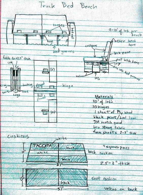

    Hey all. Looks like this is gunna be my first project this summer. All i have so far is the "blueprints" if u wanna call a math class doodle that. Basically the wood work is mainly gunna be 1x6's and 3/4" plywood. My cousin is gunna make the cushion covers with a big fabric tacoma logo on one of the backrests and a white stripe across both backrests. There are gunna be four individual cushions so i can take them out from one side, fold down the backrest on that side and use it as a table if I want. The back rests will just rest against the front bed rail i guess. The whole bench can be set up in front of the tailgate facing forward, but it would be more reclined. The 1x6's underneath the seat will fit into those little grooves in the bed walls. The whole wood frame is gunna fold up into a 28x18x7" package which should fit nicely in my AC. I'll probably cover the wood part with bed liner to match my bed. The two side legs fold towards the walls when you fold up the bench. The two backrests fold down onto the seat, and the seats fold down to the support in the middle. Hopefully this little scetch is fairly understandable. Lemme know what u think. Any design flaws etc. :)

    Just one question, what's the purpose? Camping, hunting? Seems like a decent enough idea, just make sure you have room for the cooler to be close by when the seats are mounted!

    just for tailgating or whatever. It wont be permanently mounted. I'll be able to fold it up and put in in the back of my AC. Right now i have two beach chairs in the back and they take up more room than i would like. This design would be a bit more compact and...comfortable

    I like it, it'll be great for tailgating! Maybe some cup holders cut into the bench somewhere? Or you could find a way to use the bed rail system to mount a cup holder nearby.

    hmmm thats a good idea. Well, where the bench is gunna sit right now, the front ent of the seat part will end right over the wheel wells, so they're in the perfect place to act as a little drink table or whatever. But now that i think about it, if i make little rings that can attach to the tie down cleats or something, it would be even better so i don't accidentally hit the drink with my leg.
