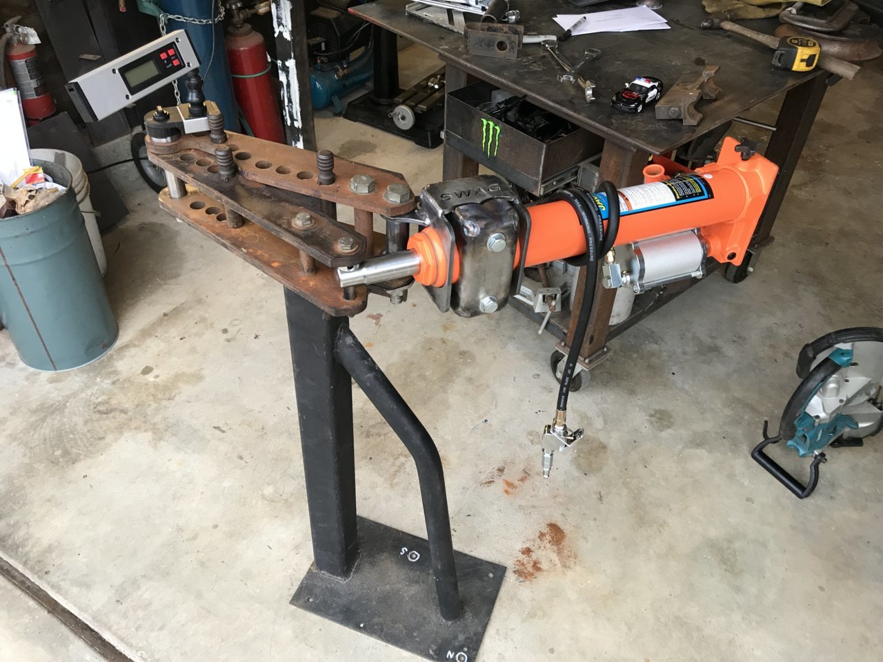

    It's a nice build man. I'm now looking at those JD Squared benders you mentioned. which one did you use?

    I use the model 3 with a Swag Off road bracket to hold a Harbor Freight 8ton air over hydraulic ram. 689EED01-6AB5-4AC7-B763-ADA6916CA3DD.jpg

    pretty slick set up, did you use the JD dies for it?

    Yes

    Very nice job on the rack OP. It looks very nice. For those interested in a tubing bender. JD2 is very good quality. I too run the JD2 model 3 with the swag bracket and harbor freight air over hydro ram. Really can’t beat it. NASCAR tube chassis are built using JD2 benders so I think we’re in good hands with these benders

    Thank you and you can’t beat those benders. It’s all I’ve used and there well built.

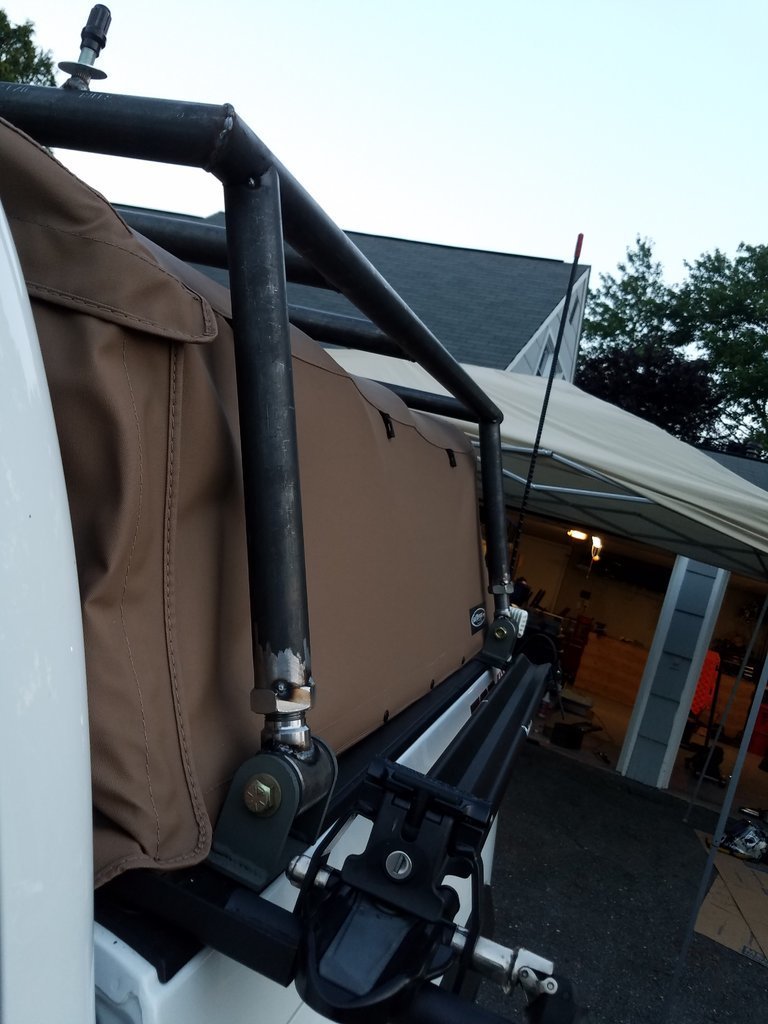

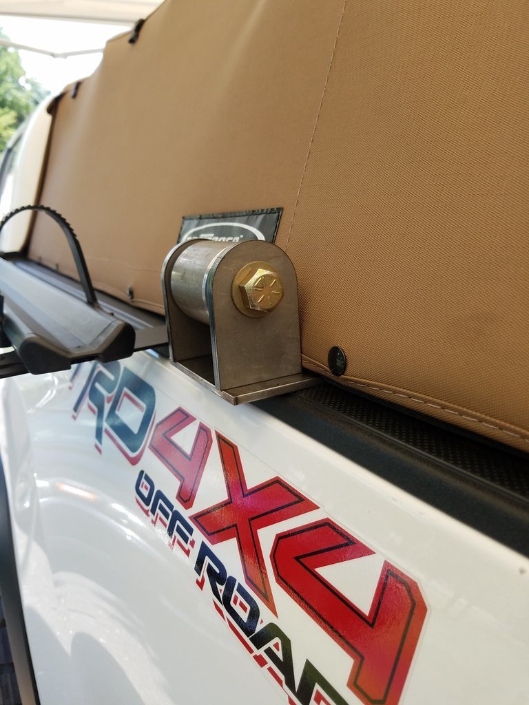

  16. May 13, 2018 at 8:51 PM
    #56
    90yota
    90yota Instagram: 90_yota
    Apr 13, 2016
    #184183
    5,416
    Dixon, CA/Truckee,CA
    88 T4R / 15 F350
    Stock....ish
    Thanks man! Here are some pics
  17. May 13, 2018 at 8:58 PM
    #57
    DrWeld
    DrWeld [OP] Well-Known Member
    Apr 5, 2018
    #249461
    101
    Southern CA
    '18 Cement Off Road
    2” Bilstein shock lift in front
    Real nice man. I like how you were able to get it to go over the canvas top. Good work.

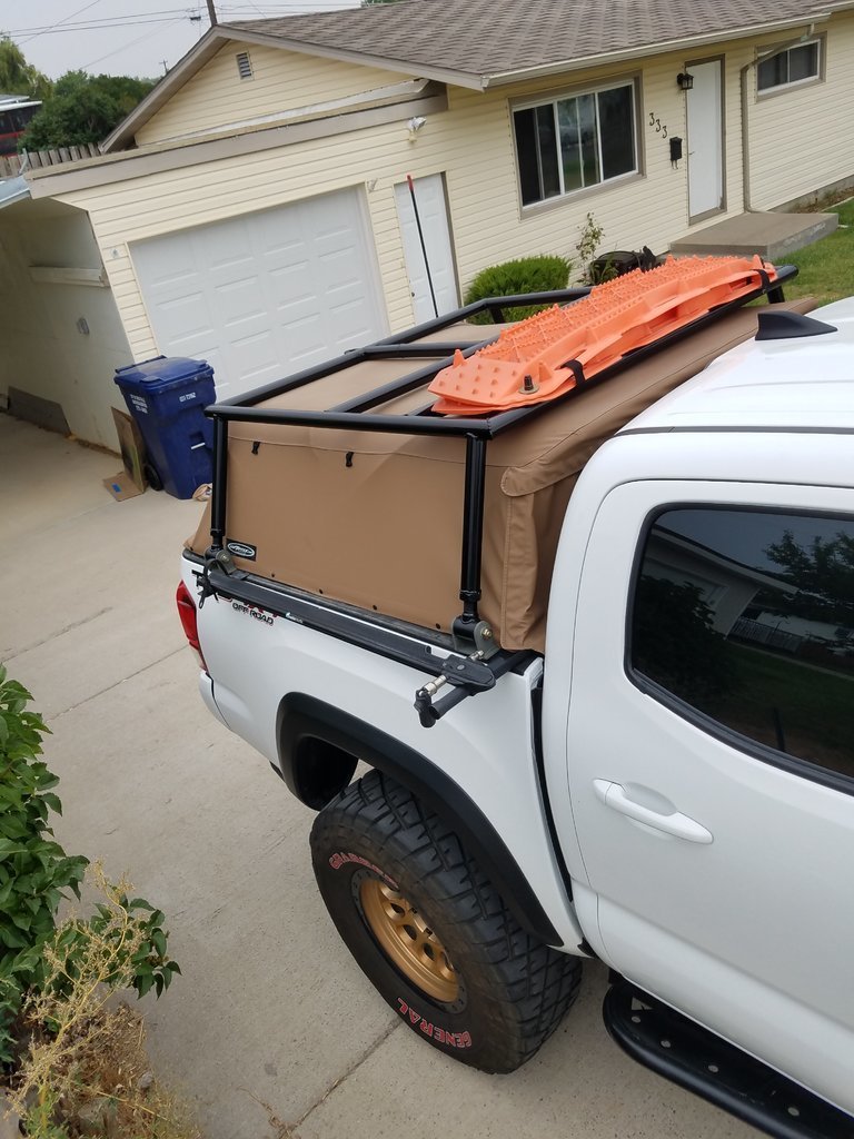

  19. May 13, 2018 at 9:01 PM
    #59
    90yota
    Apr 13, 2016
    #184183
    5,416
    88 T4R / 15 F350
    Stock....ish
    Thanks man!! Yeah it wasn't fun though haha. It was tough making it fit. Especially since I've never welded or fabricated in my life. I just went to harbor freight and got tube notcher to make it work. Also got the welder for a hell of a deal on craigslist. Pretty happy with it.
    DrWeld[QUOTED][OP] likes this.
  20. May 13, 2018 at 9:04 PM
