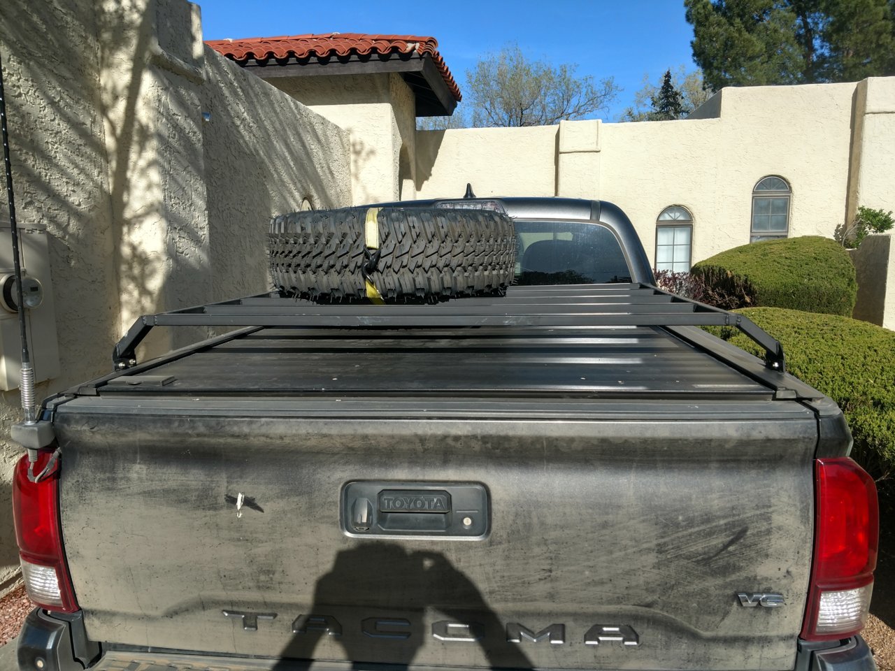

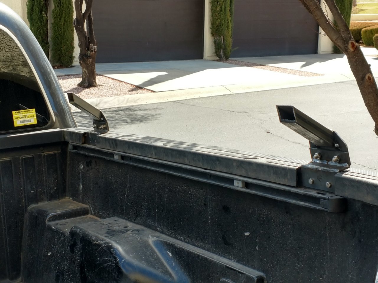

    Interesting mount idea. Mine was much more simple...

    And finished product, wanted something low profile and allows me to use my roll cover.

    Interesting idea! Looks good!

    Thanks. I like how you mounted yours though. Does it have rubber isolators? I bet that would help with vibration.

    It has bushings so yeah. No vibes at all.:thumbsup:

    +1 on the jd2 benders.
    I run a model 32. Have yet to add hyd but I bet it makes a world of difference with repeatability.
    Beautiful rack @DrWeld
    Do you know how much it weighs? Also what Diam tubing? 1.750 is my guess.
    @90yota got any more info on that canvass cover and it’s frame you’d care to share?

    I haven’t weighed it yet but my guess would be just over 100lbs. It’s made with 1-1/2”

    Yeah it's made by softopper. Check them out! I love mine. The frame around it I built with 1.75 .120 dom. It's really heavy but strong. The weakest link is the bed rails

    Wow, talking about a heavy duty rack. If the rails were strong enough you could put a couple Tacoma's on that rack! :thumbsup:
