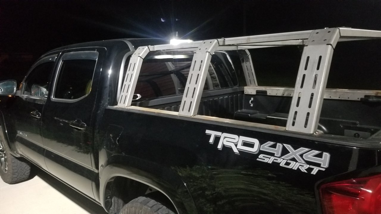

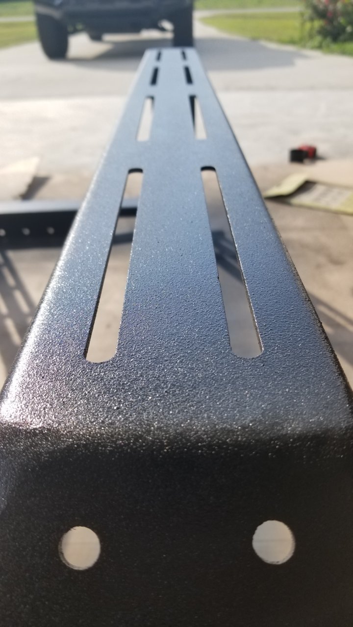

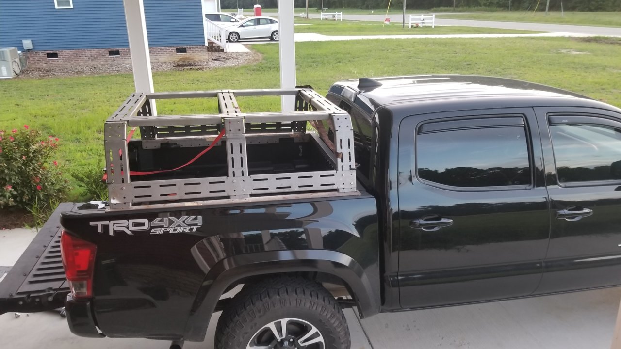

    Finally got around to cutting out and bending my bed rack! Stoked with how it came out! I just need to finish welding and then get it bedlined, I'll post the final pictures when it's done20180724_201624.jpg 20180724_201642.jpg 20180724_220047.jpg

    Looks great!
    This is not criticism, but just an honest question; Is there any reason to why you didn't make the rack go the full bed length? Any design constraints/function?

    It goes just about as far as it can go, it's the whole bed rail which is what it will mount to, I have to wait for the bedliner to cure and my t nuts to come in then it will be finished

    Also it gets to a funky bend and I didint feel like messing with all that haha we will see how it works out and then I might make some more if I get interest

    Ah, I see. I also wasn't accounting for the tailgate width... again, great work.

    that's alotta t-nuts...lol, nice job...

    It shouldn't take that many! I'm going to start with 4, and If I need to I might do 6. I accidentally ordered 10..so I might just use them all haha

    One question, though - why not make it a few inches taller so it would line up with a cab rack if someone wanted to carry ladders, longer kayaks, a canoe, whatever. Seems like it would be multifunctional and kill a couple of birds with one stone.

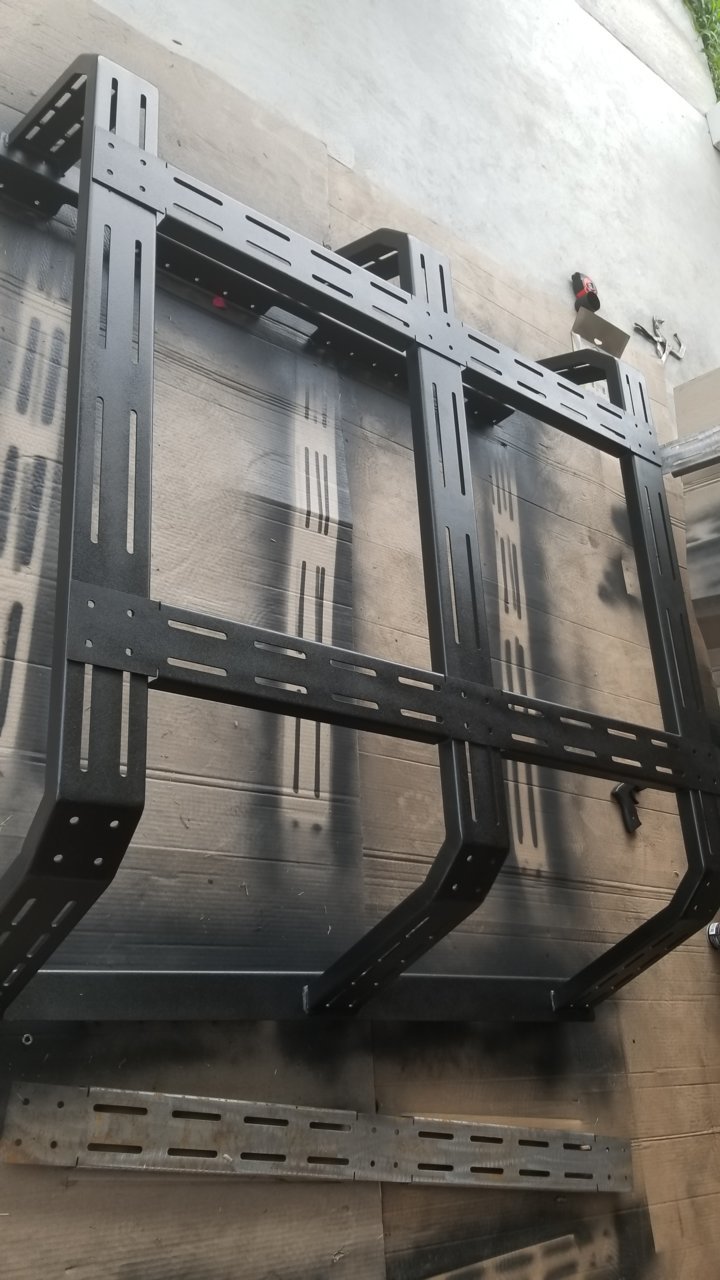

    What is that steel you used?

    My thought was an Overland rack, my dad said the same thing about the ladders, kayaks and things like that. The plan for this one is a roof top tent and eventually a prinsu cab rack on the cab so I was trying to make it look a little better with the tent without it going way over the cab. It wouldn't be hard to make something for a ladder or kayak though, I might do it if I need one

    10ga carbon steel

    I'm not even talking about your bed rack extending out over the cab - I mean just making yours as it is now, except a few inches taller. Then, if someone does add an OEM roof rack, the popular Prinsu, or whatever, this existing bed rack lines up with it.

    I see what you're saying now! I'll see if I can come up with something Like that!

    custom bent into a C channel it take it. Anyways, looks grreat
