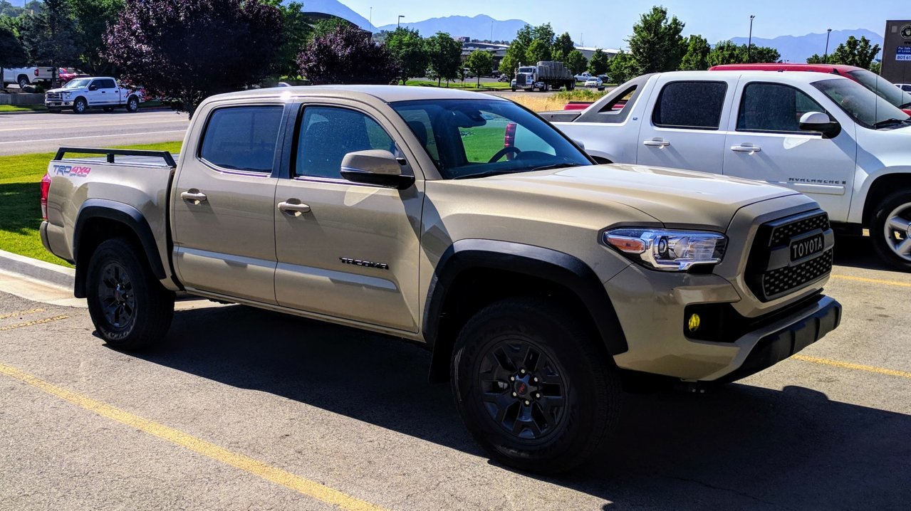

    Everyday look, just bedrails
    Another every day look

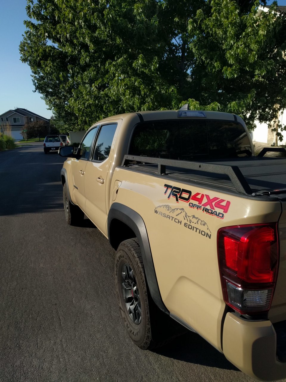

    Dual bike rig setup- I actually ended up making this bar flat across, and I leave it on 100% of the time (always carrying bikes), though it is removable. This is basically my personal "every day"

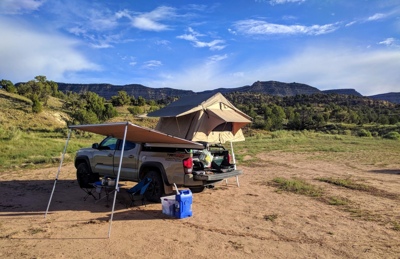

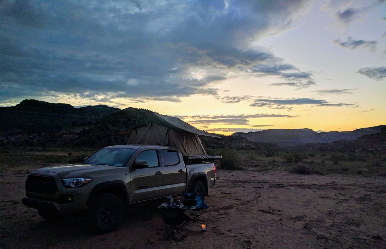

    Fully loaded with a bike, awning and rooftop tent ready for a trip! Took it offroading like this :)

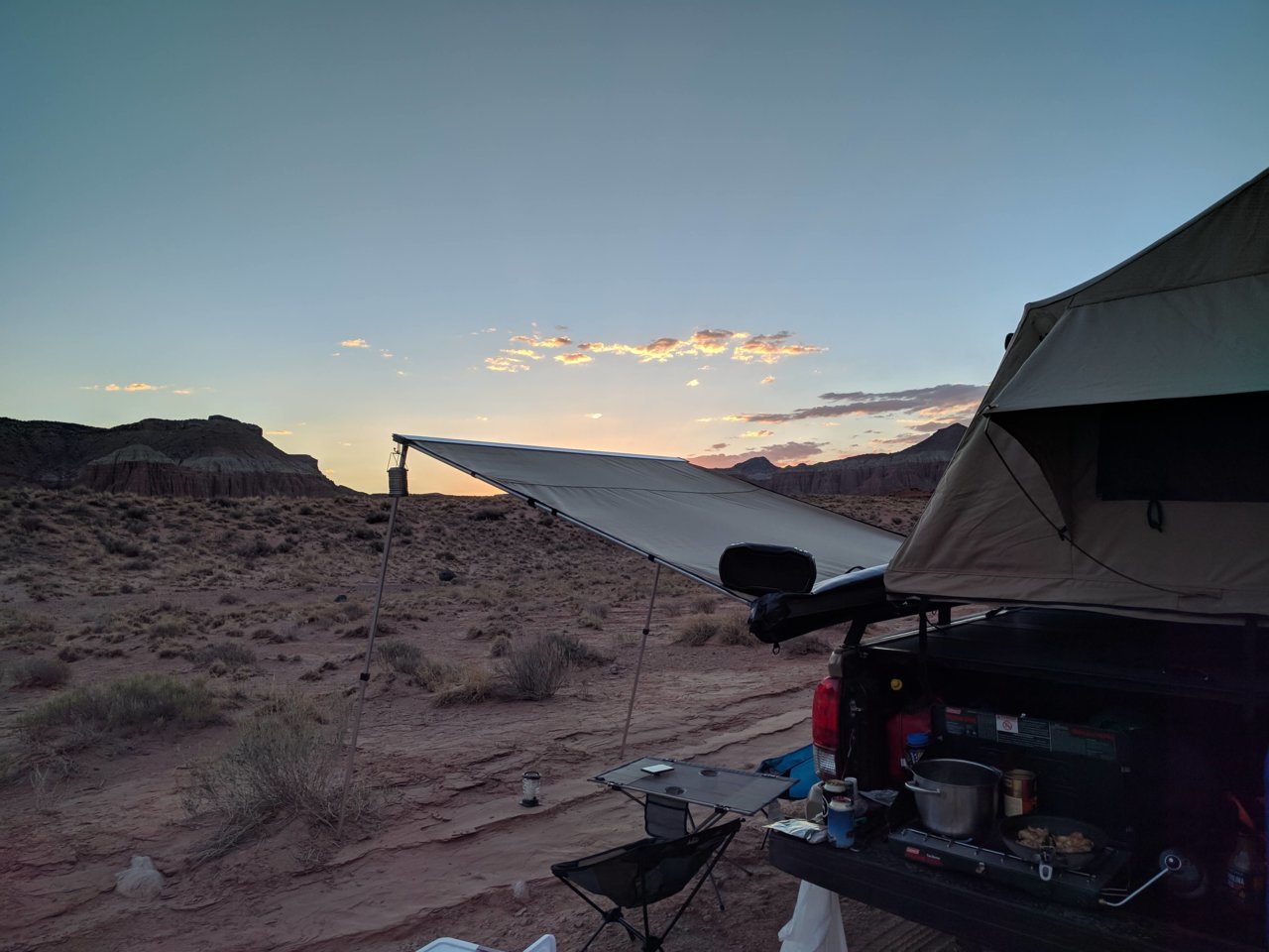

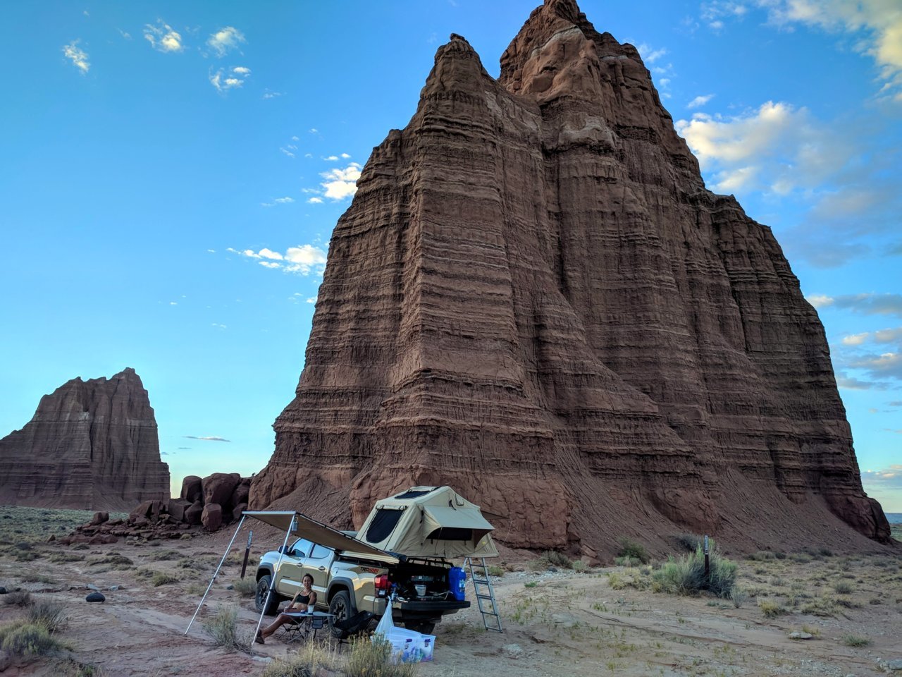

    Full tent / awning deployed- scenic background
    Another shot- different angle- of the tent / awning to show the tonneau, works as a great little shelf for the kitchen :)

    This is a great and simple set up. What tent/awning are you using? How is the awning mounted? Is it part of/attached to the tent or separate?
  7. Aug 23, 2018 at 5:58 PM
    mdiprimio
    mdiprimio [OP] Well-Known Member
    Apr 10, 2018
    #250022
    93
    2018 TRD OR 6MT Quicksand
    Blacked out grill / emblems Black lettering Color matched bumper caps BakFlip cover Subaru tweeters
    Thanks dude! I'm using the Smittybuilt 2P tent, and Smittybuilt awning.
    Awning is mounted on the 45deg risers leading up to the crossbars (part of the bar). I chose to mount it to these just because I had no mounting brackets for the awning (local classifieds find) but it had flexibility to mount a number of different ways.
    It is mounted separately from the tent (sometimes we don't bring it).
