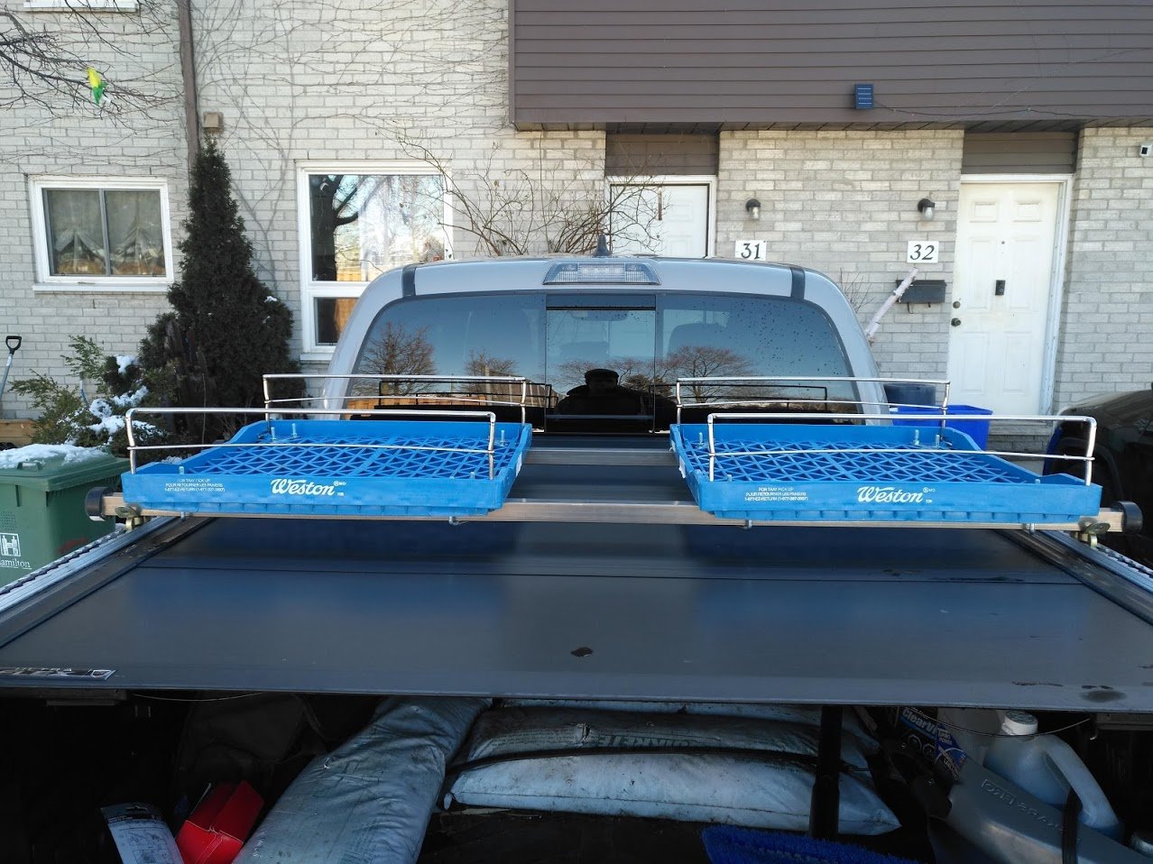

    wondering if you could make the voodoo rack work like this user Did and just bolt it directly to the bedside. or possibly fab up a stronger bracket from underneath the bedside for the voodoo rack. i don't really like the way the mx4 brackets create a floating rack look and can create a spot for water to get in.

    that’s pretty awesome. Did you mount the bracket to the top of the bedside using a similar rivnut method?

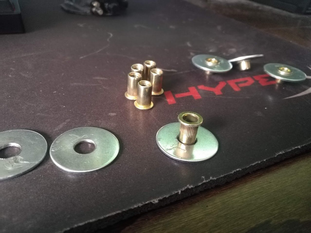

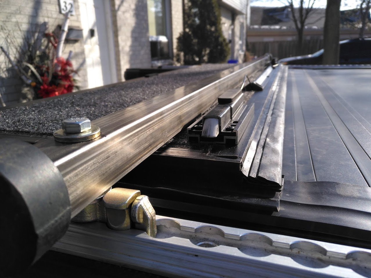

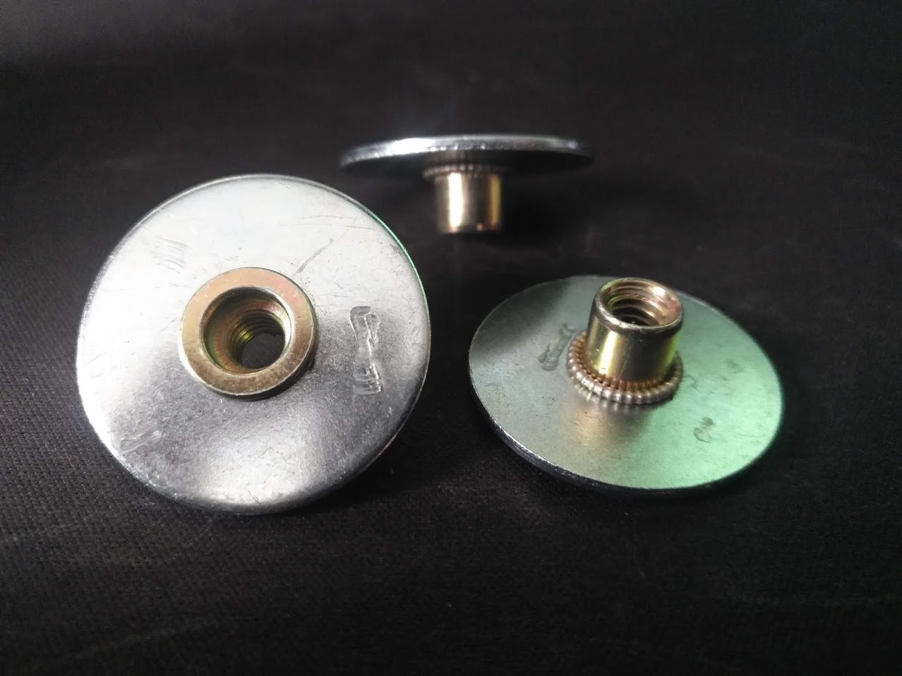

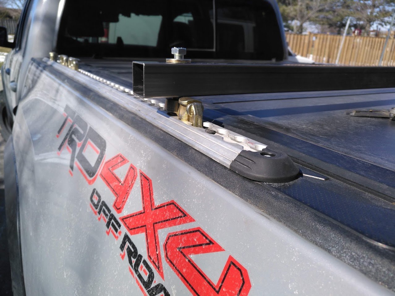

    I'm doing a write up about it now - procrastinated for far too long on actually making this, but sort of used rivnuts. just in a non traditional method.
    Used them with fender washers to give me as much surface area as i could get.
