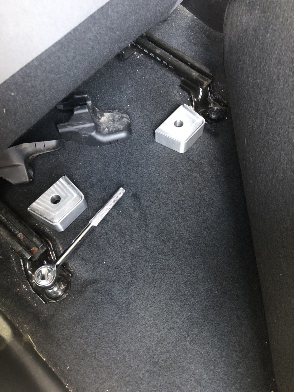

    For whatever reason, I am comfortable in the seats all day, but my wife was similar to you. She couldn't do it for more than a very short ride. Thankfully, she is good to go with the spacers.

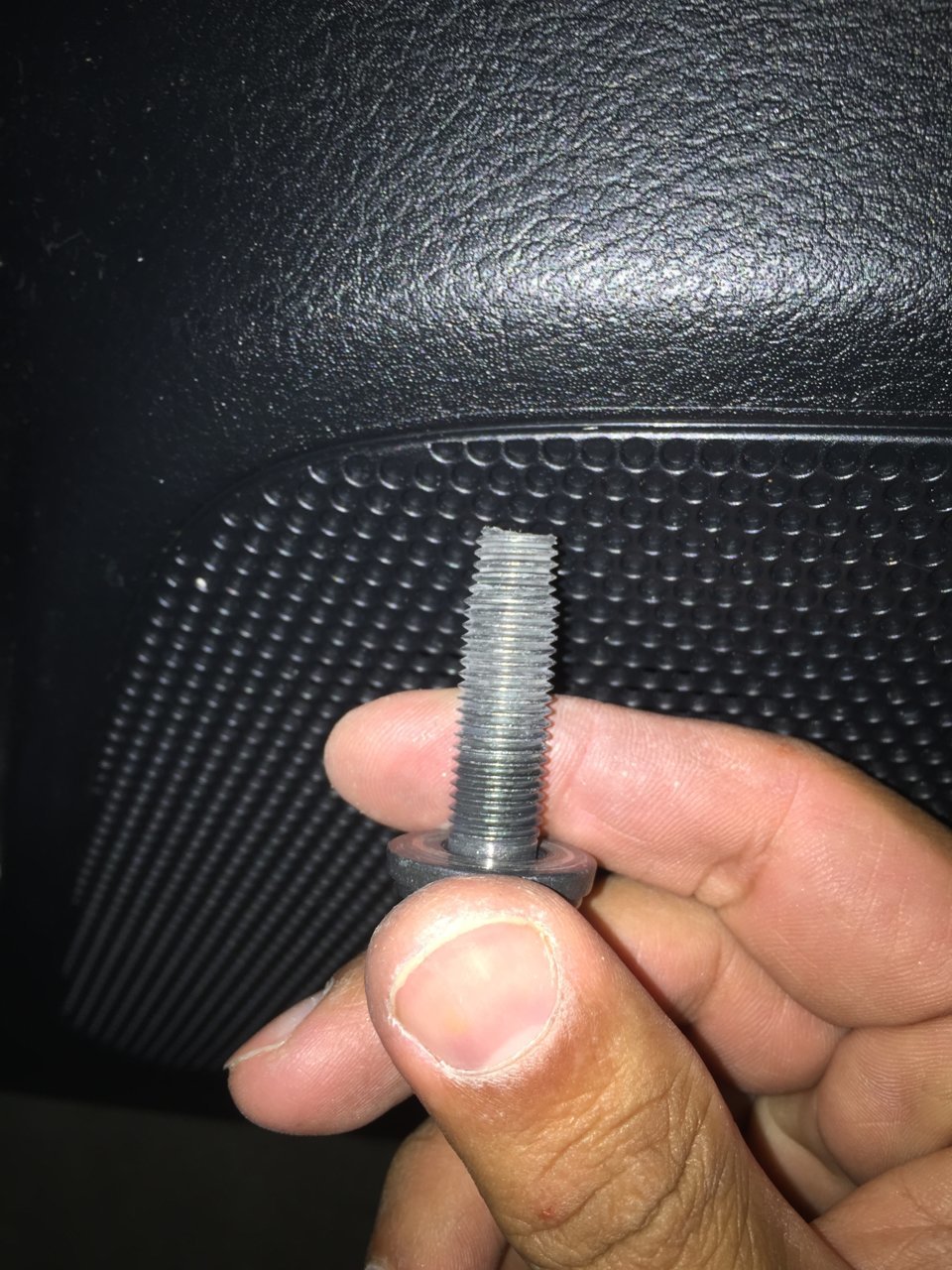

    My OEM bolts are narrower near the end... maybe that’s why one of the replacement bolts doesn’t want to go all the way in?
    I was able to torque the bolt down more, so now there’s only two washers in there. The thread of the bolt was only taking a beating in the region where the oem thread is reduced. So I think I should definitely be good now. I don’t think I’m cross-threaded at all. I’ll leave the spacers in for now.

    The taper on the original bolt is to help the factory installation with the powered tools they use. Most all of the bolts on the Taco are like that. It is a lead-in section that does prevent cross threading. It has no affect on the fit of the new bolts. The threads on the cab side are straight, not tapered.

    The hole might just not be fully tapped, and the tapered bolt might let it slide

    My oem bolts were really easy to take off.
    I took the spacers out. Gave them a little while to see if I would get used to them, but couldn’t.
