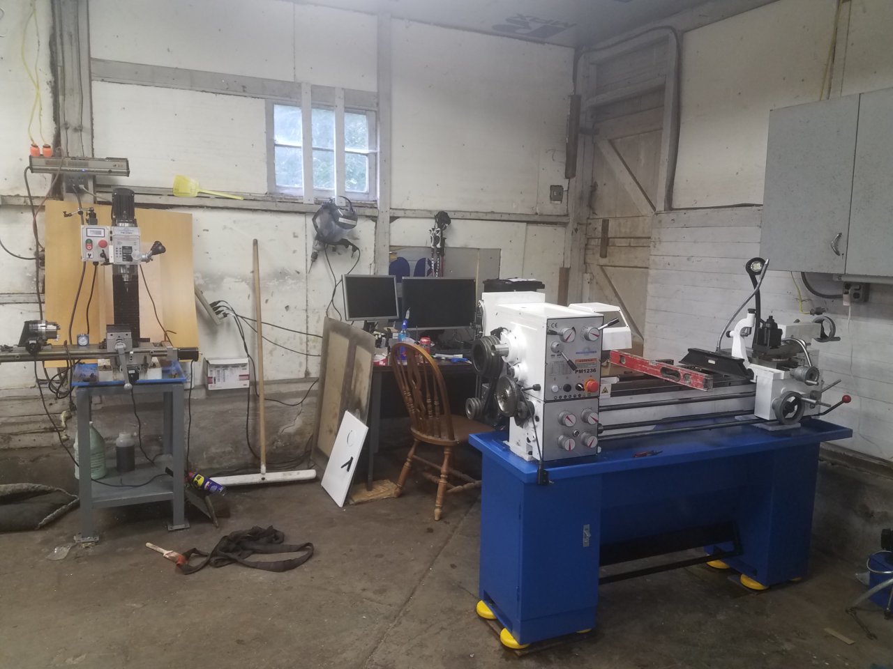

    As for the latest update, I have been taking my time trying to figure out placement for the lathe. It will end up about 90 degrees rotation from where I actually want it to be. After a few dry runs, my engine hoist just can't make the turn to put it where I want it. Most other lathes would not require such a turn, but this one has a foot brake that prevents me from being able to go straight at it. I could still try to put it where I prefer, but would have to disassemble my desk and shelving on either side of the lathe area for still a very high risk of installation failure. Instead of having a 6ft x 6ft square of empty space with my truck in the garage, I will only have about 2ft between the truck and end of the lathe. I still get a good deal of space, but rather than having that one open box, it becomes U shaped.
    Since deciding on that placement, I have sourced a 14"x14" x 1/2" thick steel plate to put under the LH side of the lathe stand. This will take up the bulk of the leveling just so I don't have to max out the 1/2" stroke of the supplied leveling pads.
    I have the stock China motor off as well (got the USA made Baldor motor upgrade, but it did not come installed). I still need to swap the pulley, so I'm going to try to get a loaner gear puller from Autozone if I can't find material to rig up a DIY contraption.
    The pulley is cast iron, and where the gear puller would concentrate its force is a rather uncomfortably thin wall. So, making something up myself to direct the forces to a stronger part of the pulley will be ideal believe it or not.
    If all goes well I will get it up onto the stand tonight!

    Quick sketches ...
    I prefer this,
    but will have to settle for this,

    Harbor freight has been instrumental in helping me set the shop up. They just opened a store near me about a year ago. In fact, I just grabbed their small 6x4 band saw for 20% off. People seem to love it, so why not?
    I ended up making a tool to help swap the motor pulleys, and finally got the lathe up on the stand today. Looks pretty level with a standard level, but the precision level next to it shows otherwise.
    Getting there, slowly but surely. Now I have to figure out where to run all of these wires.
