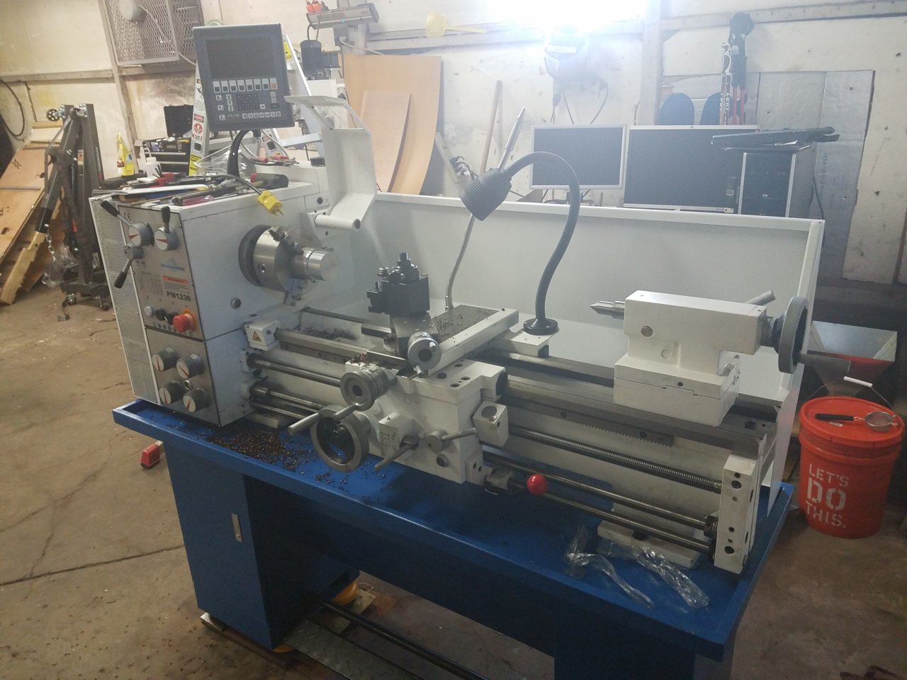

    Haha, I just broke down and called for help. When the motor arrived ... 1-8, and 4-5 were already joined together. This reflected the joined black dot diagram, but apparently you have to pull them apart and make the 4 connections (right diagram) under 4 wire nuts.

    Yikes! That was a disaster waiting to happen.
    At least the solution is easy, either the wires or the fast exit out the window.

    It's alive! Wired correctly now.

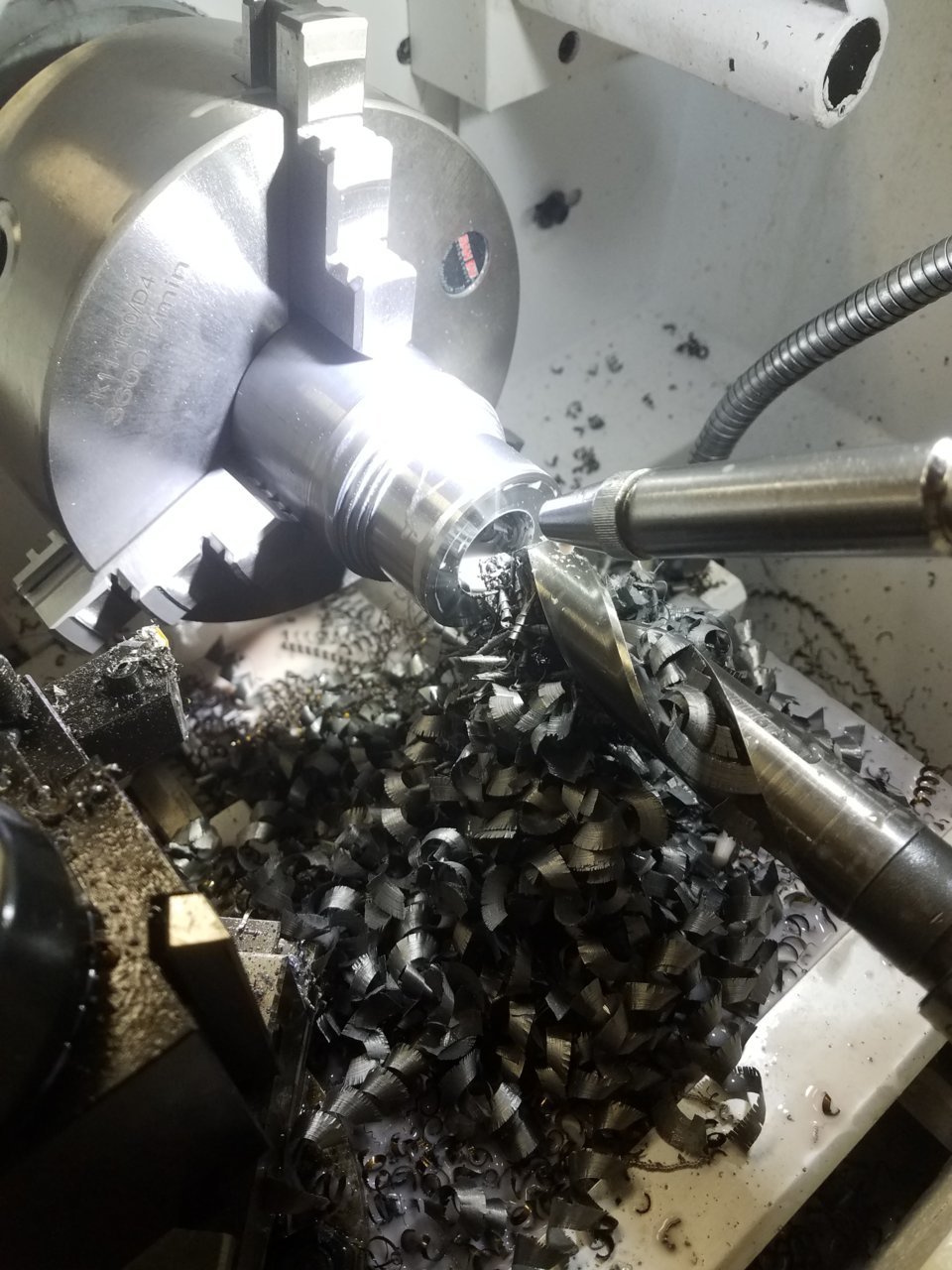

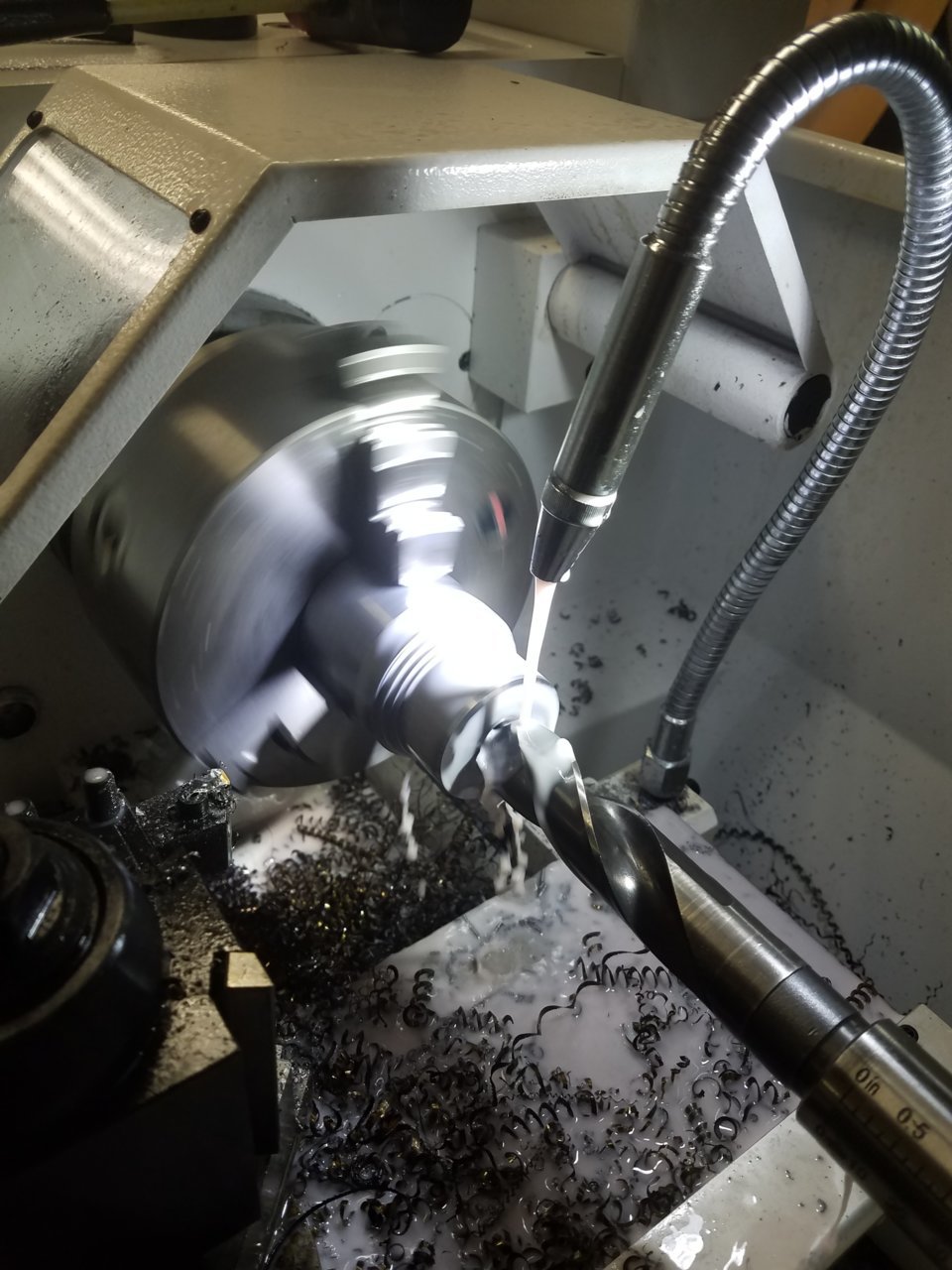

    Putting it through its paces.
    3.5" diameter 440C stainless.
    Picture above was .05 per side @450SFM/550RPM .008 IPR, no problem. This with negative rake tooling (higher cutting forces than positive rake). Went up to .1, and it cut no problem ... But stalled the spindle when the carbide insert was worn.
    The benefit of negative rake tooling is that the inserts can be double sided, and with a trigon insert shape each bit provides 6 cutting edges to its 3 tipped "positive" counterpart. So yeah, I'm happy this lathe is strong enough to drive the tooling that will save me a few bucks.
    I'll probably live in the .05 to .07 per side range(at least double that for aluminum and plastic, though), no need to abuse it ... That's plenty.
    Very happy with this lathe, as it is plenty strong for my needs.
    My only gripe would be the tailstock quill/ram. It could be bigger/more rigid for a lathe of this size.
    1" diameter twist drill @ 180RPM, cut like butter ... and I was able to feed it at a respectable rate as you can see by the chips. Pilot hole was 1/4".

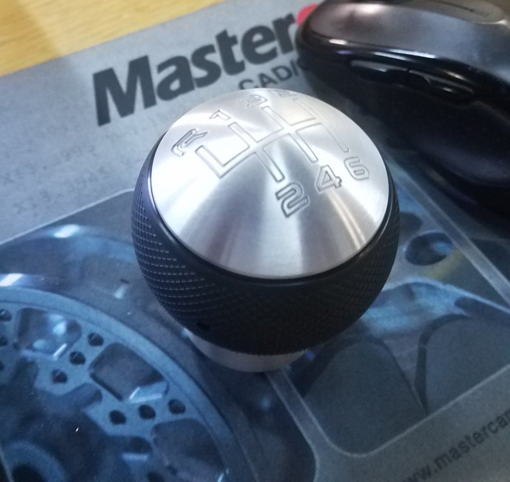

    Dood, just had a third Trailbreaker knob in my hands today. Al hybrid delrin ring lol...small world !
    What's your career status, I lost track. Did you stay at your old job?

    @Natnewt 's knob, I'm guessing?
    I basically got a counter offer that I couldn't refuse from my original job, so yeah ... I stayed put in a different position. I still do the programming, but now my manager is at corporate HQ.

    You would indeed be correct!

    I wasn't overly comfortable with my knob in his hand though :D
