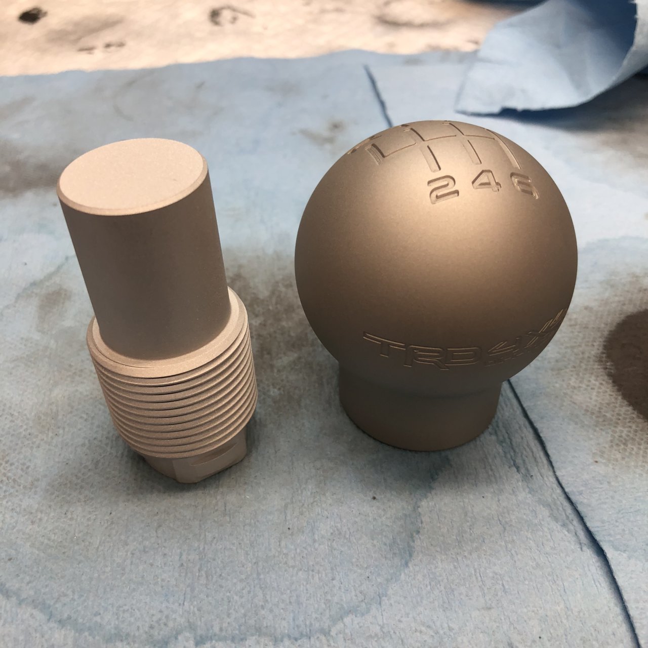

    It's a pretty fine pitch thread, and there isn't much tolerance to work with. Even though I cut them on the high end of the tolerance I just don't think it's enough to accept coating.

    Cerakote is a few thou. I doubt it's that, maybe OP cuts threads with super high precision.

    Another theory I have, is cerakoting over the Teflon insert. It may have flaked off from there when it was tightened. Or, there was some debris in there. Possibly coated over blast media?
    All we can do is speculate until we get more info, really.
    Still, best practice is always to mask threads unless there is good reason not to. I would never introduce more potential opportunities for failure unless the reward was worth the risk.

    No debris in there that I’m aware of. Also nothing was coated over the blast media. Everything was stripped down to the max before application. Maybe the threading got cross threaded somehow. Does the inner core have reverse threading? I can turn it a tiny bit left and right and that’s it.

    All threads are right handed.

    Did you directly blast the threads(part pictured on the left?) If so, wouldn't have blasted them.. I've done that to threads presviously and it just galled them up trying to thread in.

    I didn’t apply it, a buddy did. His work is second to none though so i imagine he didn’t do anything he should have. I have a variety of threaded items coated before including some super tight tolerance areas by him with no issues. I was able to screw the inner core into the knob
    No problem several times before installing it.
