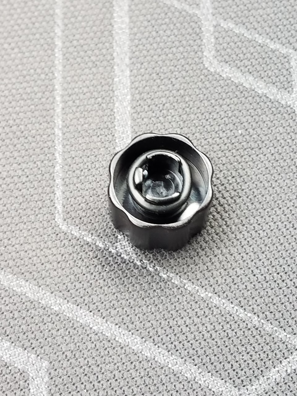

    Yeah, much different from mine so I'd need help. Is there like a V-groove on the post or something that those clips on the inside are catching on?

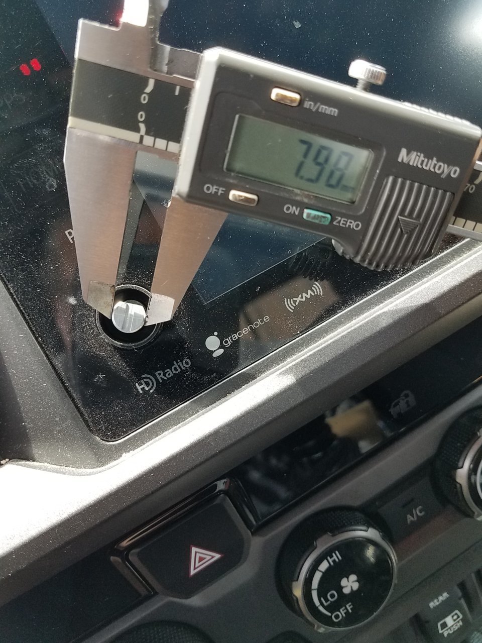

    Yeah, so I think a universal design which works for etune 2 will work for etune 1 as well, unless the diameter is truly different? Do you and Tony have micrometers? mine is junk but I do still have my old radio.

    I think there might be. I'll get angled shots later. But with the existing aluminum mod knobs out there, you can get by without them? Just a good fit to the post. There's no pull functions on the my head unit. Only rotation and push.

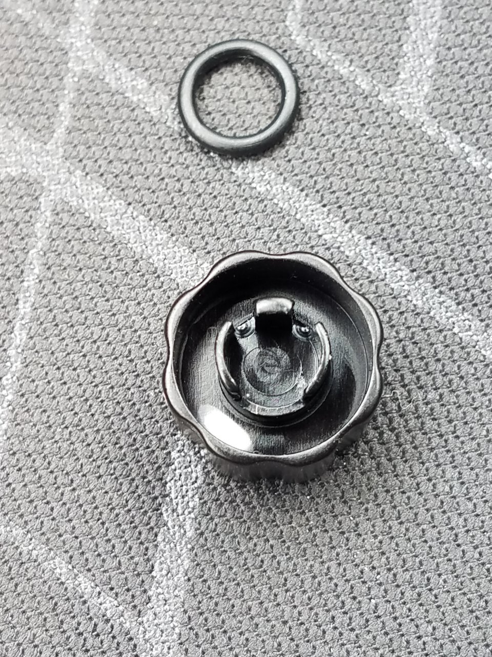

    These are Hondo knobs, that were a TWSS gift
    Theirs has a O-ring on the backside. Would be willing to forward my OE's to Rick, if that helps

    Looks like a job for a rotary broach, probably a standard 8mm D shape bit. That's if I decide to machine it and not print.

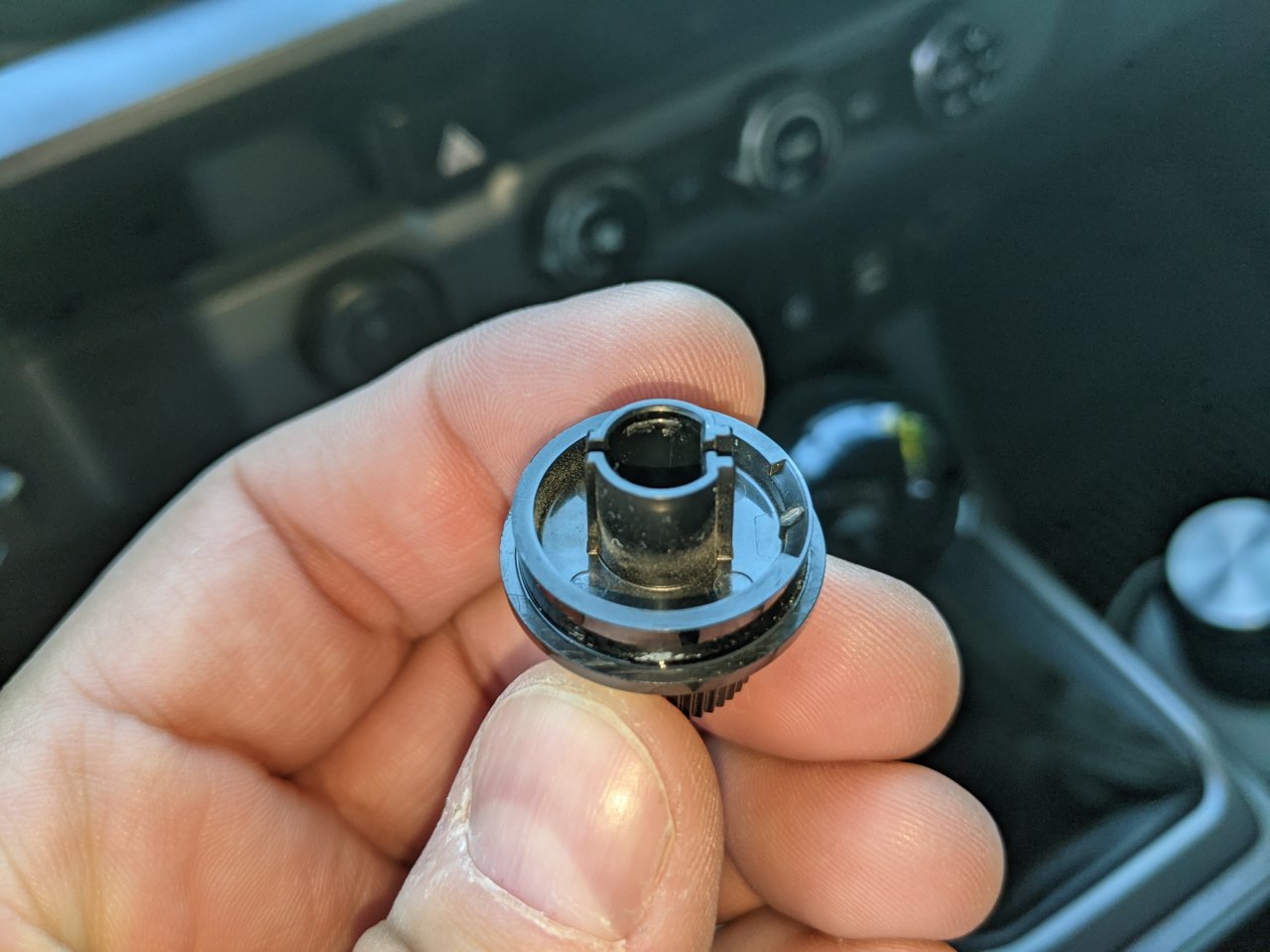

    There is a small nub on the knob, but I think a good post fit won't need to worry.
