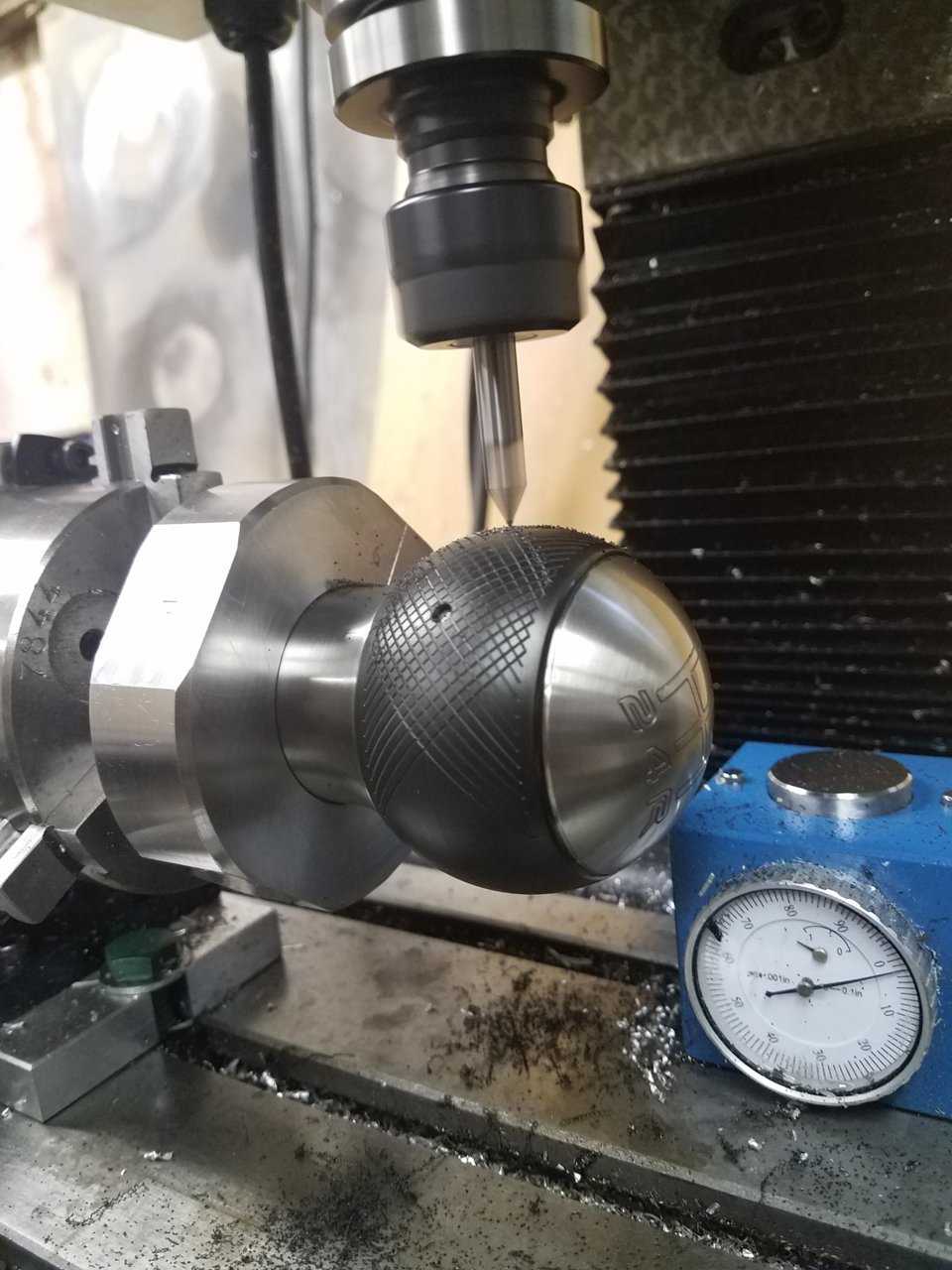

    For now, I'll put a perfectly good knob in danger again to "knurl" it. I just couldn't quit this feature.

    If ya squint, it could be escher-esque. Actual, Escher was all about math in his art. The knurl is the product of an algo, so...
    Very nice Rick!

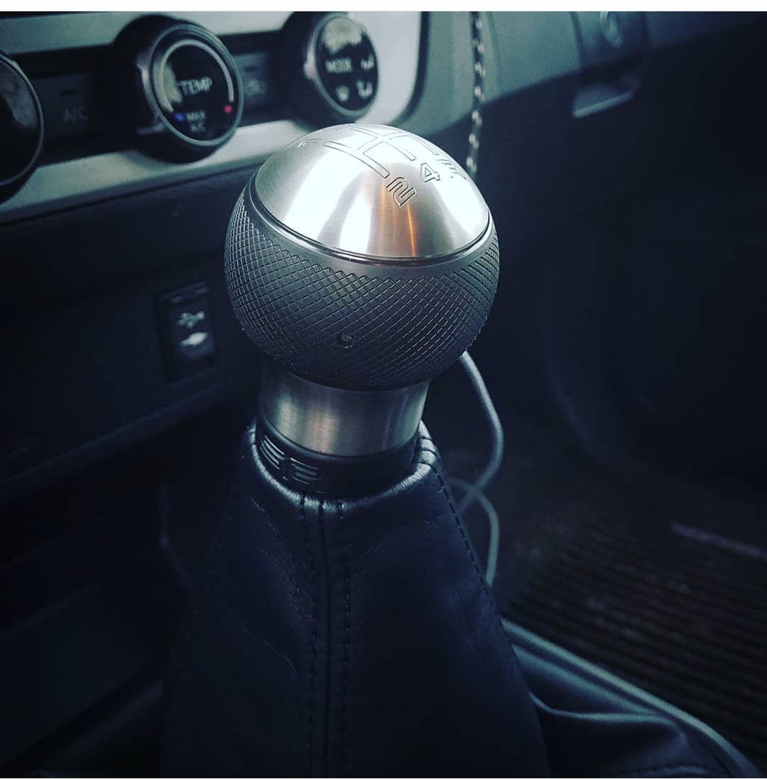

    Dropped back in now that my internet is up and running. Still love my knob and it still looks great. How much does one of those little lathes cost, anyway?
