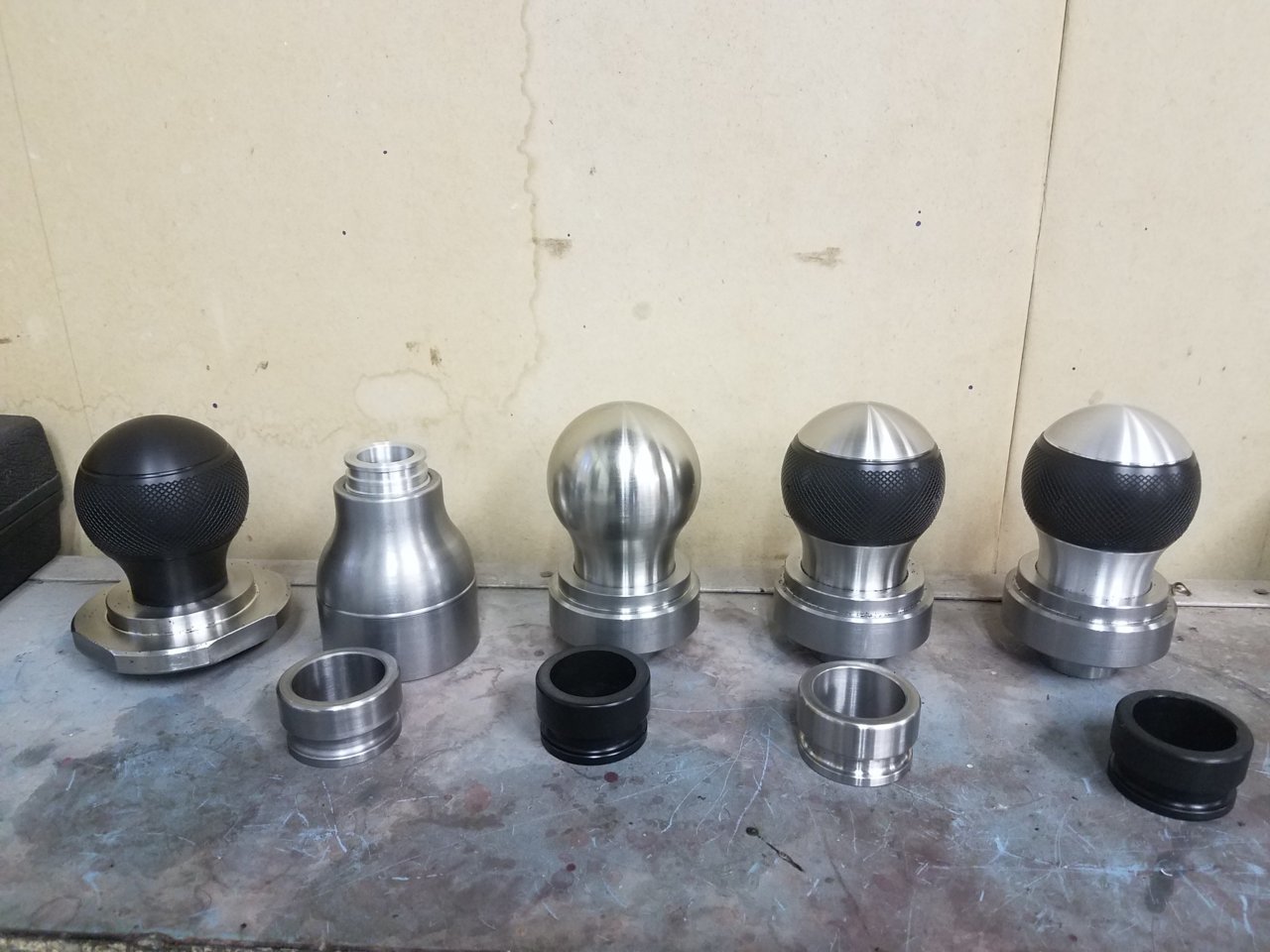

    7r41lbr34k3r [OP] Practitioner of the mechanical arts.

  6. Dec 2, 2018 at 1:58 PM
    #966
    7r41lbr34k3r
    Sep 6, 2016
    #196549
    3,090
    Houston, TX
    '21 Tundra 1794 OR
    3wk progress. Top engraving and a few final collar processes, and that's it.
    Slightly behind, but each knob will have its own fixture now, should be able to move much more efficiently.
    #2 is for a VW, need to get an M12x1.5 fixture bolt before I can go any farther. Thought I had one, but I do not.
    dirty deeds, jjam, TD90S and 4 others like this.

  16. Dec 4, 2018 at 6:50 PM
    #976
    7r41lbr34k3r
    Sep 6, 2016
    #196549
    3,090
    Houston, TX
    '21 Tundra 1794 OR
    These are shipping tomorrow.
    jjam, Beemaster, tonered and 2 others like this.

  19. Dec 5, 2018 at 2:42 AM
    #979
    7r41lbr34k3r
    Sep 6, 2016
    #196549
    3,090
    Houston, TX
    '21 Tundra 1794 OR
    Naww, yours isn't finished yet and will look like the one the far right in the above pic when complete (with the different boot connection, though). 3rd from left is stainless, and I have you down for aluminum w/ pocketed shift pattern.
