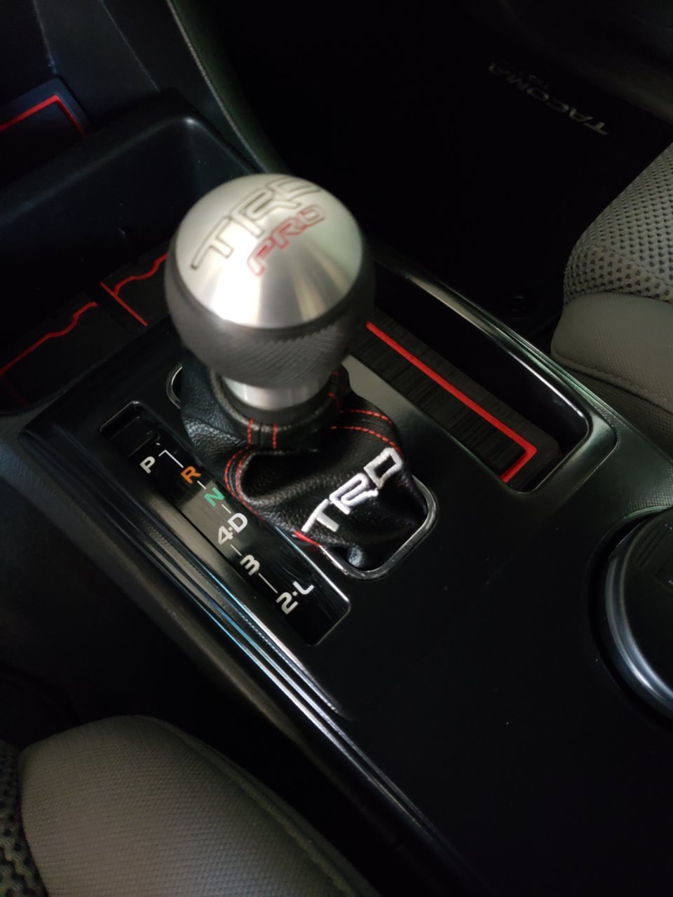

    So where do the shims go? Just on top of the threaded shaft? Cut them into small pieces?

    You got it, there's an installation link on page one.

    Can this be disassembled to facilitate removal of shims that are jammed inside? :frusty:

    I haven't had to perform such an operation yet. I'm guessing that you have a bit more up there than you desire to line up your pattern.
    I would find a long pick, with pointy end. Sharp like needle sharp point, to try to fish out the shim of undesirability. Just dig in there like ear wax, dig it out

    It seems like the shim is wedged in a way that the knob will not catch on the threads

    How large is the shim that you interceded with?

    I think i cut it a little too big. I had one in there and went to add another and i guess i cut it too big

    Ya, you want to cut it to inside the outer diameter of the shift rod thread diameter. The shims are only there to properly orient the engraving if any. So it's a compression configuration.
    Fish that on out and try again. There is a mathematical orientation to the colour of the shims. X degrees per shim depth
    Rick or Tony will set my ass straight if I'm wrong

    Which knob do you have? Taking it apart will be possible if it's a hybrid, but you may want to get some paper towels and prepare for a mess of anti seize lube.

    Its the V1 for an auto trans

    Definitely a hybrid then.
    Remove the two bolts holding the retainer on. Set aside the retainer, but put the bolts back in about half to 3/4 if the way and use those to unscrew the core.
    At that point the shims will be much easier to get out. First post has an exploded parts view to help show what is going on inside.

    Ok ill give that a try thnx

    Got the shims out. Starting back at square one now lol
