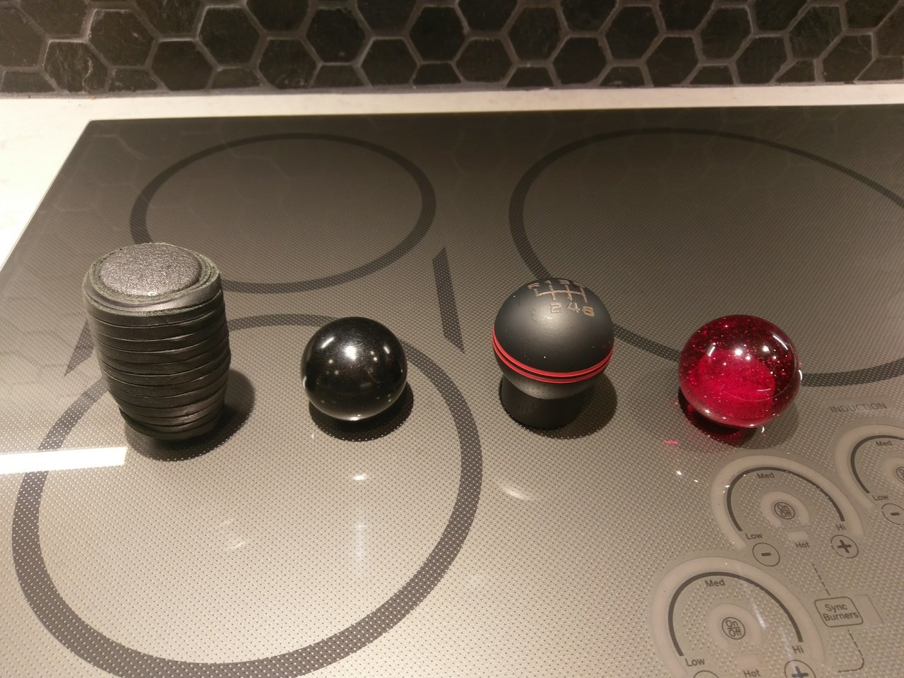

    just be like me and buy them all :p
    here's a few and there's more around here somewhere.
