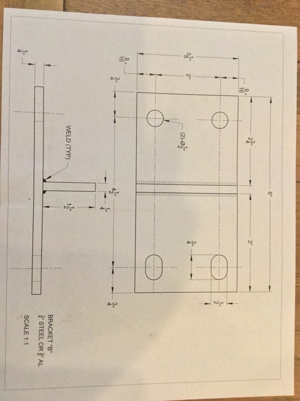

    Hi,
    Saw a post with a dimensioned sketch for a custom made bracket to install a low bed rack (similar to KB Voodoo or Billie Bars), been trying to find it for hours now-could somebody send/repost it?
    Thanks!

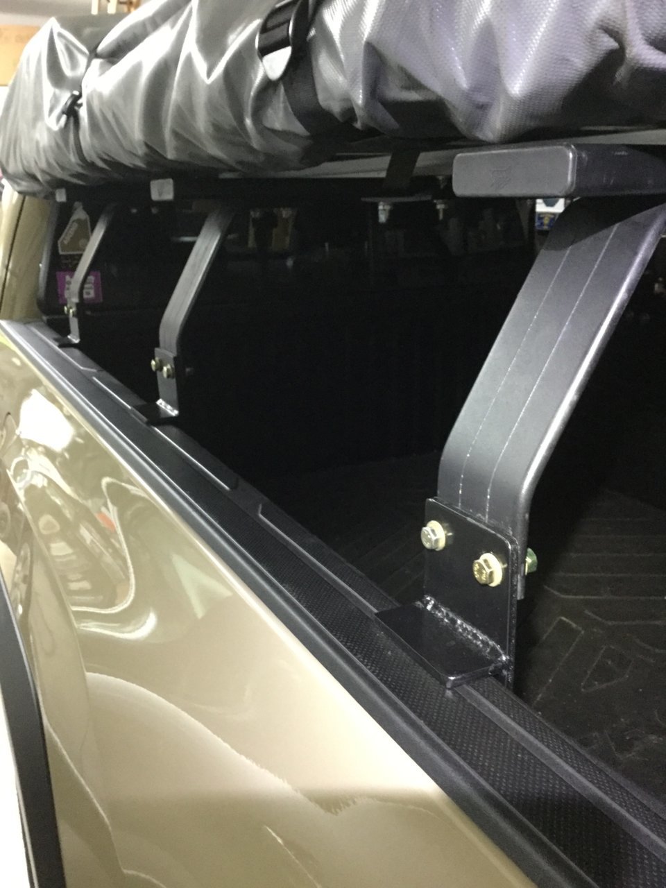

    Mine perhaps?

    Thanks! That should do it :)
