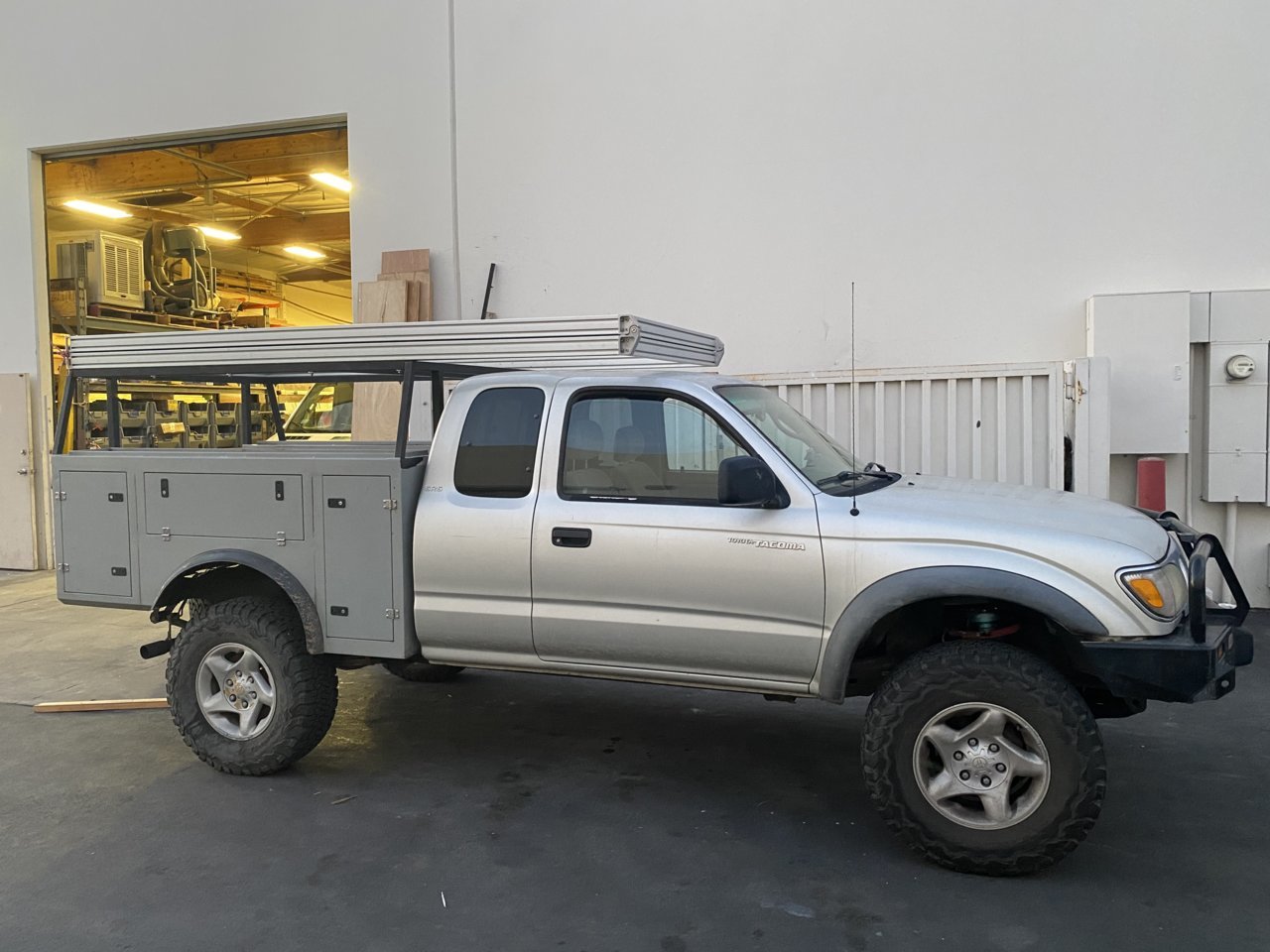

    Extended travel kings Jba uca's 33" tires Bora wheel spacers up front .75" Aluminum shell Modular camper build out
    So the plan is to build a gfc inspired wedge camper on top of what I've done so far.
    done so far:

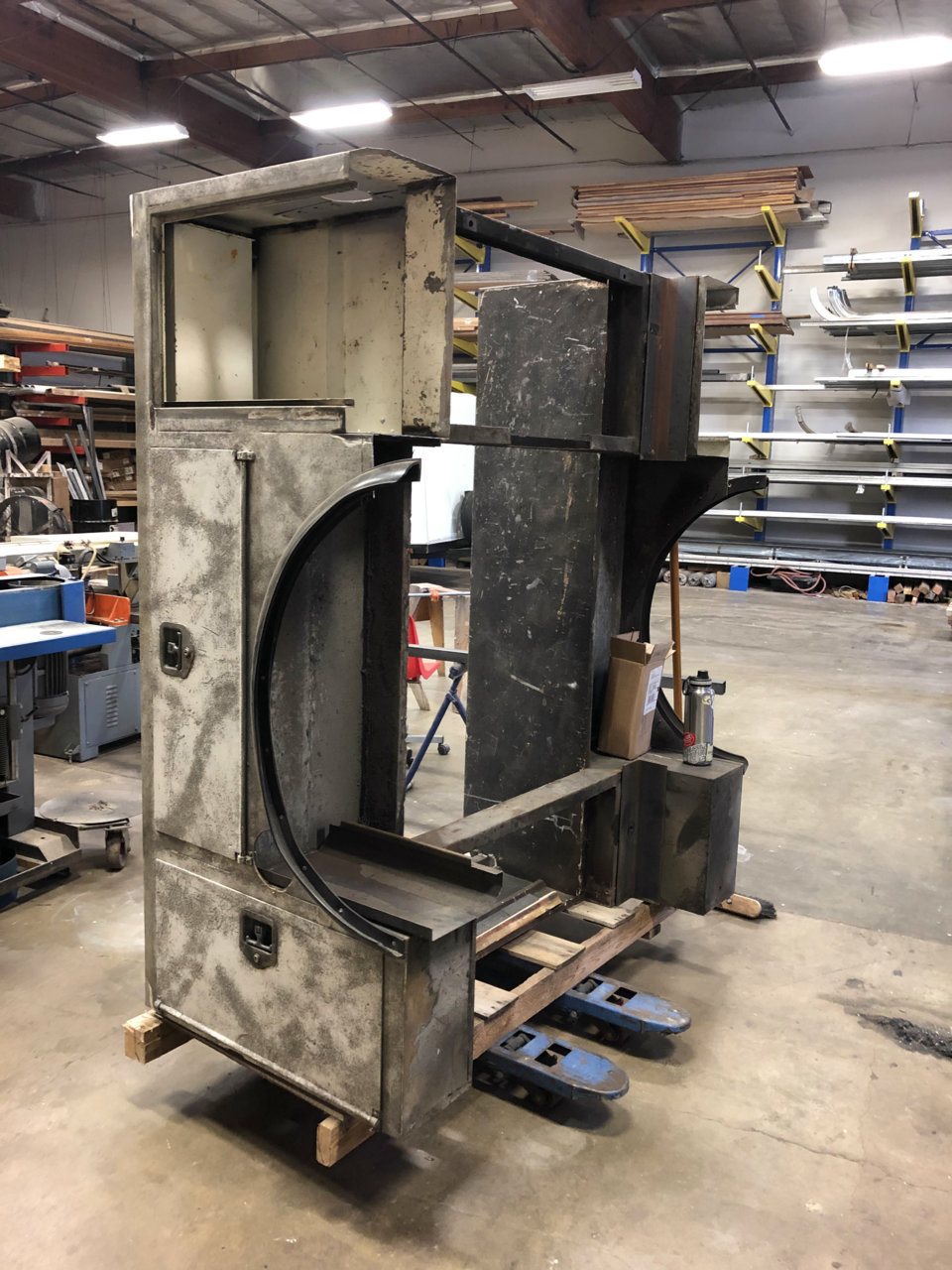

    -cut apart 90's pickup service body (got in over my head and it was basically like restoring a whole car haha)
    -cut out rust
    -bobbed rear compartments

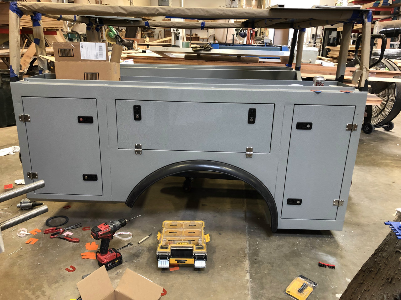

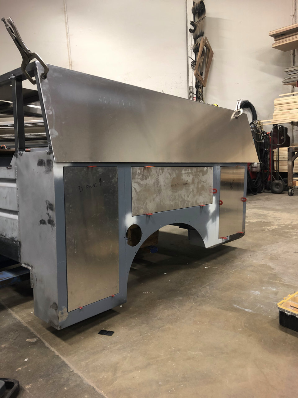

    -made all new aluminum compartment doors
    -all new door hinges and hardware
    -built new base frame for camper
    -replaced steel floor with aluminum tread plate
    -raptor lined entire service body inside and out
    still to come:
    -finish aluminum side flip up doors
    -build wedge camper using 8020 aluminum extrusions
    -order roof and floor material (plascore, same as gfc)
    -design and sew tent
    -re-install solar with atleast 100ah lithium house battery
    -a shit ton more...
    Other upgrades:
    -sua with custom deavers (for weight of bed/camper, will be set up as “mid travel”)
    -some bitchin shocks, longest I can fit under the service body
    -solo stock length lca’s
    -solo spindle and uniball conversion (when money permits haha)
    -sound deadening material throughout cab
    -re gear
    -33” or 34” tires
    -under bed fuel cell maybe 10 gallons since our tanks are tiny and nothing I’m doing will help mpg’s...
    how it started
    How it currently sits

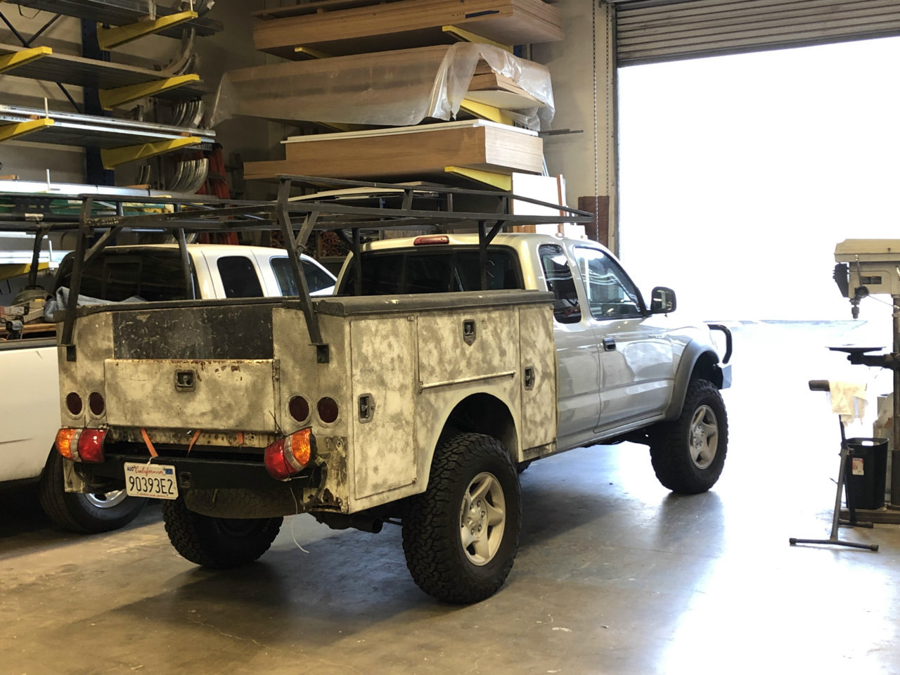

    roughly 420lbs how it sits now, heavier than I would have liked but it feels fine. Drives better and feels lighter than when I had a flip pack and the stock bed!

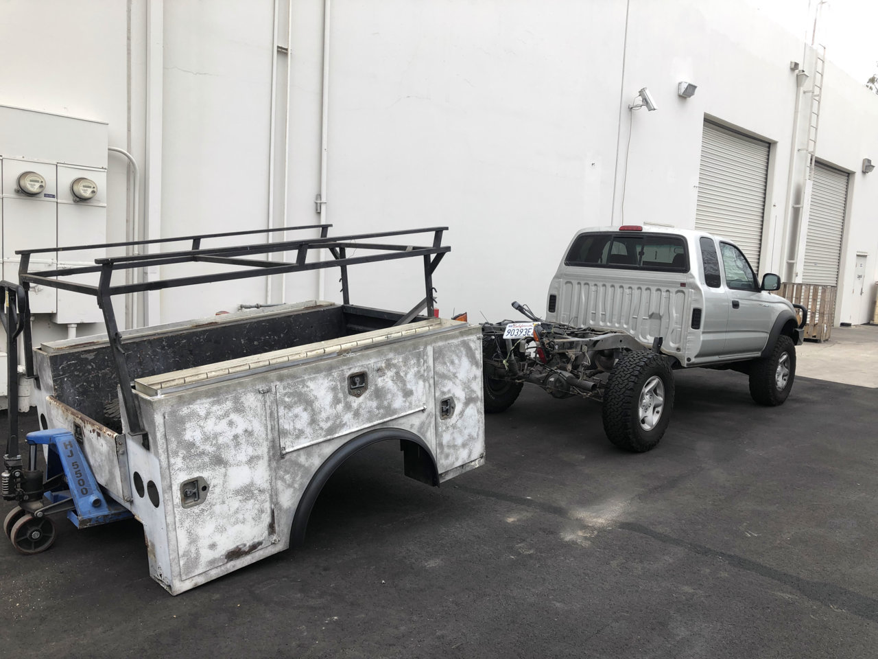

    That is awesome! Where did you find a utility bed? Thought about doing a flatbed, but need storage for work stuff.

    Craigslist, some guy had it on a 90’s pickup, took a little work to get it to fit properly but I was stoked!
