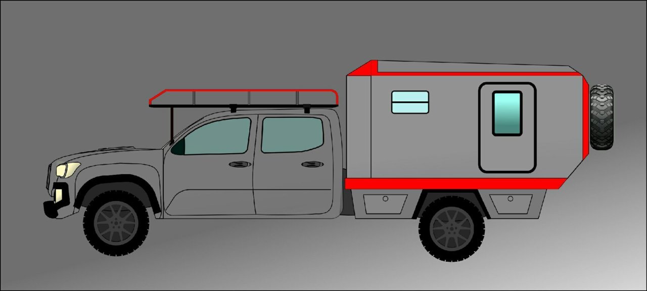

    Here is a rendering my builder did for me. So stoked!
    Some initial ideas on interior layout. Again the goals are interior working, lounging and cooking space.

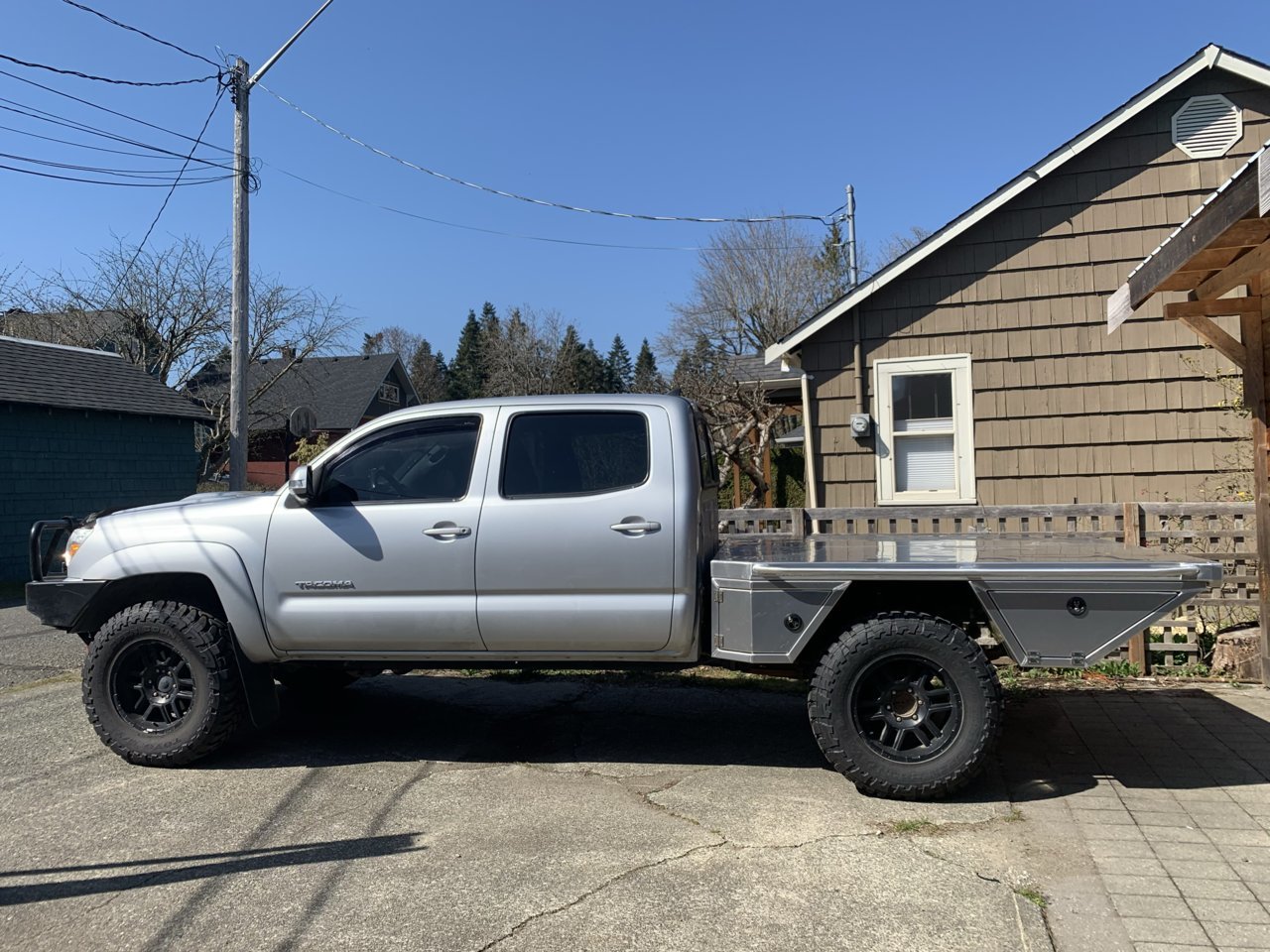

    Phase 1 is complete with the addition of the flatbed. I couldn’t be happier about it! What do you think? It is 6.5 ft wide and 7ft long. That will result in an inside camper space of 6.5 x 8 ft. I can work with that!

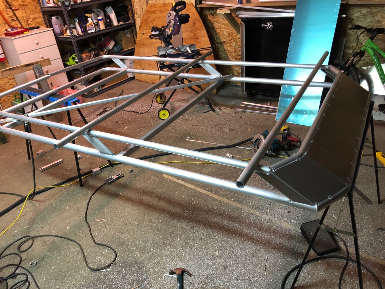

    Phase 2 of the build is the rack over the cab. It is in process...will include a sneak peak photo here. I am really stoked with how its turning out! Installation on deck for this weekend! Goal of the rack is to carry 8-9 kayaks, paddling gear (in a lockable storage box to be added at the back of the rack).
    Phase 3 will be the fabrication of the custom, pop top camper and a long range fuel tank to ride between the frame rails under the flatbed,

    That flat deck is beautie, did you make it?

    WarrenG, I did not build it. I had a friend build it. I wish I had those skills!! It’s built here on Vancouver Island, BC.

    Your friend is a craftsman in the truest sense. Very nice work.
