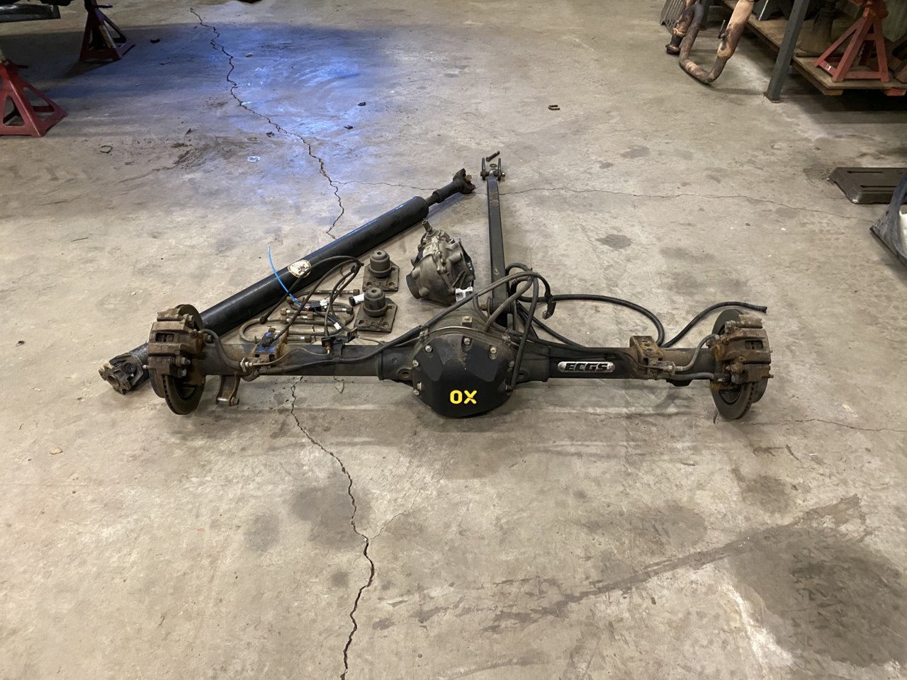

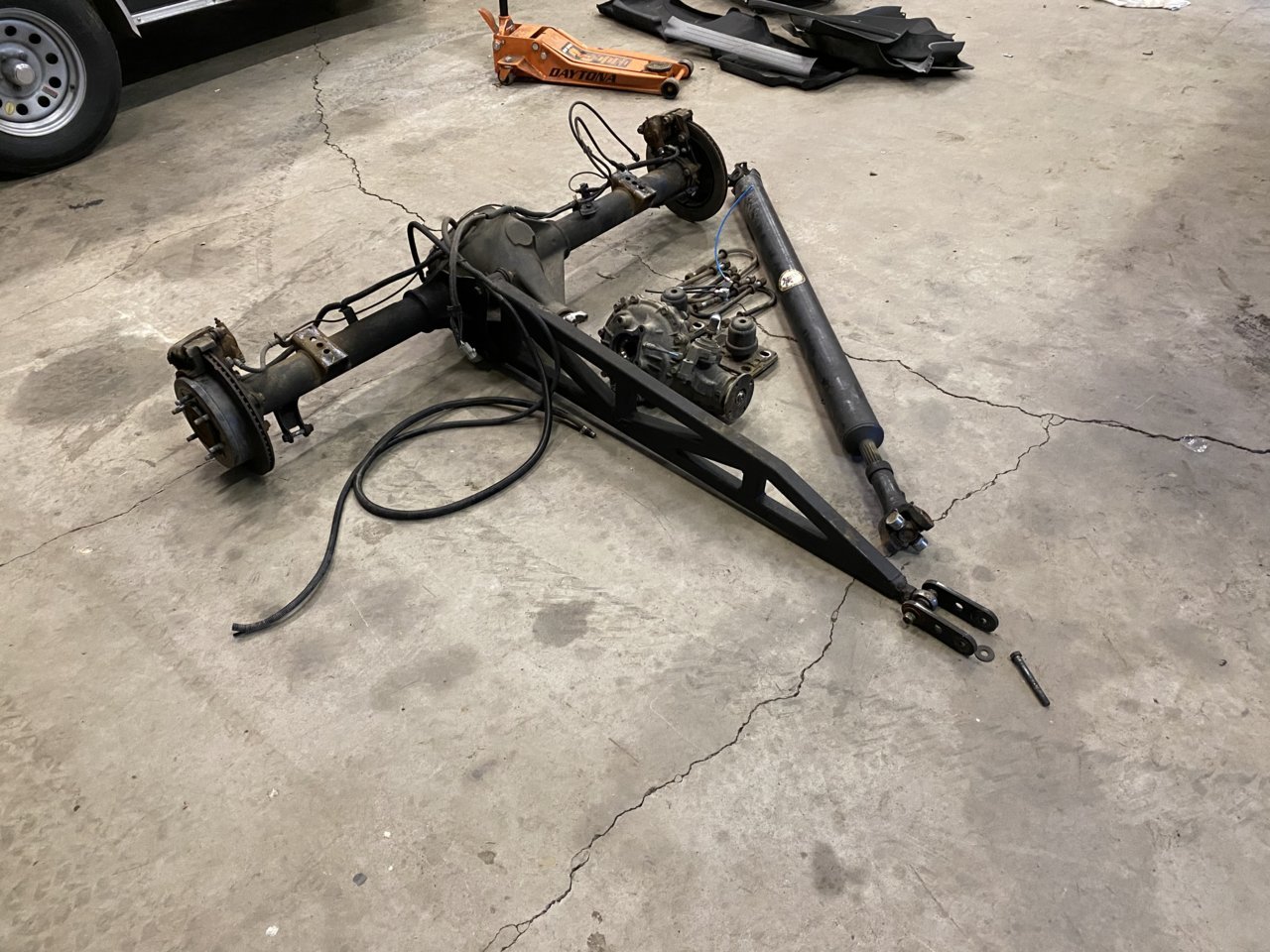

    A custom driveshaft isn’t going to help with axle wrap...
    It might help get rid of some drive line vibes by going to a one piece and getting rid of the center bearing.
    I didn’t care about axle wrap when I got the traction bar. I wanted it to protect my expensive one piece driveshaft when rock crawling.
    But, it helped enough with axle wrap to put all of the power and torque from the Supercharger and 35s (at the time) into the rear diff, breaking it twice...
    That’s why I did the Dana 60.
    As far as traction bars go, I would not use one of those ones where the brackets bolt to the third member bolts. Mine is custom and the brackets are welded the the axle housing.
    This is the 60, but I had the same traction bar on the factory rear.
    Good luck with it.

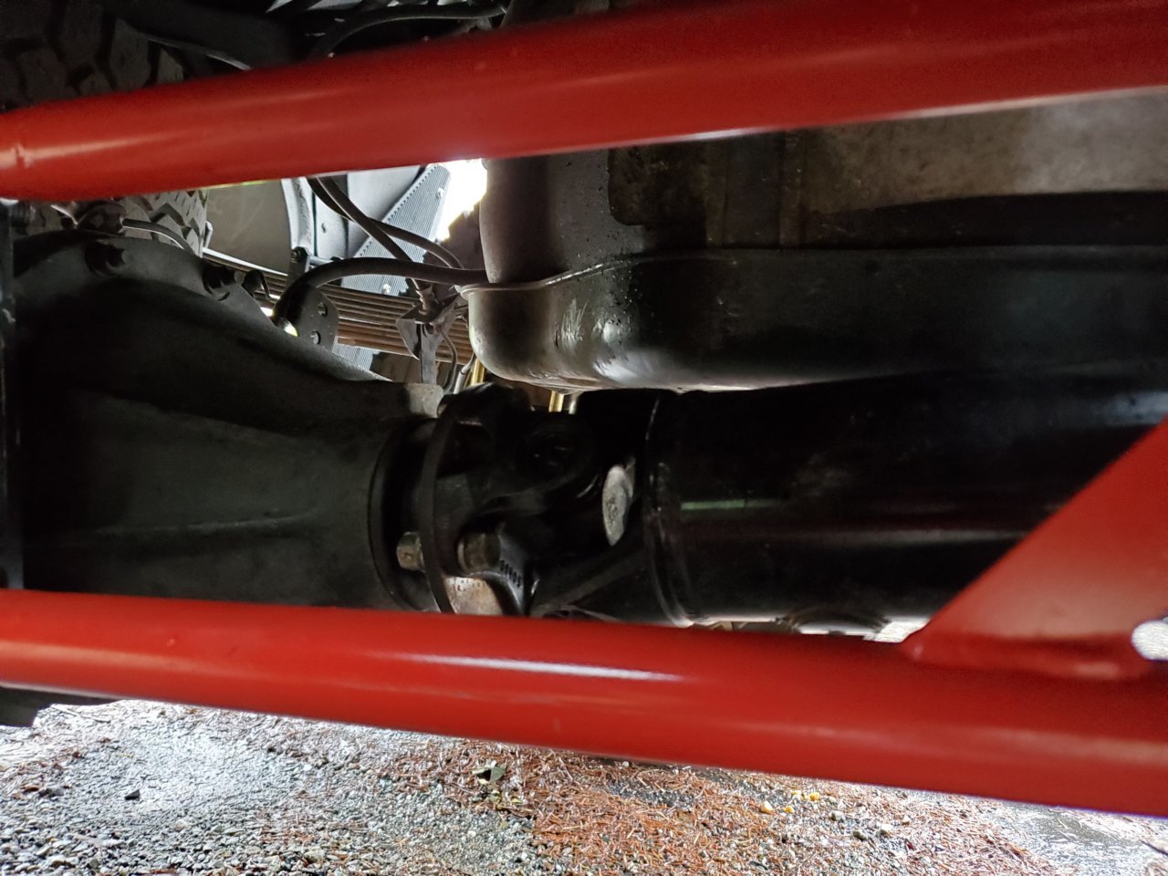

    i have a 6" lift and mid travel. horrid wrap. i bought a weld in version. budbuilt makes a nice one. 20191231_121047.jpg wrap solved. still have vibes, ill buy a 1 pc driveline when i can.

    Holy - that's a torque arm, not a traction bar. Just so you know.

    Traction bar is bolted to either the axle tube or the spring perch, is free floating in the front, and is just long enough that it hits the front of the spring pack during axle wrap. What's in that pic is a very long arm bolted to the center section with a mounting point far forward. It's a torque arm in every other segment of the auto community. But I get that things get named and that's just how it is.

    I think that's really a torque arm. Very similar to what Mazda calls a 'power plant frame' on a Miata.
    Traction bars are like
    @HolyHandGrenade you are a much better builder / fabricator that I even dream of being. I'm not tossing this out to be argumentative, just to help @icky crane be sure he gets his terms straight, in case he walks into a shop asking about such things.

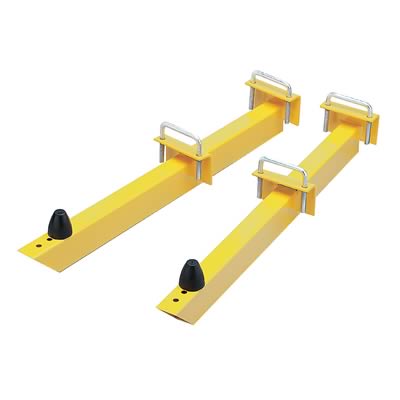

    i appreciate the polite education. these yellow stability bars would be great for 2wd. having 1 control point near center allows for axle articulation to my best understanding.
