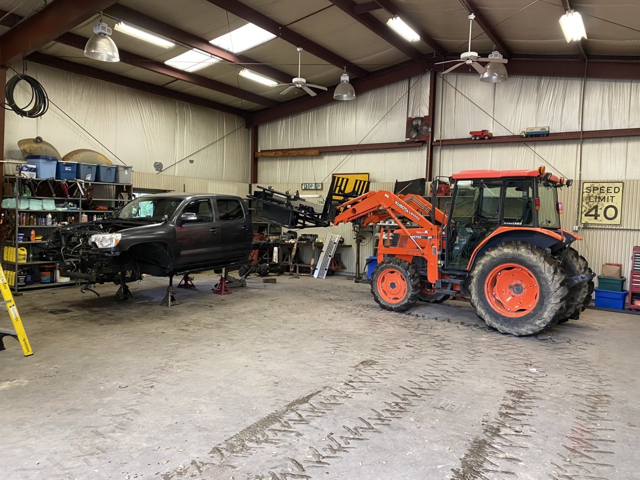

    lol! I’m leaving now.
    And since we are talking proper terminology... Setup that I HAD. I’m parting the truck out as we speak.
    It’s getting serious in here...
