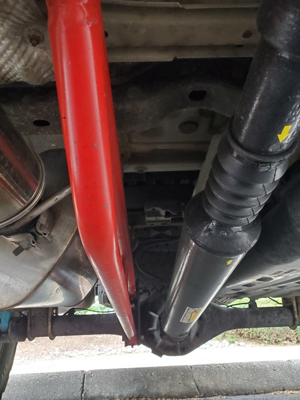

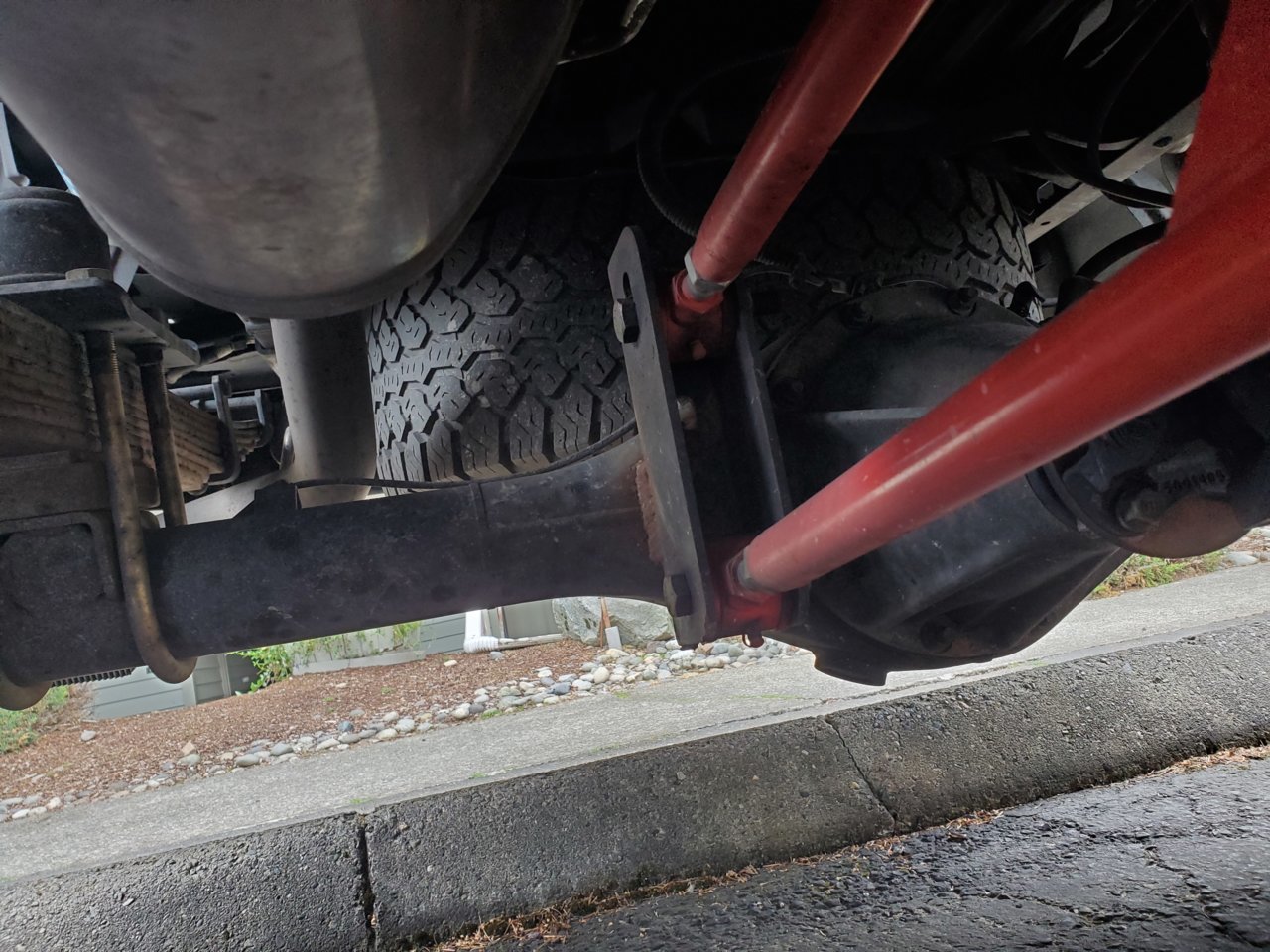

    So why did you have someone weld it to the pumpkin instead of the tube? Pics of that part??

    gimme a minute for a pic. it needs to be as close to the center as possible. per instructions and design.

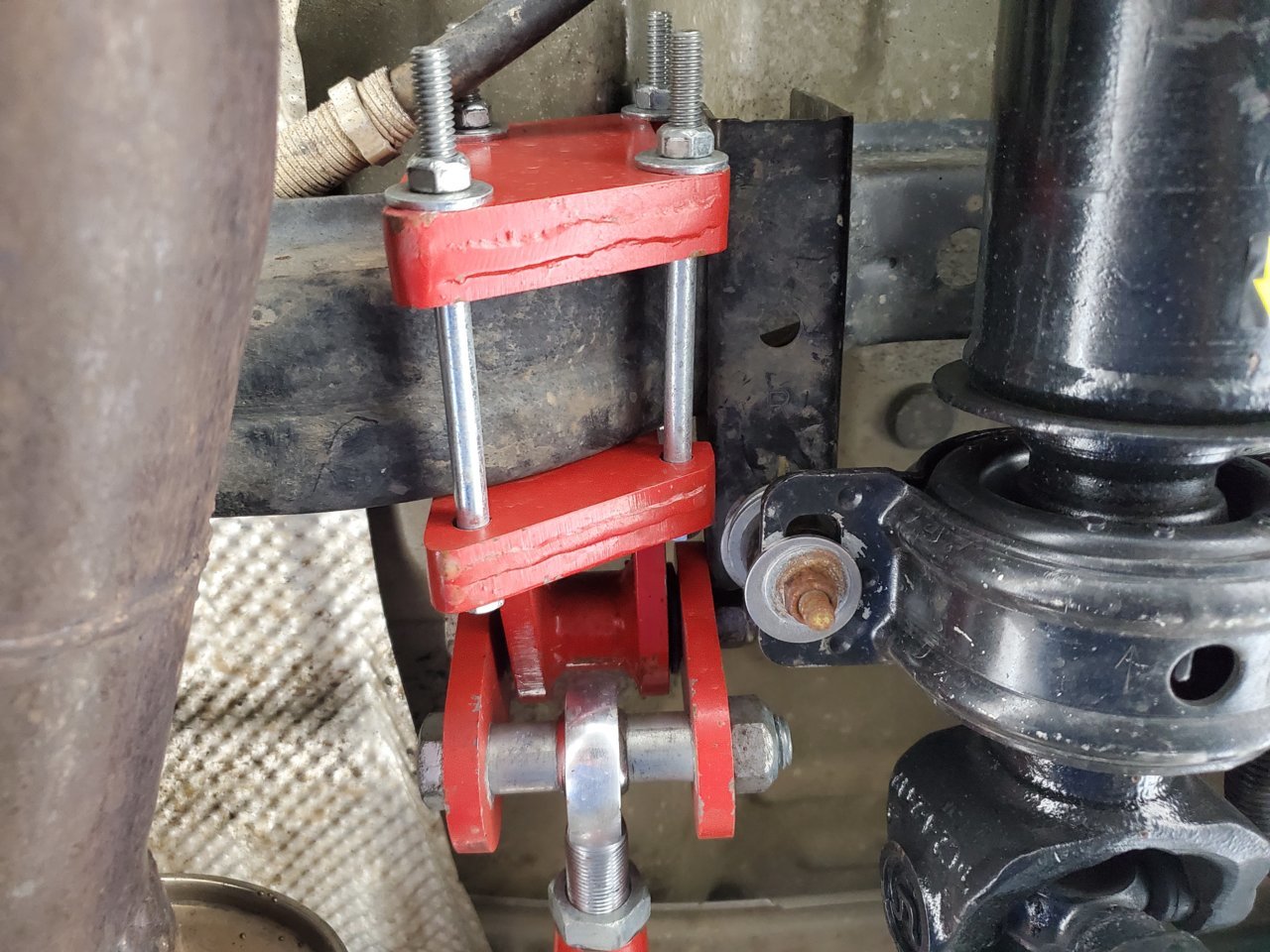

    I don't see how this works great for a truck. I'm no expert but preloading a leaf spring is really a poor way or controlling wrap. I'm sure it works but its like having death wobble and adding more stabilizers. Sure it may work and add mass to the steering but probably still an underlying problem that needs to be resolved.
    Look at the geometry. When you accelerate that big swinging shackle on the left pushes against the leaf spring to physically stop the axle from rotating up. So when you jab the breaks it does nothing to help. Its like a fancy way of putting those crap ladder bars on.
    This is from Off Road Design but its a common design that works very well for trucks especially off road.
    The bar has plenty of poly bushings so you eliminate vibes but is rigid to the axle so as soon as it wants to rotate up or down it deflects again the frame by using the swinging shackle. This way when the axles moves around off road the shackle and spherical bearings allow it to rotate around a bunch but still keep the pinion from rotating up or down.
    This one is made from Tuff Country. I'm sure it control axle wrap but only on the principle of binding the shit out of the leaf spring. So when the axle goes to twist it pulls on the bar which is connected to the frame. Great...but it only has one point of attachment on the axle so the bottom of the axle still wants to move around. It also will push or pull the axle during the droop and stuff of the axle within the wheel well. That doesn't work because the front half of the spring is also connected to the frame. How are they supposed to travel in the same arch? Its like trying to take a leaf spring and add controls like a link suspension without going to a full link suspension. Can't really do it with this arrangement.

    What center are you talking about? I would design it exactly like @Slum Lord explained above. Sorry, not familiar with bud build’s weld on variant. Only seen the bolt on which is hilariously stupid. They should be slapped for that!

    Keep thinking about it. You'll get there on the CalTracs. It prevents the axle from twisting. While with the heim joint ends allowing it to articulate up and down in its natural motion.
    The straight bars do not. They are fixed on both ends. From a center line, if the axle goes in the down direction, it will pull it in a circular motion towards the front mount. Closer to the front mount. Same in the up. Always fighting itself. Those are no good because the suspension is always in a bind when it travels.

    i do have a camera. you are correct, the crossbar will flex. i have a reinforcement idea. this is way better than things were. again, im no pro here by any means. just here to be helpful. heres some pics. 20200429_145816.jpg 20200429_145832.jpg 20200429_145839.jpg

    That’s not welded to the pumpkin, it’s on the axle housing like I thought.

    ahh yes. i thank my hombre @JimSnell for that bomber weld.

    Why not also weld the front shackle hanger? And then triangulate the cross member to the main frame rail. That ought to prevent flex

    great call. i liked the idea of a brace from the front. another mod when i can get the help for it.

    I’d put the brace on the back. Start as close as possible to the shackle

    close to the shackle yes. cant recall what side had more room for mounting logistics.
