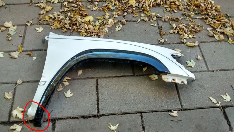

    I took this reference pic before starting, but for some reason, can't find pictures of them on my truck
    The curvature of the flares is similar to the curvature of the wheel arches on tacos, but it will stil require a bit of trimming
    The holes on the inner lip of the fenders and the flares don't line up, so you need to drill holes. And of course you'll have to dril holes in your fenders for the body clips on the flares
    The part of the flares that curves down and goes after the wheels is too long, so you'll have to cut it off a bit (circled in red). I left it open at this end, as flares catch and keep mud and cause fenders to rust around the wheel arch. I remember the Pathfinders I got the flares from had completely rusted fenders because of mud and moisture that got trapped in. So if the flare has an open end, mud can get out
    To make it fit snuggly against the fender (if it doesn't), heat it and press/mold it into place. Then between the edges of the flare and fender, you can put silicon (don't remeber if I used the original litle piece of trim/silicon/rubber seal thing)
    I only put flares on the front, so I don't know about the rear ones. If the front ones did fit with a bit of trimming, I guess the rear ones can fit too
