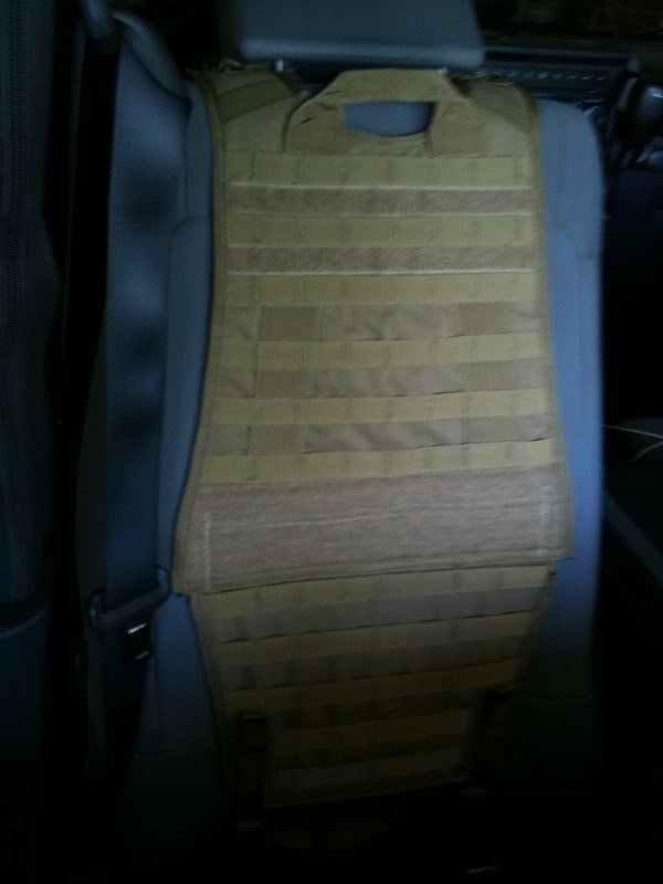

    Your idea about seat back organizers are great....my friend just suggested these Smitybilt Tactical Seat Covers.

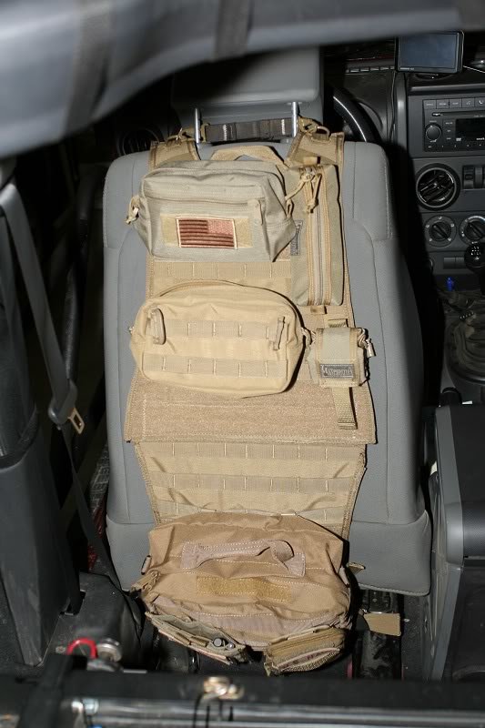

    In response to the comments about the MOLLE seat covers...after some thread hopping I discovered this guys thread:http://www.jkowners.com/forum/write-up-dept-library/33062-home-brew-molle-seat-cover.html
    Basically he took a $20 airsoft MOLLE vest and chopped it up, did a little sewing and strapped it on. Very creative and elegant solution IMHO. Much better looking and WAY more affordable than the Smittbuilt or Coverking alternatives. Some finished pics of his work:

    I was actually thinking about mounting some sort of organizer system on the box behind the seats, not on the seats themselves. It would make it easier to access when you flip the seats forward.
    If you want to mount them to the seat you could always buy some panels made for the Tacomas. http://www.blueridgeoverlandgear.com/MOLLE-Seat-Back-Panel-14-x22-p/21msb14.htm.
    http://www.blueridgeoverlandgear.com/MOLLE-Seat-Back-Panel-18-x22-p/21msb20.htm
    The guys from Blue Ridge have a Tacoma that as their main vehicle so they should be able to give yo usome info. They have some other cool products as well.

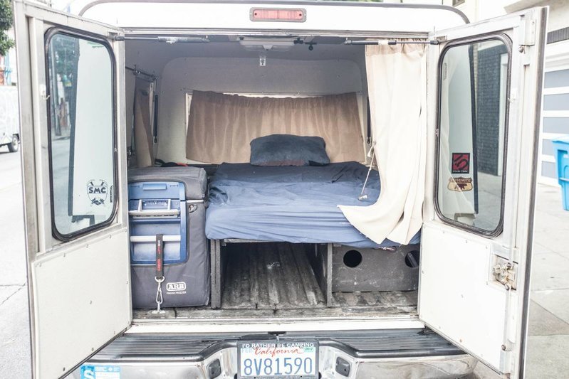

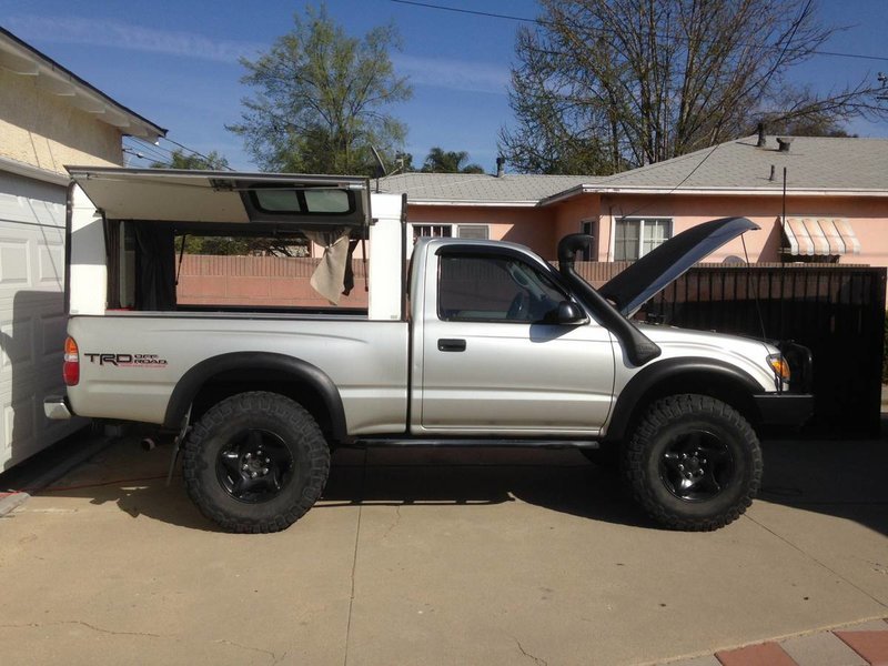

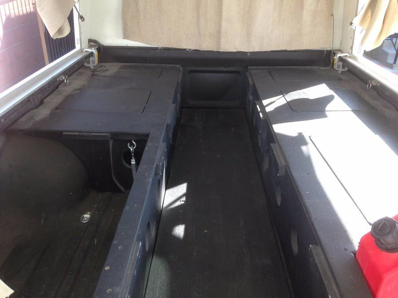

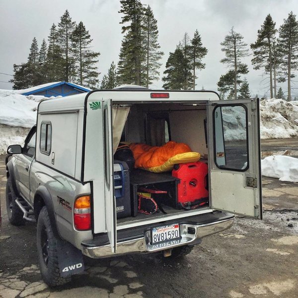

    not sure if this is helpful for ideas. Not mine
