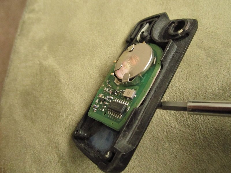

    Heres how it look without the board. You can see the epoxy. Also a small cut out on the right, cause the board wouldn't fit.
    Here it is with the board intact you can see how it lays on the cutout.

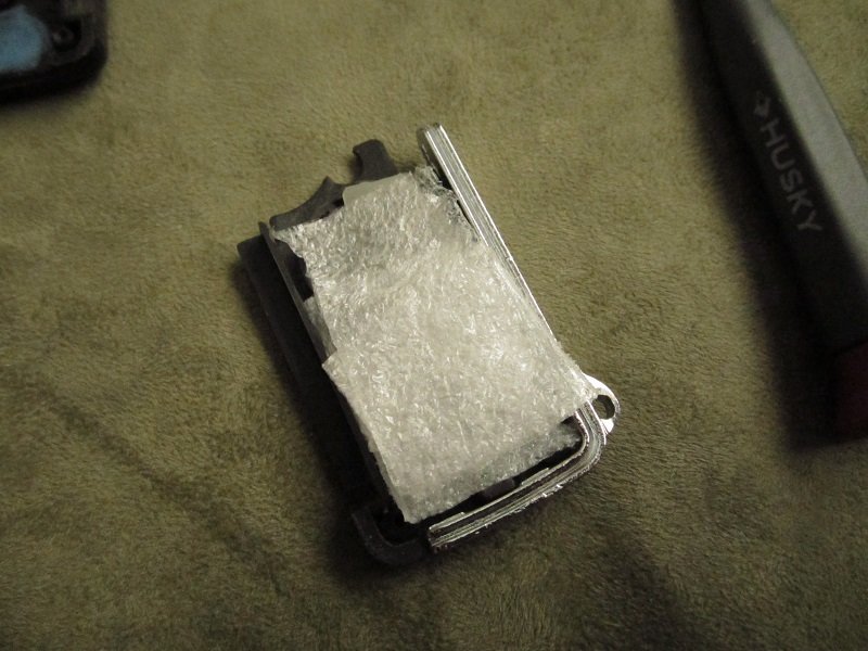

    Once you have all that done just use some packaging foam on the back piece. Use as needed to push the board all the way to the front.
