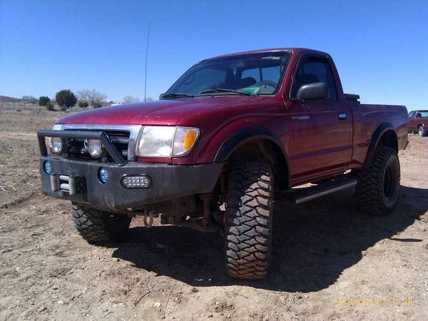

    yeah I have a winch in the bumper. All the metal used was around my house, got bored one weekend and made a bumper. :yay:
    I used 1/4" where the winch was going. Haven't weighed the bumper but I imagine its quite a bit.

    I have some ideas to fab one up after work slows down this summer. The only thing I was wondering was what did you do with your turn signals?

    I have LED turn signals I also hooked up the parking lights, which are also LED, to the turn signal so it looks like this with my parking lights on...
    Turn signals are the lights in the bumper.
