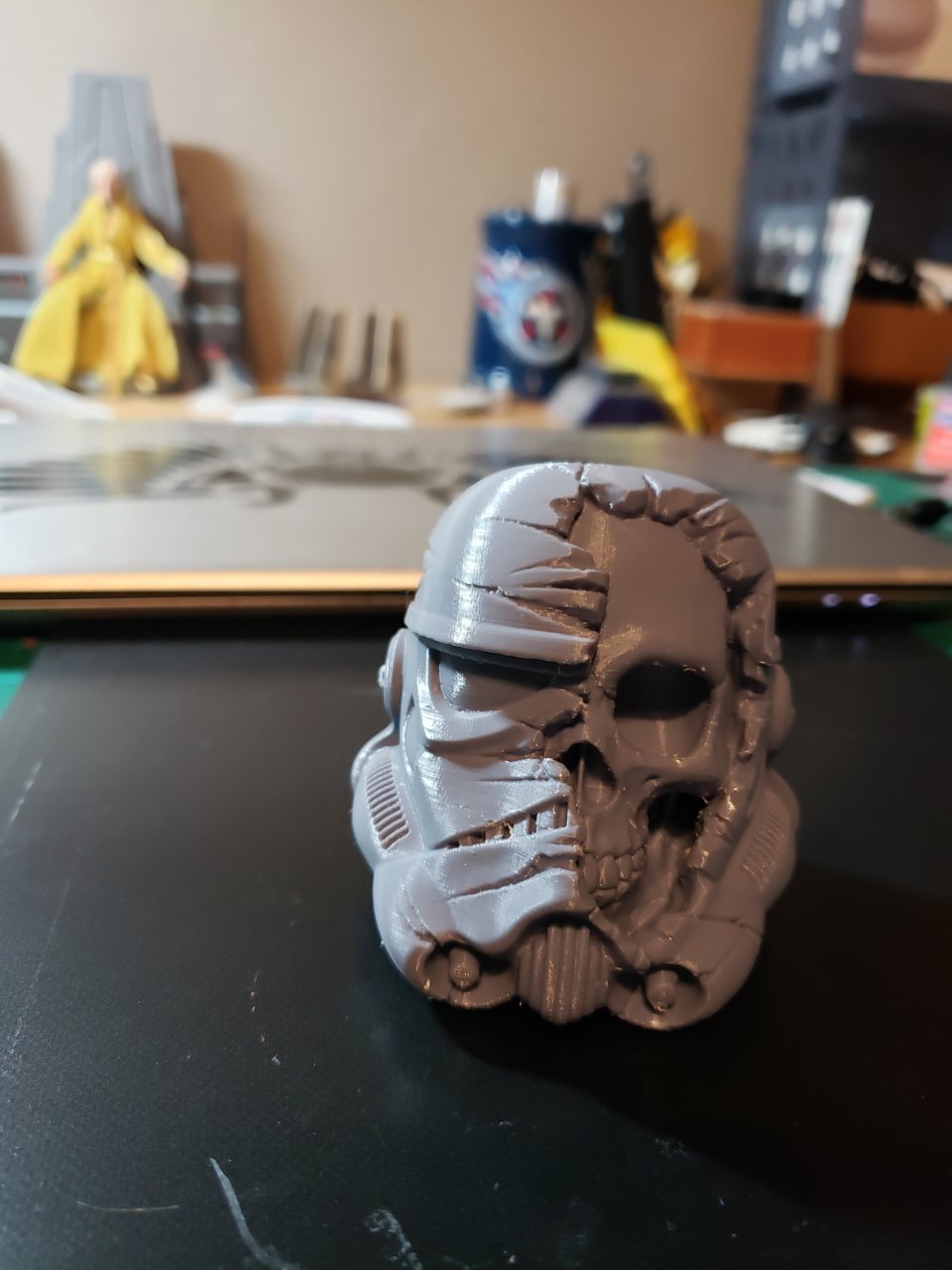

    I am wanting to make a custom gear shift knob....I 3D printed something, and just trying to figure out the best way to attach it. Do you just screw it on?...does it need a hilt so to speak?...i don't want it to sit too low. I do have a spare knob coming, so if I need to cut one up, i have that option.
    Truck is an automatic

    Its an Auto
    Thanks...my Taco is a "stormtrooper" edition, i made custom bedside decals as well....thought this would be the perfect addition. I still need to apply resin, sand and paint.
