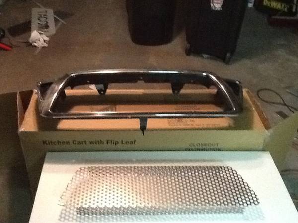

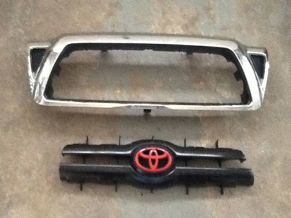

    Decided to make a grill rather than buying one. Bought perforated sheet metal with 1/2 inch holes staggered as the background instead of mesh. The outside 1 1/2 is made out of .080 inch thick aluminum free from a friend.

    Dboz the lettering is just the size and spacing I figured out and it is cut into some junk sheet metal I had laying around. I ordered perforated metal that just arrived today that I will use as the black mesh area.

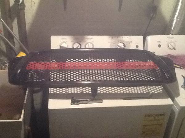

    Where'd you order that perforated metal from. Looks good

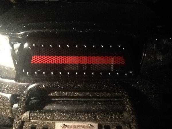

    I am a volunteer not sure why saving lives while risking my own for free makes me a TOOL....?

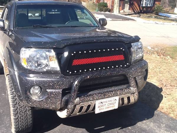

    Looks good man, now either wash your truck or dirty it so the grill matches :D

    ONLINE METALS that's 16ga with 1/2 inch holes. you could go smaller i went big just so i didn't restrict air flow

    Looks good

    ya i know the grill was in when i went to work and got it muddy but i cleaned it up when i took it off to install the outer ring and bolts. dont want to wash the truck until the clear has a few days to cure
