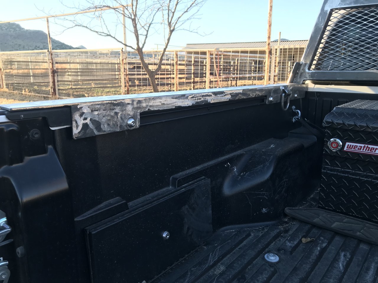

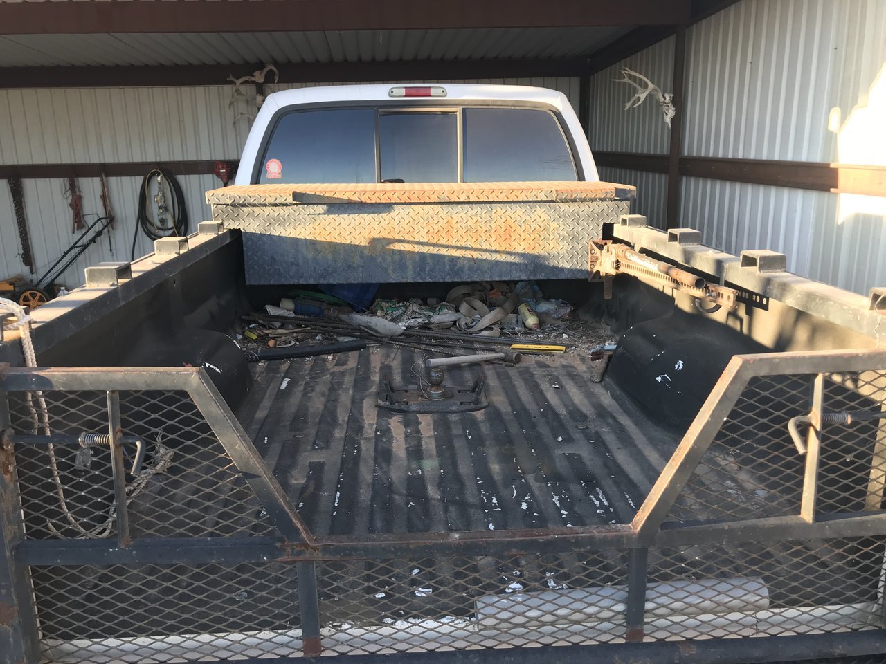

    I got my first Tacoma this summer and found TW pretty quickly. I have learned much on here and really appreciate all the insights. In that spirit, I thought I’d share this project in case someone can get something out of it.

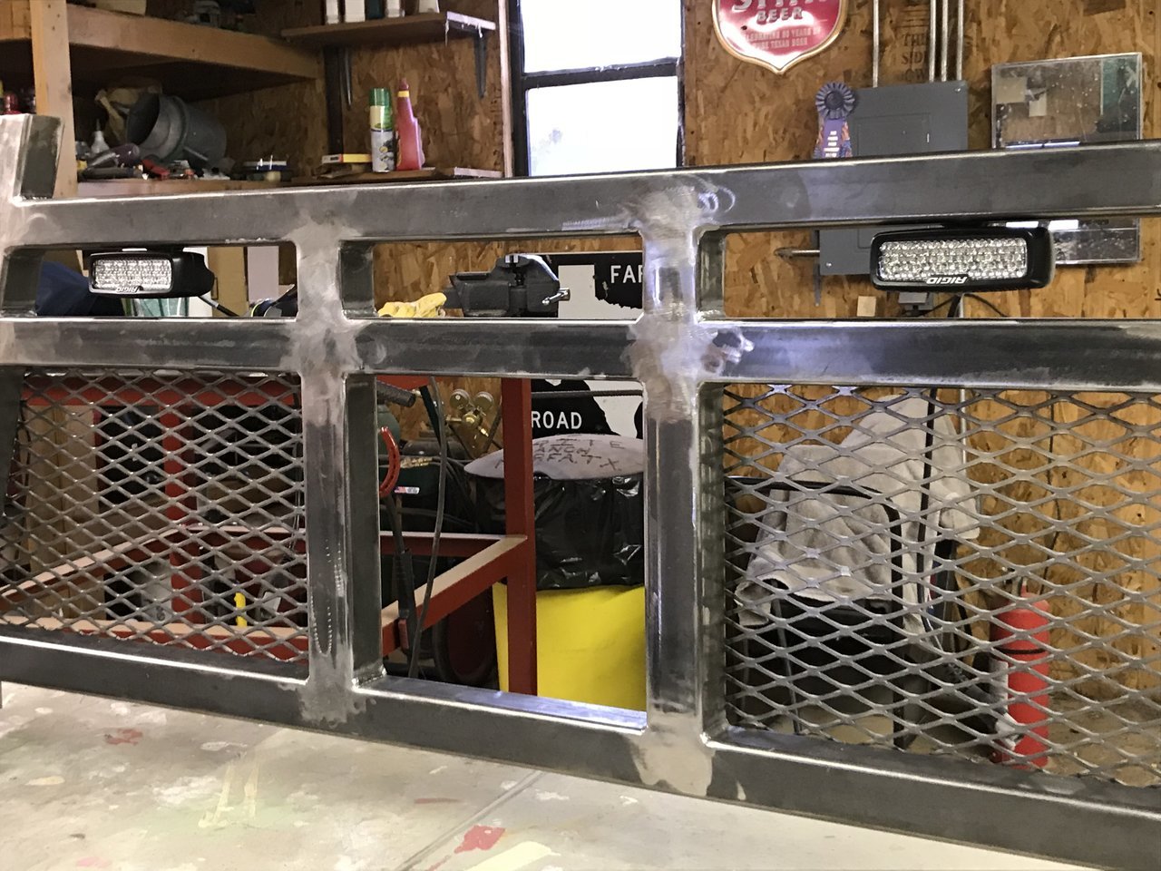

    I am mounting it with t-slot nuts, 3 on each side. I cut a section out of the bed rails to use the factory tie-downs. I put d-rings on the front in case those factory ones in the side of the bed don’t hold up. I welded brackets to mount some flood lights in the top section.
    I do have a question for the board. Pretty much every headache rack I’ve ever seen has a cross brace across the top of the bed. But, a lot of friends trucks with racks end up wth splits in the sheet metal on the beds. These are 3/4 and 1 ton trucks. Do you think it would be bad to leave it off? I wonder if not having one would allow the bed to flex a little more and prevent damage. On the other hand, it will put more stress on the welds at the base of the rack. On the picture below you can see where i removed the factory cross bar and would add an angle iron cross piece potentially. Thoughts?
    I am going to pant it black when I have time, along with AtTheHelm’s bedside reinforcements (which are really great quality, by the way).

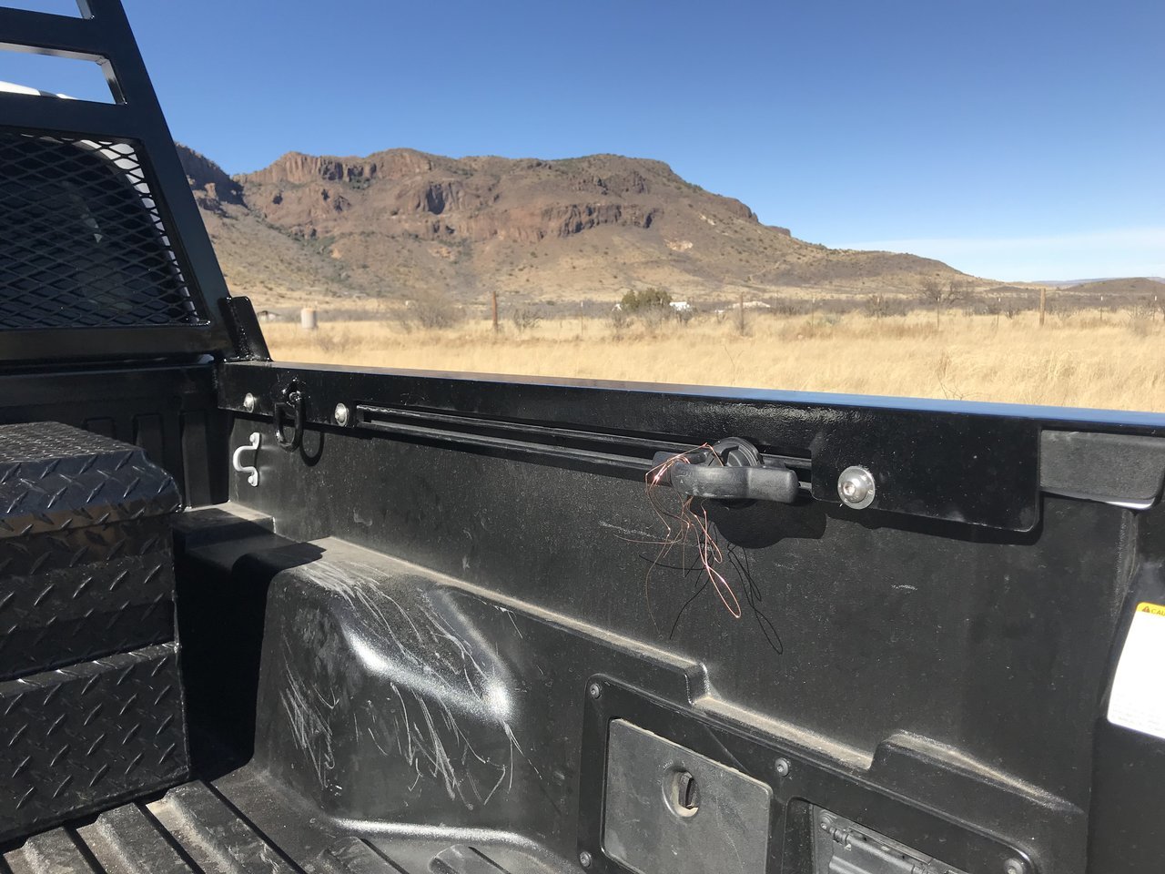

    I had one other question for the board. I am wiring some work floods on the rack. Have any of you wired back to the bed? Can you get into the back of the cab and run the wires inside or do you have to run along the frame and come up in the bay?

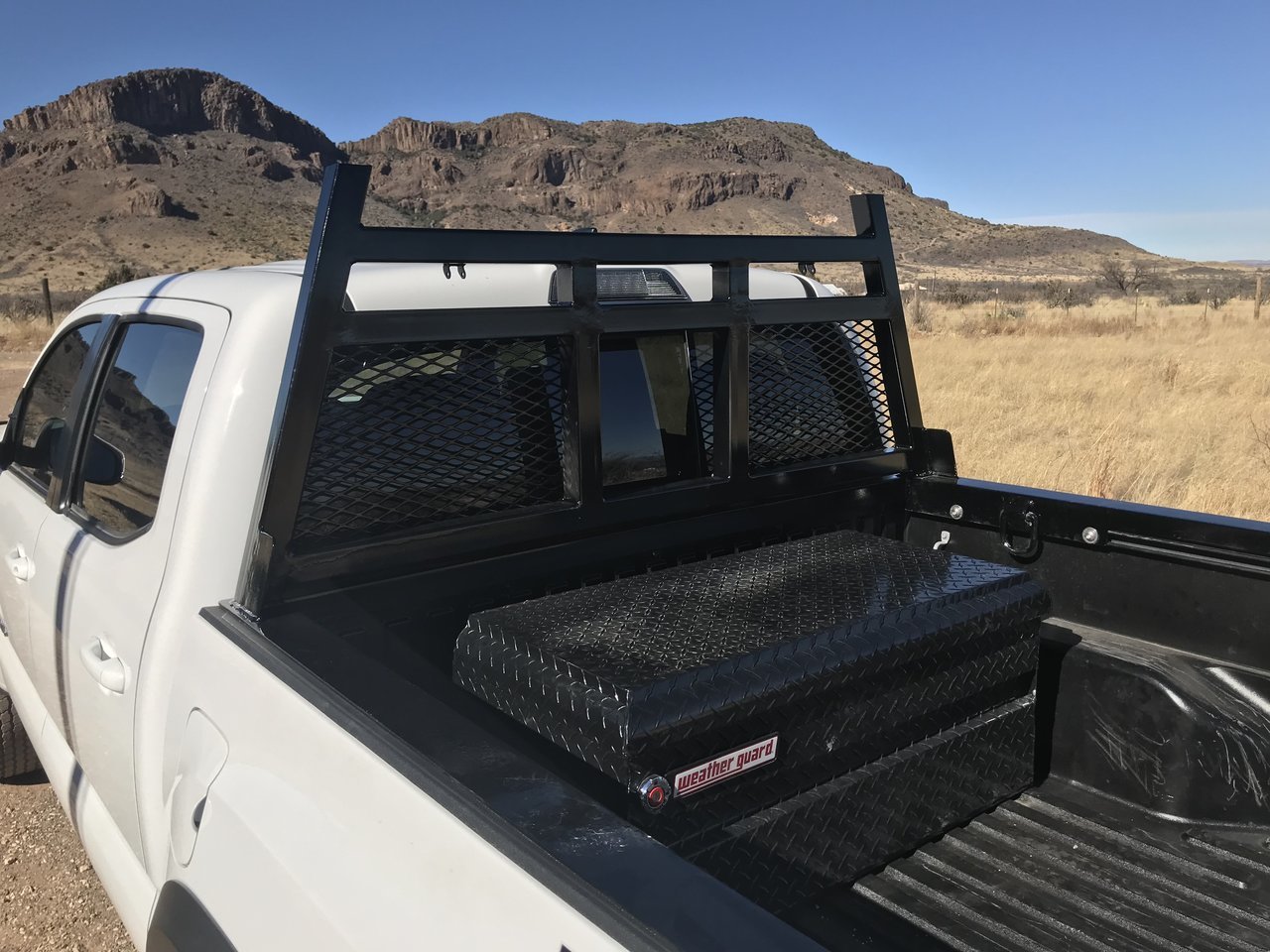

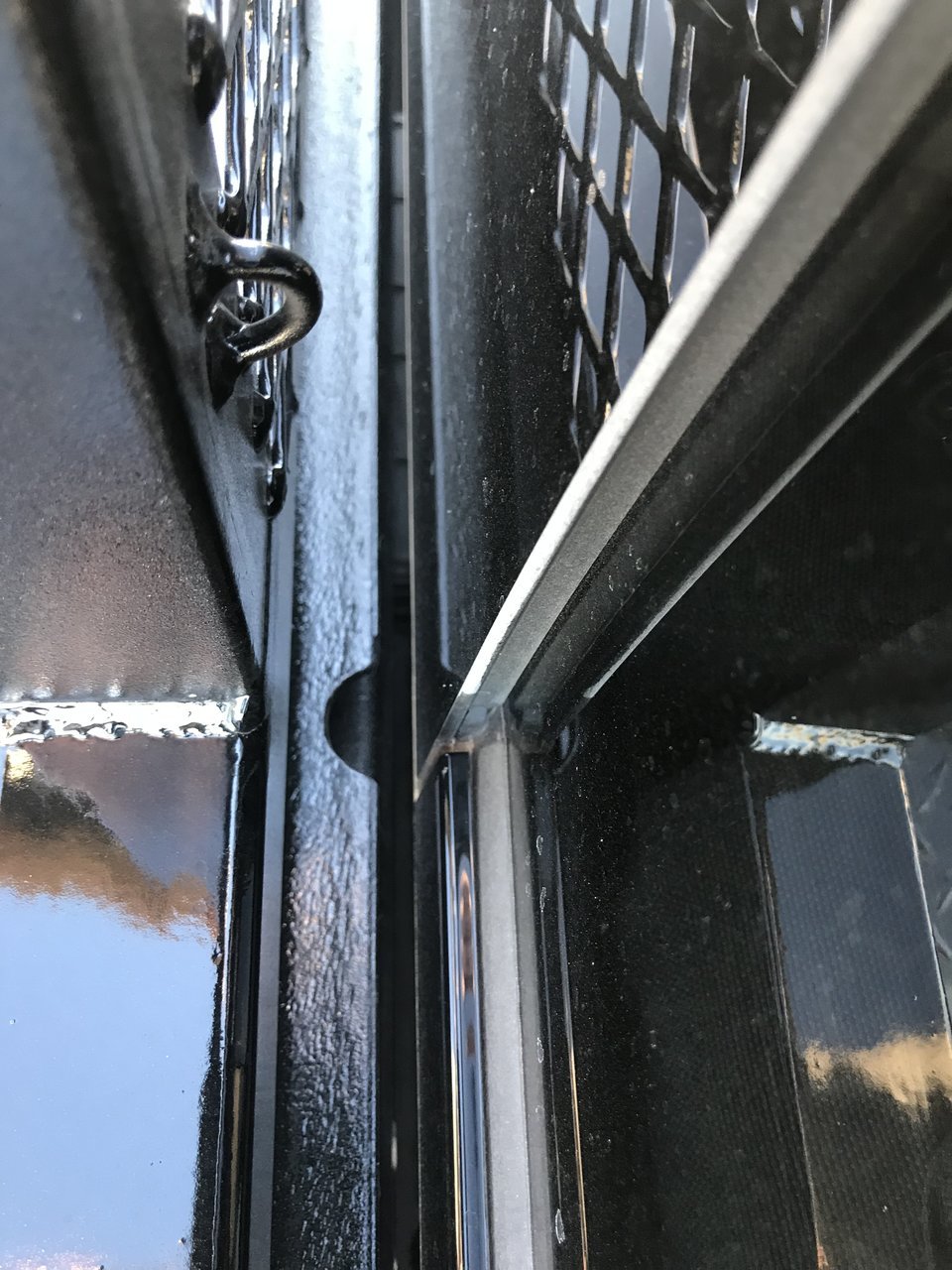

    Here is the final project painted.
    I cut a section of the bed rails up to still use a factory tie-down and added a d- ring to cinch things resting on the rack:
    Here are the rear flood lights mounted on the rack:
    It’s 2” square tubing and 3/16ths angle. I used the galvanized t-nuts to mount.

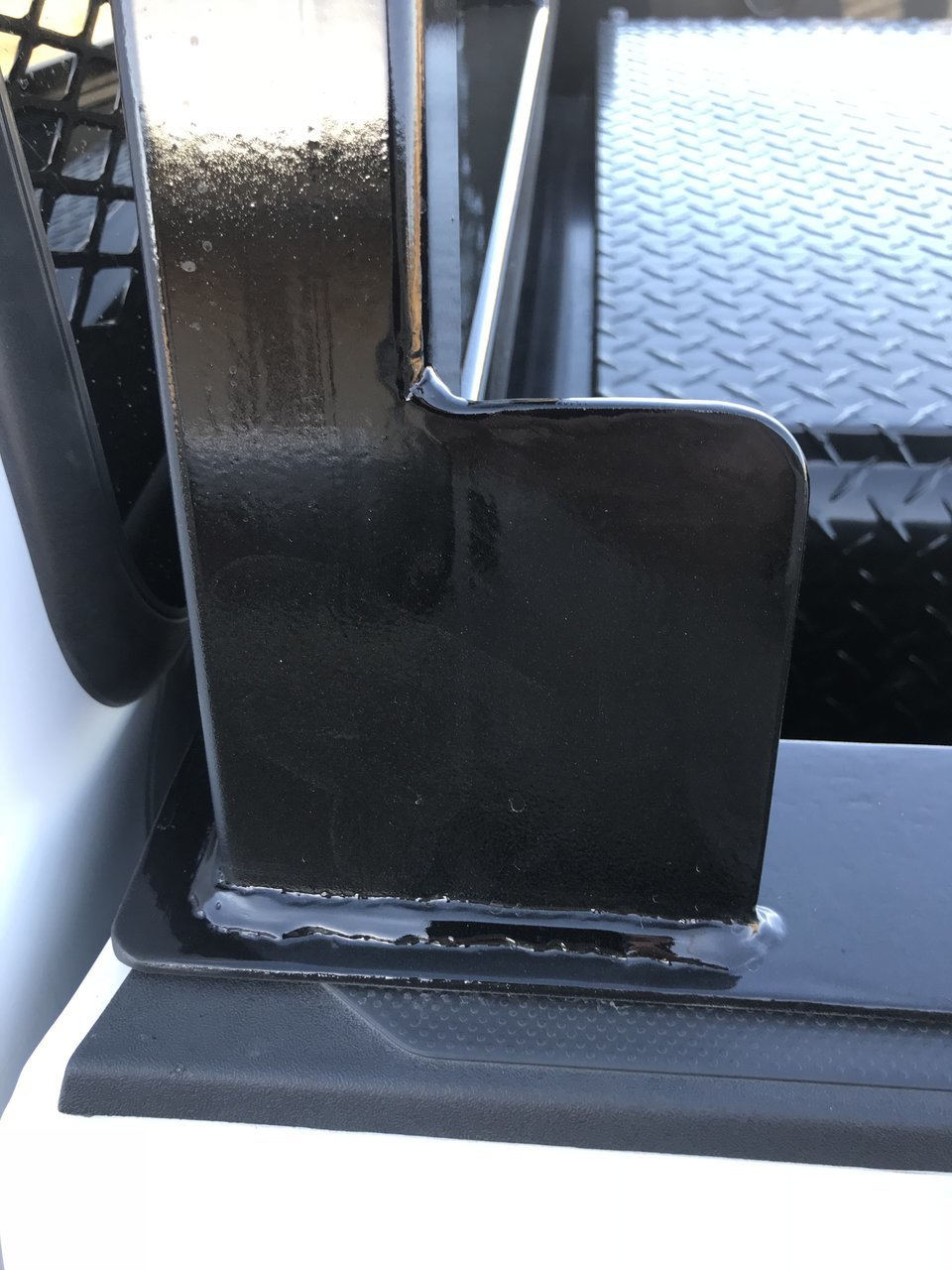

    Gussets are critical! There are many ways to do them. I did it with plate:
    If you plan on wiring lights, make accommodations for them in your design. I don’t like zip ties to be showing so I tacked some chain links on the back to run the wires and cut some spots to drop the wires:

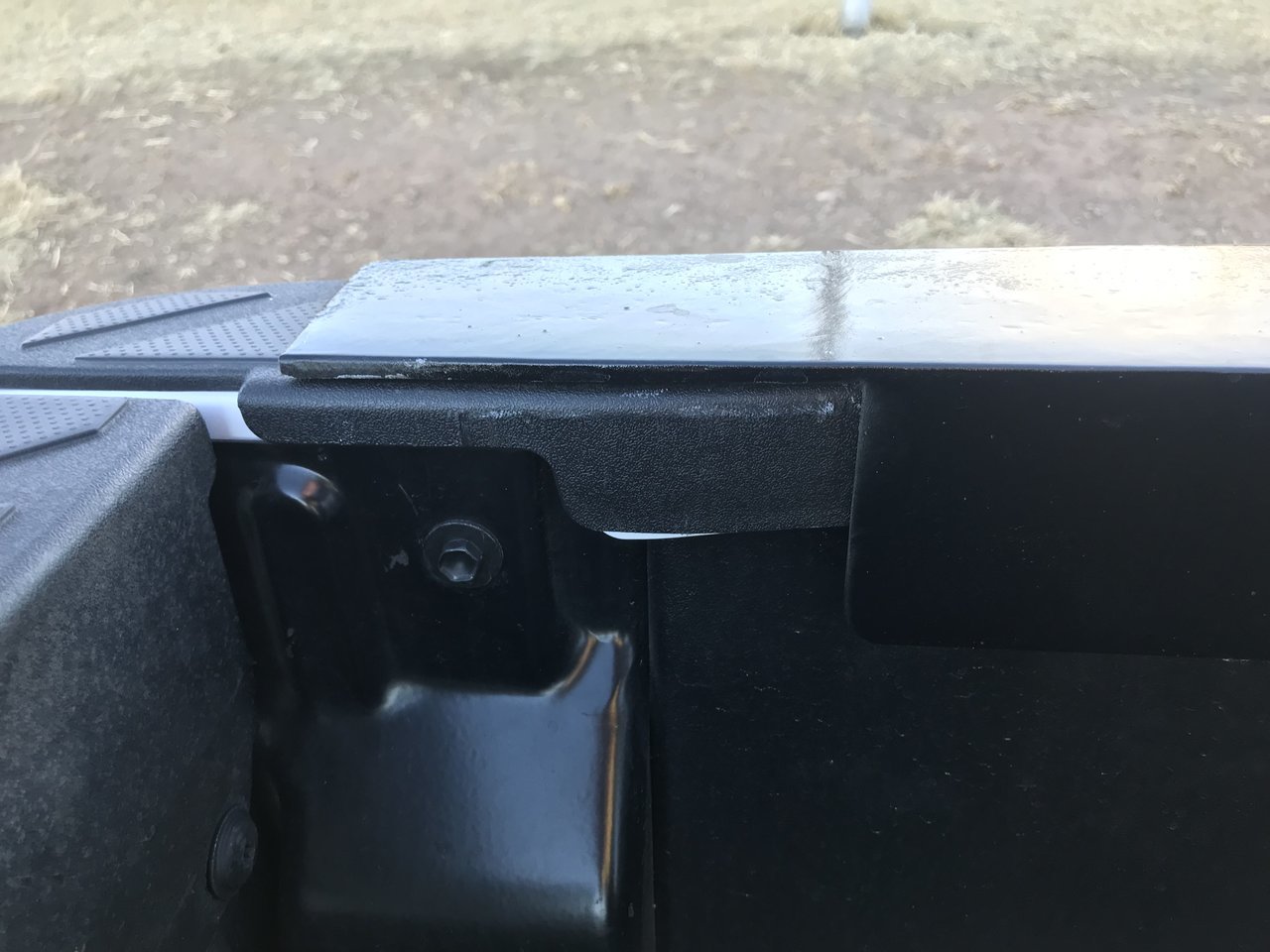

    If you do full length bed rails, you will have to accommodate where the bed pinches in at the end on the vertical part. I just cut half the angle iron out to make it fit. I also cut a slight taper on the horizontal part on top to fit with narrowing bed cap:
