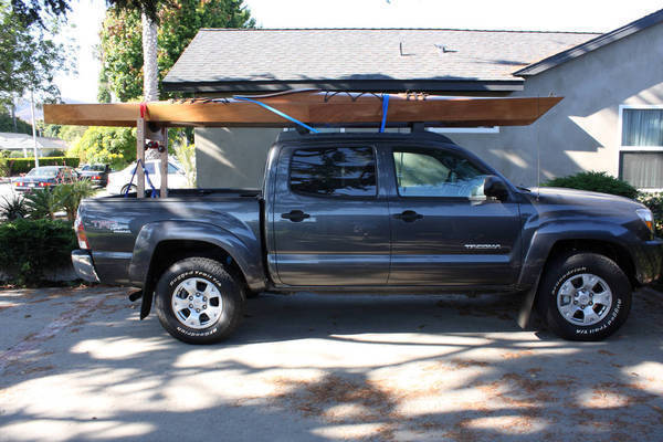

    This is from my old truck and i will be building something like this for my taco... what i learned (the hard way) is not to use screws or bolts or as few as possible. I once made a rack that had screws and bolts, which split the wood and broke screws when i hit a rough road. The one pictured here is simply 3 2x10's that are notched out to fit together and held in place securely when the canoe is strapped to it. No bolts or screws, takes up no space when not being used, super simple to put in place, IMO the only way it could be better is if it was metal but i dont have a welder. Its also sad that my new taco has no stake pockets, so ill probly have to bolt my new one to the track system.
    Just remember to keep it simple. Some peoples builds on here are way overcomplicated
