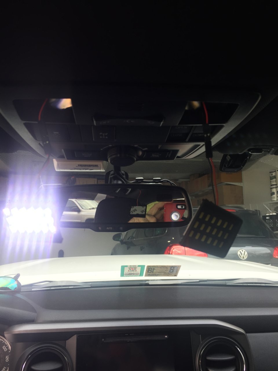

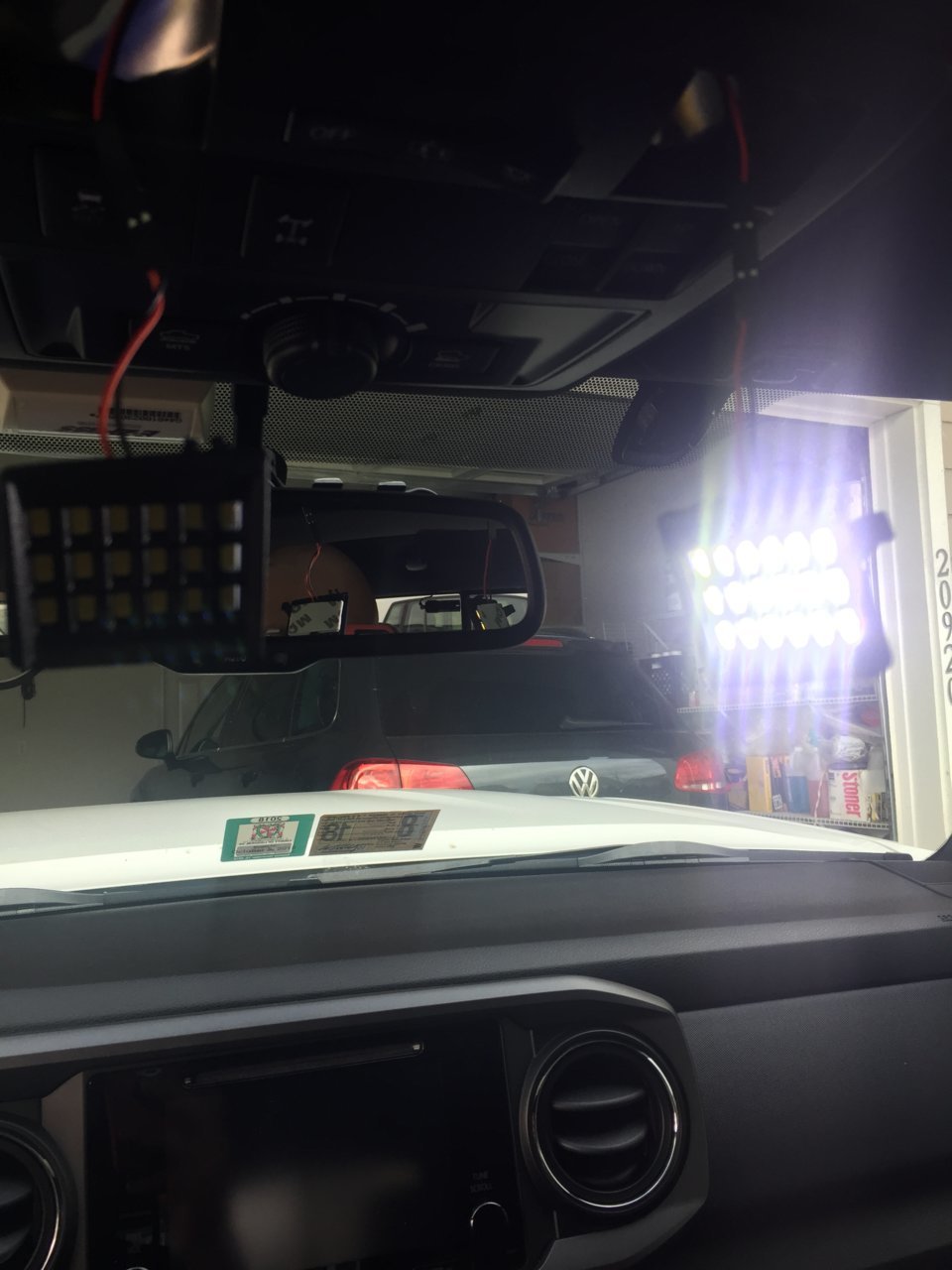

    Been doing that with no luck....

    Look up in the hole. There is a black button. Have you tried clicking it?

    Yes I took a small pick and pushed it several times it’s working just like the other side.

    Did you make sure the connector wire is on the correct side, and it is correctly pushed into the housing? If it is off the white part or flipped on the wrong side it wont work.

    That was the first thing I checked was polarity of the wires ....

    What about taking the one that works off and trying it in the side that doesnt work. Yes it won't mount, BUT it would trouble shoot that it may be the LED board, not your truck.

    Did that too and it stayed on as well.....

    after pulling down the overhead console it seemed as if it was not seating correctly pulled the adapter and made sure all wires were inserted,tight and straight plugged back in and all seems normal at the moment.....One thing I did notice is that I have to push the passenger side light a lot harder to activate the little pin switch for the light to come on.

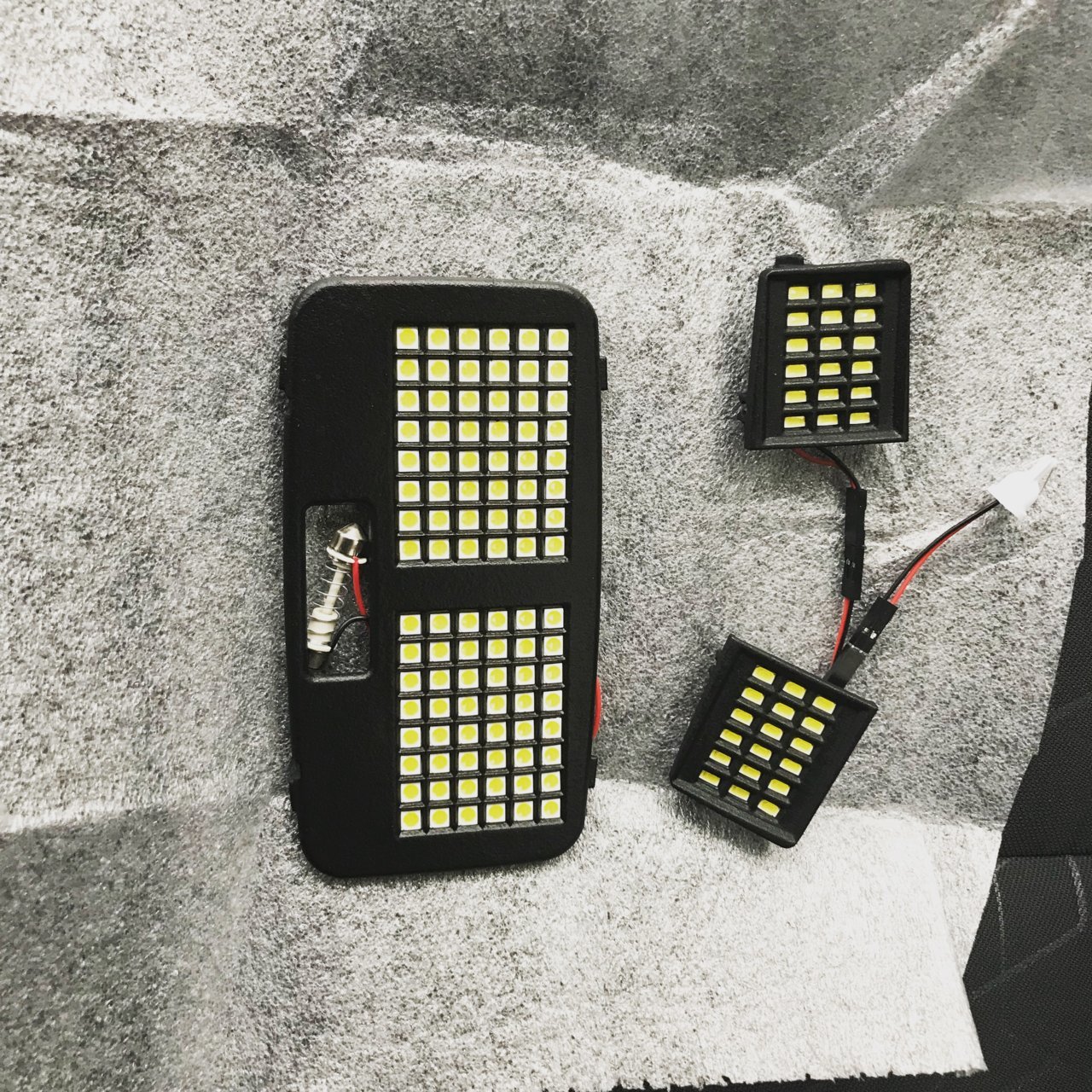

    7017C8D0-7066-42C2-A88E-411D8F8F262D.jpg Got mine thanks mesojdm
