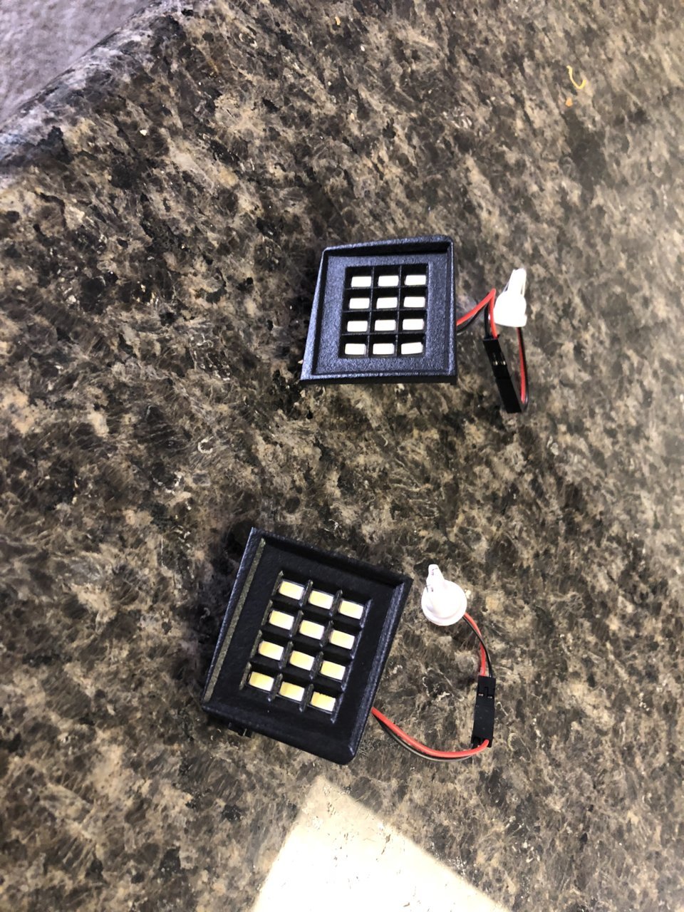

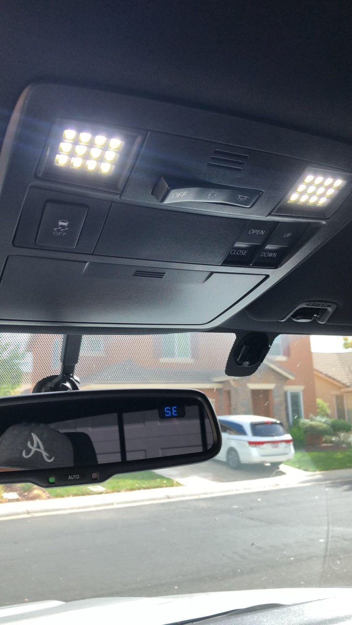

    Maps came and installed today! :thumbsup: Pair great with the dome. So much light! :amen:
    Now waiting for taillights :fingerscrossed::fingerscrossed:

    Super easy. I started by popping out the lens covers first. Then pull the whole top cluster out. Like most people say you might feel like you are going to break something but trust me you won’t. Once you have that off then twist the bulb housing out from the back and once those are out remove the actual bulb from the small black plastic housing. Then insert the meso white plug into the black bulb housing and reinstall. Test before putting back together if no light then just reverse the plug and test again. Took like 10 min max.

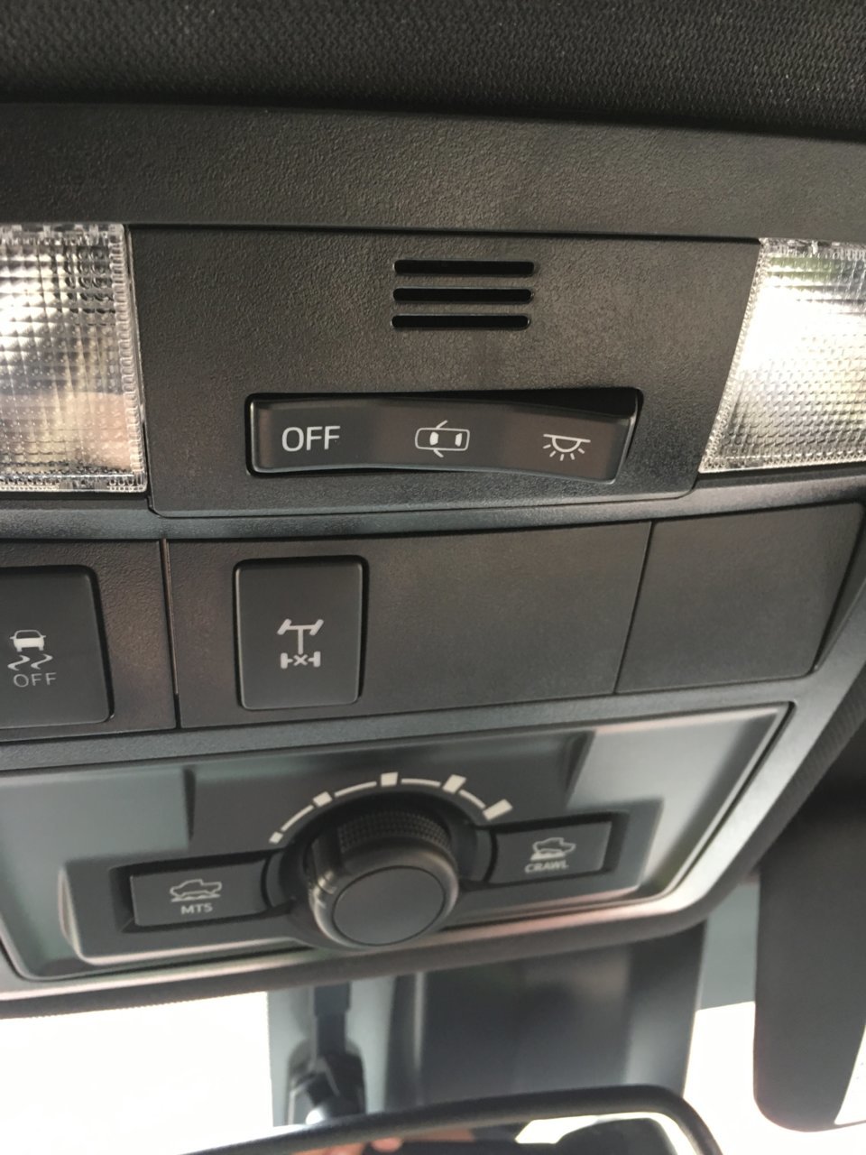

    So has anybody installed the map lights with this Panel? Not sure it just pops off but not sure why it wouldn’t, just don’t want to break sumpthin. Thanksupload_2018-10-2_14-31-16.jpg

    you have to pull the entire panel down. I started by the light, it snaps out.
