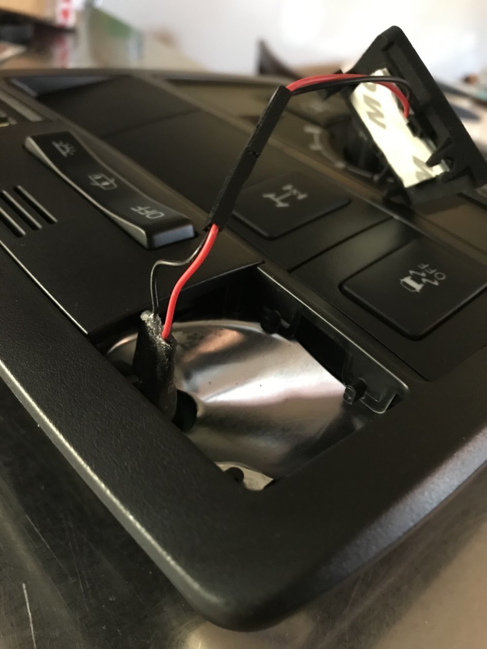

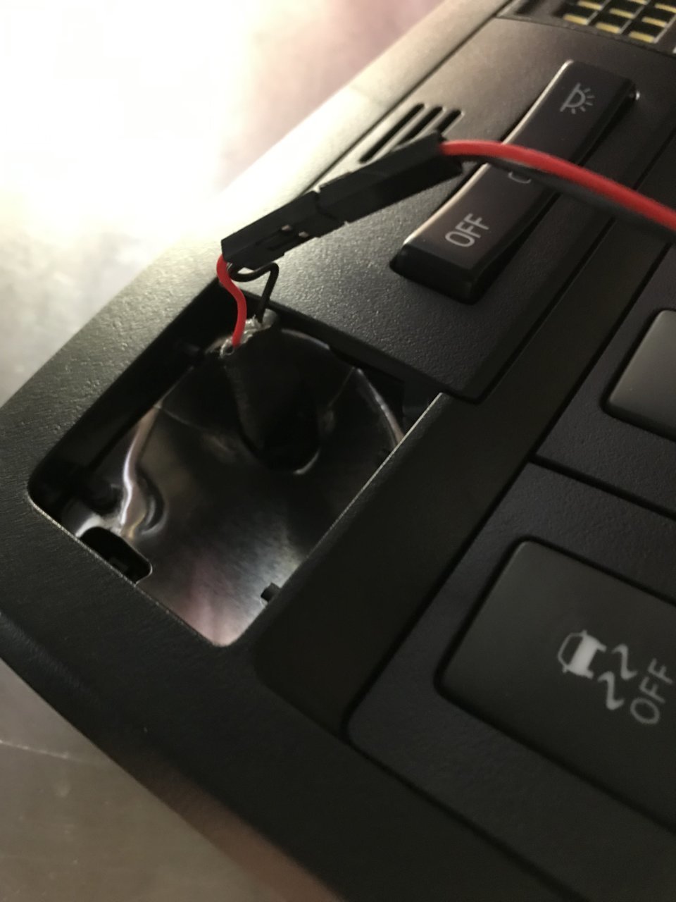

    Hi guys. I'm installing my meso maps and I ran into an issue.

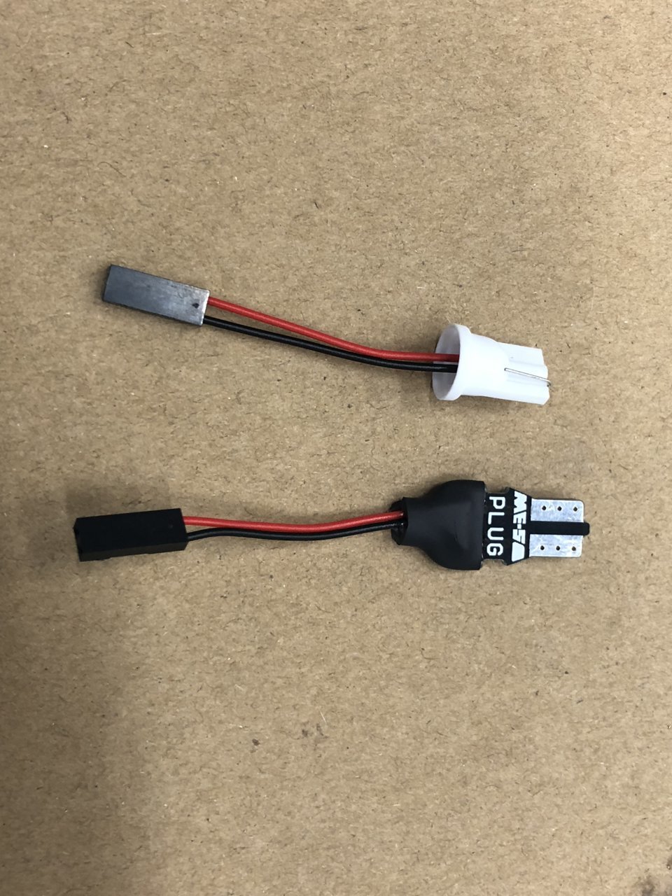

    I bought the red maps with the new style plug. I traded a member here for a white. That one has the old style plug. (The white connector) that one went in no problem.
    The red one with the flat connector doesn't seem to fit within the housing. With it plugged the map doesn't fit.

    Looks like you need to disconnect it at the black part feed the small wires through the hole and reconnect the small two prong connector
    Edit: I think he did this so you can replace/ upgrade to future maps without removing the whole console

    Interesting, wonder if the heat shrink is getting in the way. Looks like it's not all the way in. Mine barley fit as well, but they did fit.

    Its definitely pushed all the way.
    I can bend it slightly so it's kind of wedged in there. The map will fit but bending must loosen the connection because it won't turn on unless the connector is perfectly straight.

    I was the one that traded with Dryvah. It seems that the twist off base has two little protrusions of plastic at the bottom preventing the new flat connector from seating fully into it. I was able to squeeze all the wiring and connectors into the console. However the flat connector never seemed to securely sit inside of the base. After putting it all together, it does work but I wonder if it is just being held in place because there is no room for the connector to fall back out after the install.
    The map lights are beautifully made, this may just be a new wrinkle if the new twist off base of the Tacoma has a different manufacturing detail. If I take it back apart, I'll try to get a picture of the inside of the twist off base.

    So I recently switched over to a new bulb adapter. The old ones (white plastic tab with silver pins) sometimes would not make a good contact because the pins would get bent. So I designed a PCB rigid board just like some of the integrated LED lights. This fixed the connection issues but now I realized some of the heat shrink was a little too long(causing it to push against the map light). I have addressed the issue, so if you DO have a light that won’t sit flush, just PM me your order number and I’ll send you out a new bulb adapter. Try and fix one thing and it leads to another :annoyed: pretty soon I’ll have these dialed lol.
    PM me your order #, i’ll get you a new one sorry about that

    The first iteration of the pcb style didn't have heat shrink right? Or did they all?

    Ok great. And I love the lights I just can’t get them to fit because the adapter is so long. I love the adapter design it looks very neat and very nice. I will send you my order number for those. I ordered them in February.

    It’s not the wire that needs tucking it’s the adapter hitting the actual map light when it’s pressed in place
