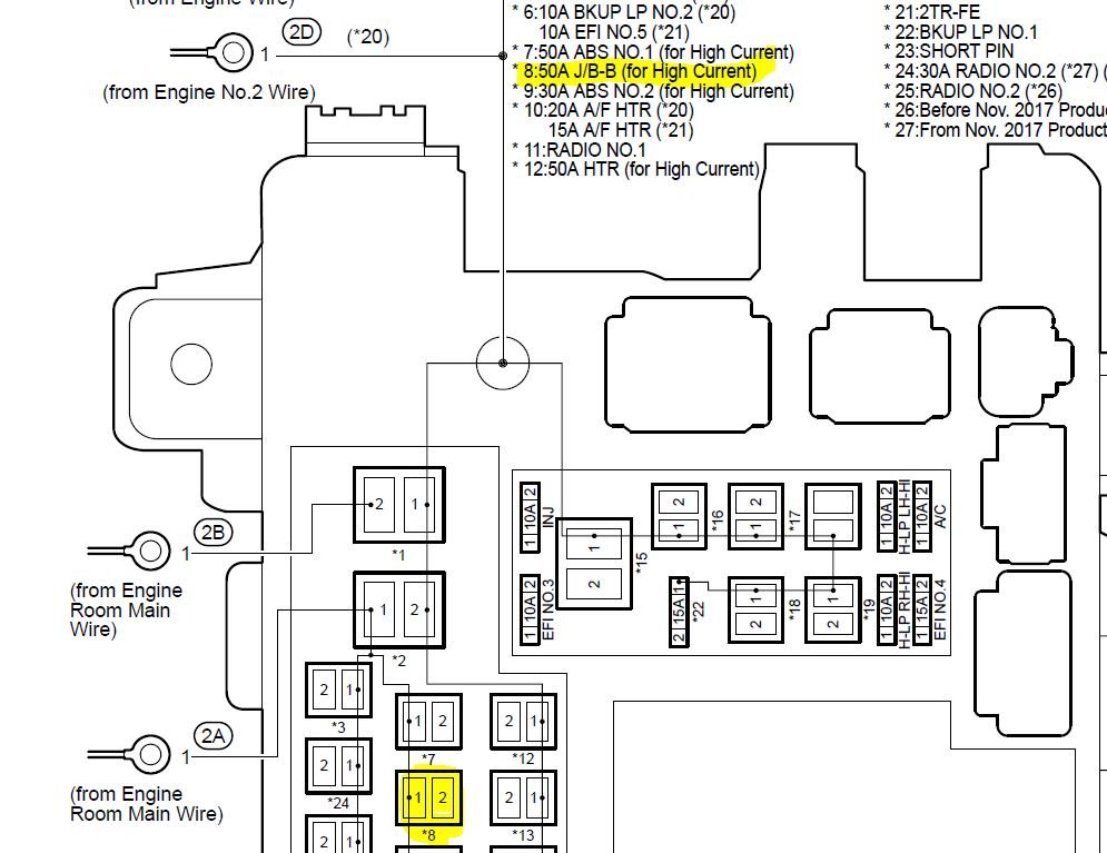

    You Checked this one? What is "none of your interior lights"? That Circuit only feeds the Ignition cylinder light, roof console box, center dome light, and the two lights in the passenger and driver side visors. Possibly the deck ligh/cargo light, but it's hard to tell from the drawings.

    yes, it is the one I highlighted in the picture I attached. 7.5A located under the steering wheel. It's a pain in the ass to get to and you have to basically lay on the drivers side floor to see it. Bring a flashlight with you. That is literally the only thing between the battery and your dome light. Make sure your On/off/door switch isn't set to off.

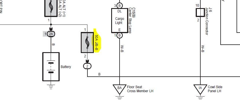

    Literally the only other thing is this fuse, but I would be amazed if it blew before the 7.5A fuse.
